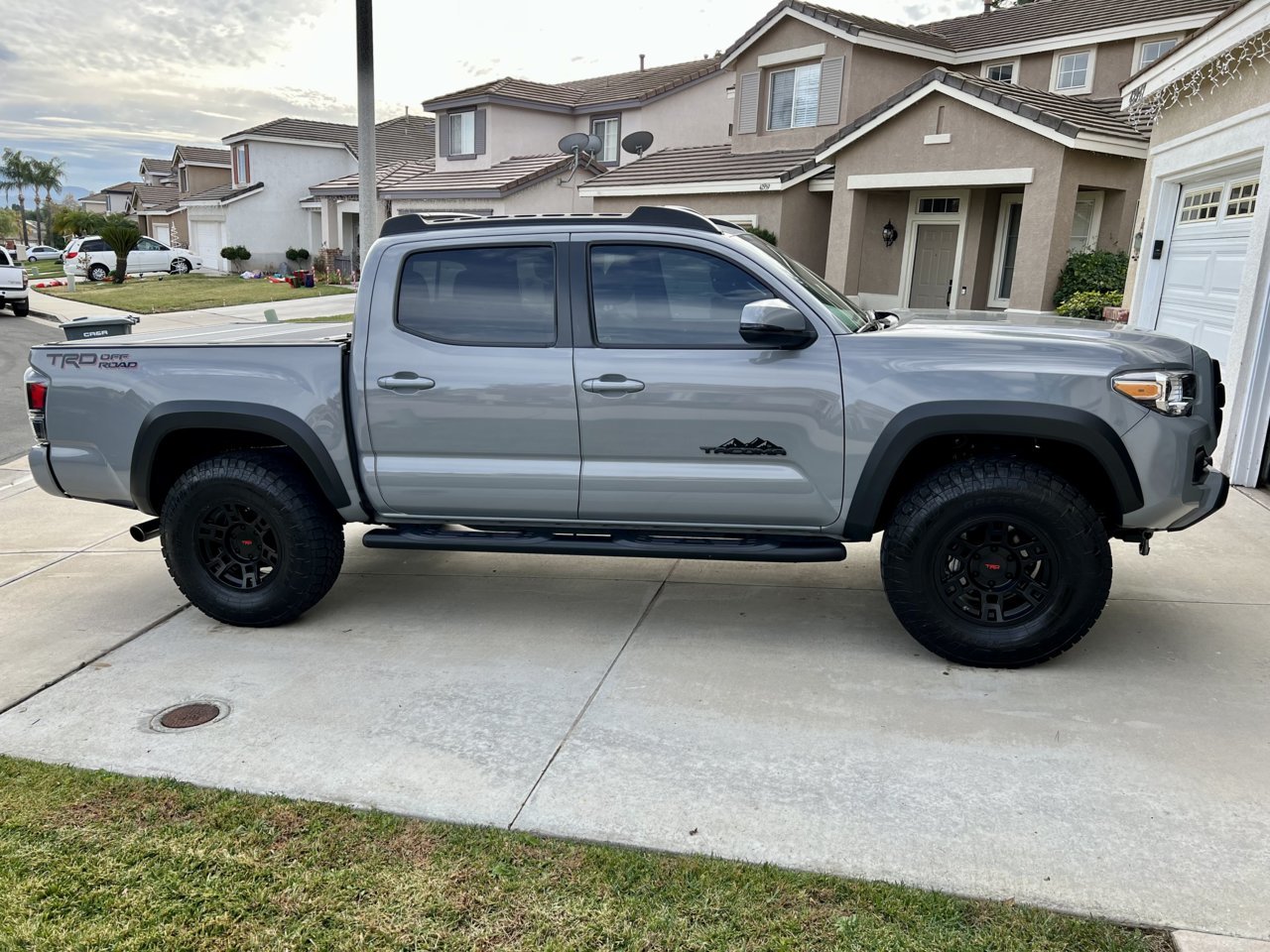

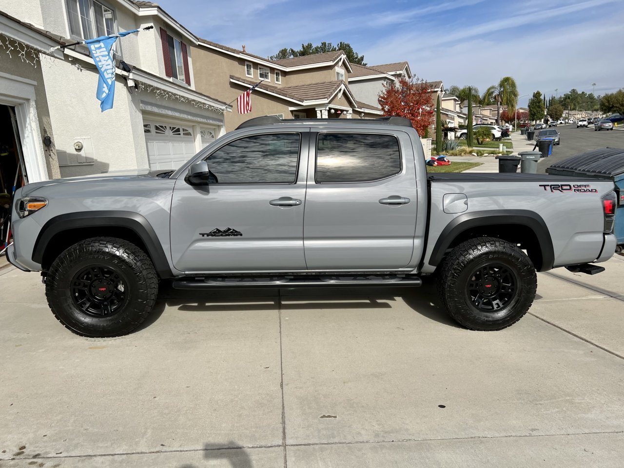

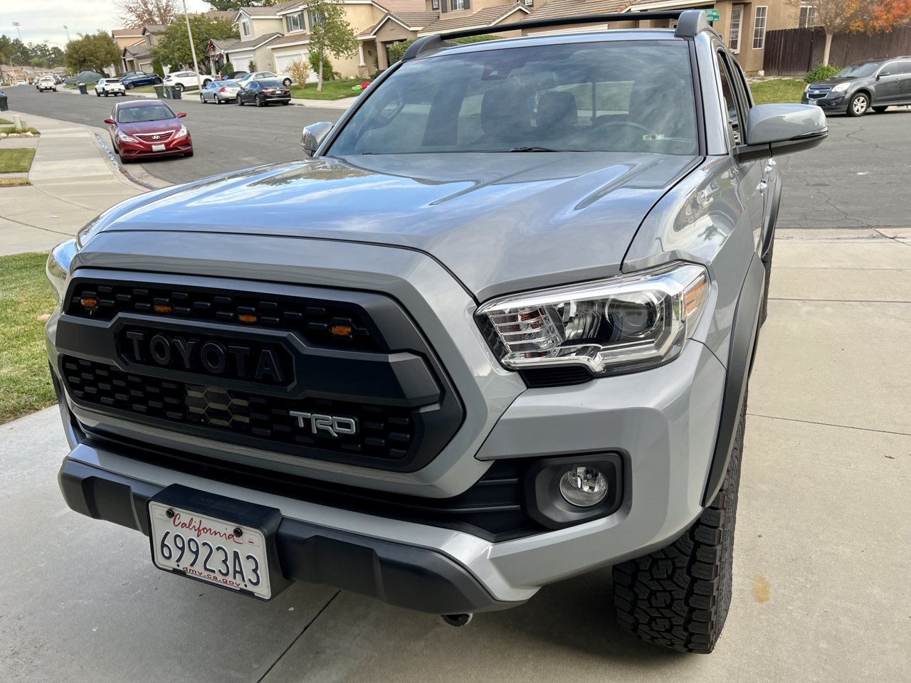

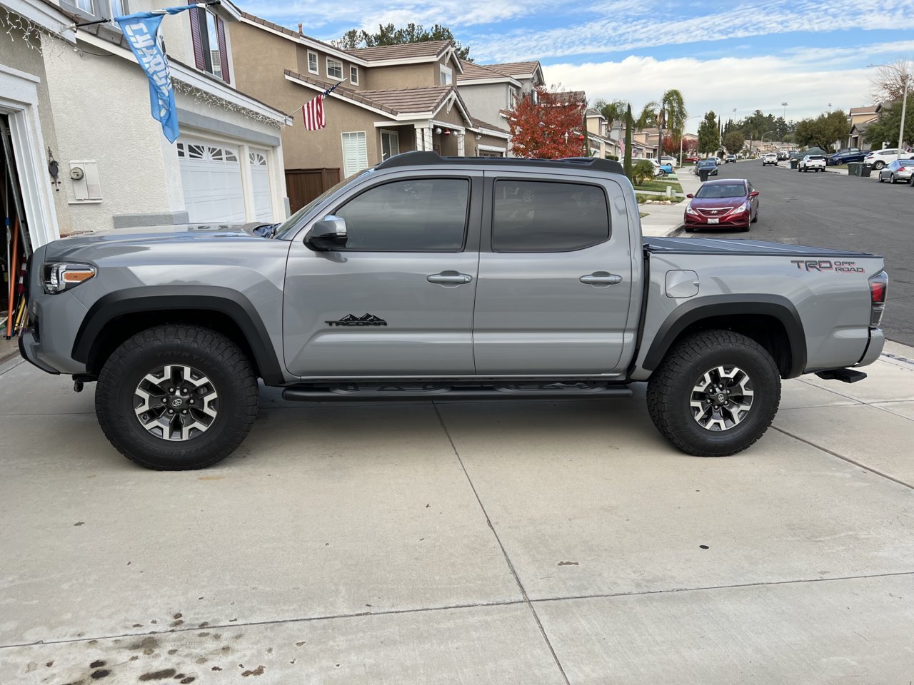

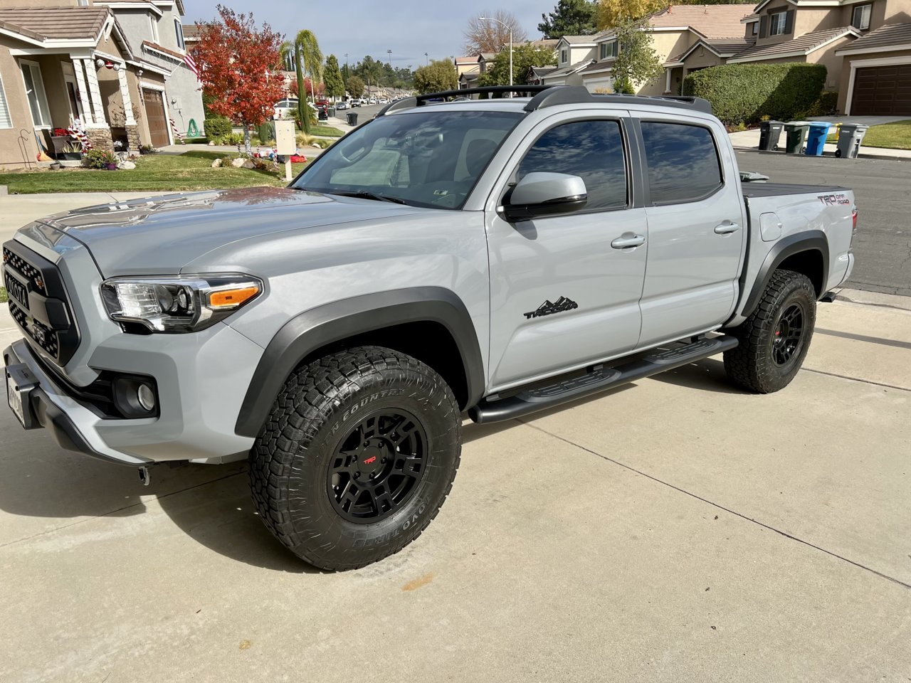

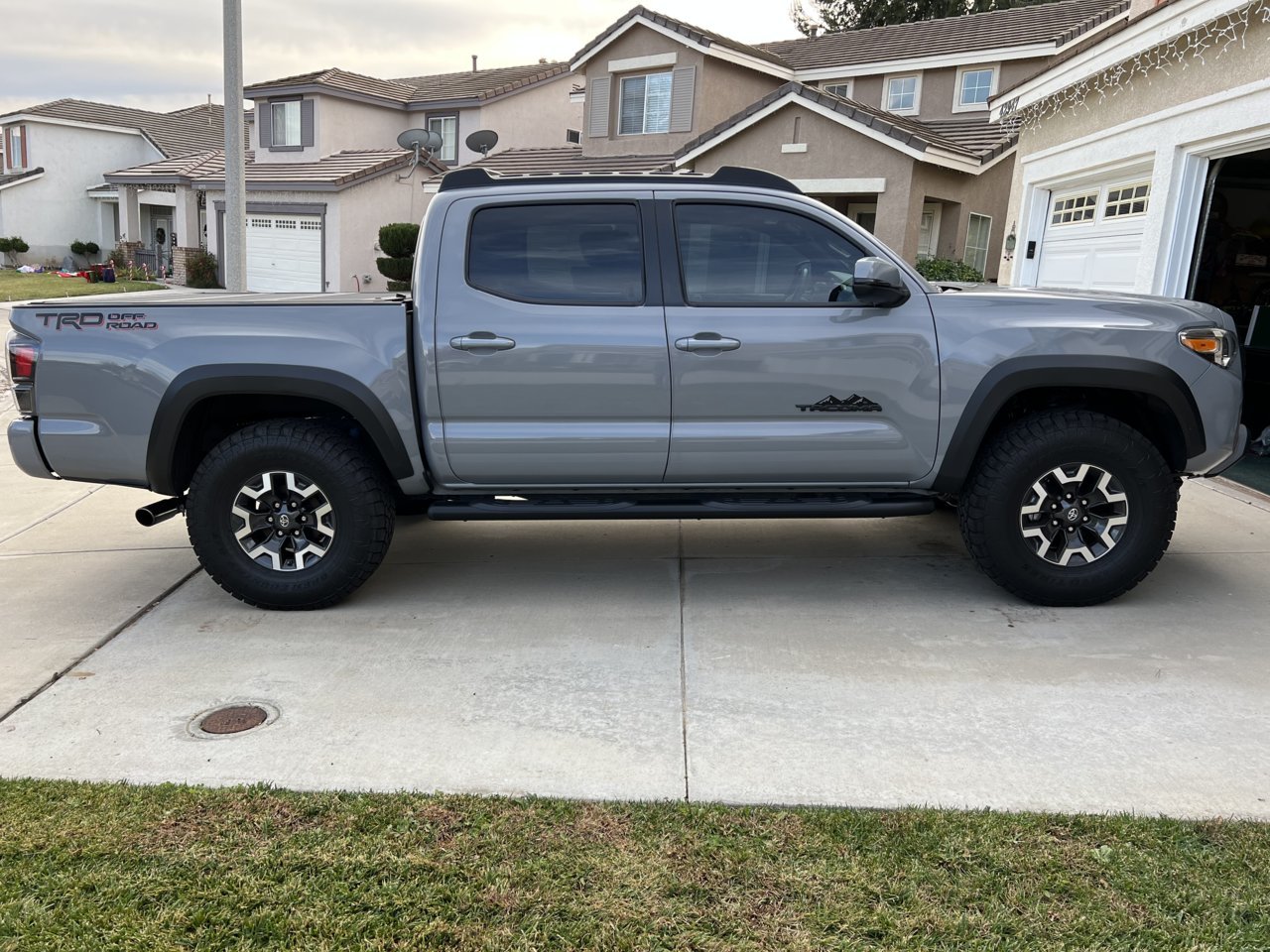

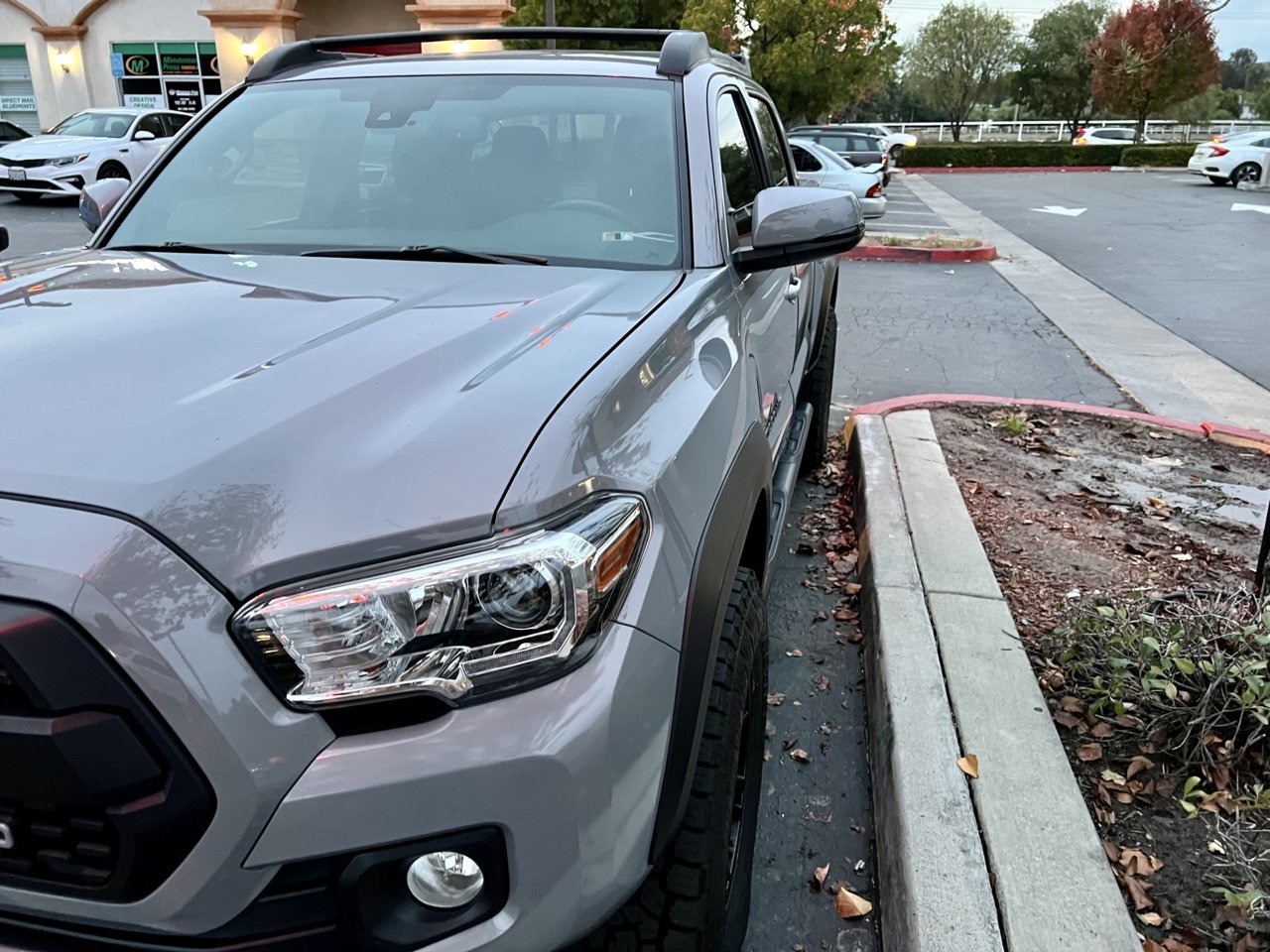

    KD Max tune, OEM Pro grille w/ four amber lights that turn on with DRL lights, OEM 5” nerf bars, OEM double crossover roof rack, Bilstein series, 285/75R16 TOYO Open Country A/T III’s on 16x8 FN Fx Pro Wheels in matte black (incl. spare) with Gorilla black spline lugs, TRD Pro skid plate, OEM chrome tailpipe, TRD Pro gear knob, Meso gasshole V2, chalk bag hydro flask holder, Bakflip MX4 topper, Spiker hood struts, OEM bed step, OEM TRD Pro tail lights, all chrome replaced with cement interior, Meso black out ultimate turn signals, stage 1 tail light kit, the elusive TRD start button, AJT cement radio knobs, all Meso ultimate LED dual color interior lighting, OEM power tailgate lock kit, OEM black chrome exhaust tip and other mandatory taco nerd accessories
    Just wanted to post pics of the FN Fx Pro matte black 16x8 wheels that I drove up and picked up from Dustin at FN Wheels in Corona, CA. I bought my 2020 Tacoma TRD OR 2WD DCSB a couple months ago and it came with brand new 285/75R16 TOYO open country AT III’s on stock suspension with no spacers. The wheels would rub on the uca’s at full articulation. These FN wheels pushed them out about 1.75” so I did what they did on the YouTube video I posted above and trimmed a little bit of the plastic on the bottom of the wheel well/fender. They came out well and I’m really happy with them.
    Before:
    520D824C-11E8-4F59-A6DF-5437188D9B64.jpg 68B5AE0C-3190-4504-8F01-BB4DD3A0D429.jpg 7B1993AB-11FD-4DE6-BF96-0F56A93DCA4A.jpg
    After:
    MinesBroken likes this.
