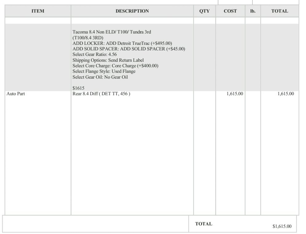

    I contacted East Coast, I have the mechanical LSD, to upgrade to TrueLock instead of OEM clutch LSD and regeared 3rd member about $1,200 all said and done. Few hundred outta budget, so have to wait. But these guys do know their stuff!

    Sorry, i ment trutrac, its always late by the time i have time to post, half asleep, lol!
    Here is details from Eastcoast estimate...
    "us building you a diff with 4.56 nitro gear, best gear for toyota in our experience, and a Detroit Tru Trac for your LSD option. The Tru Trac is in my opinion the best LSD on the market, no clutches to wear out, gear driven and very durable. We also put a 5 year warranty on your Diff, parts and labor."
