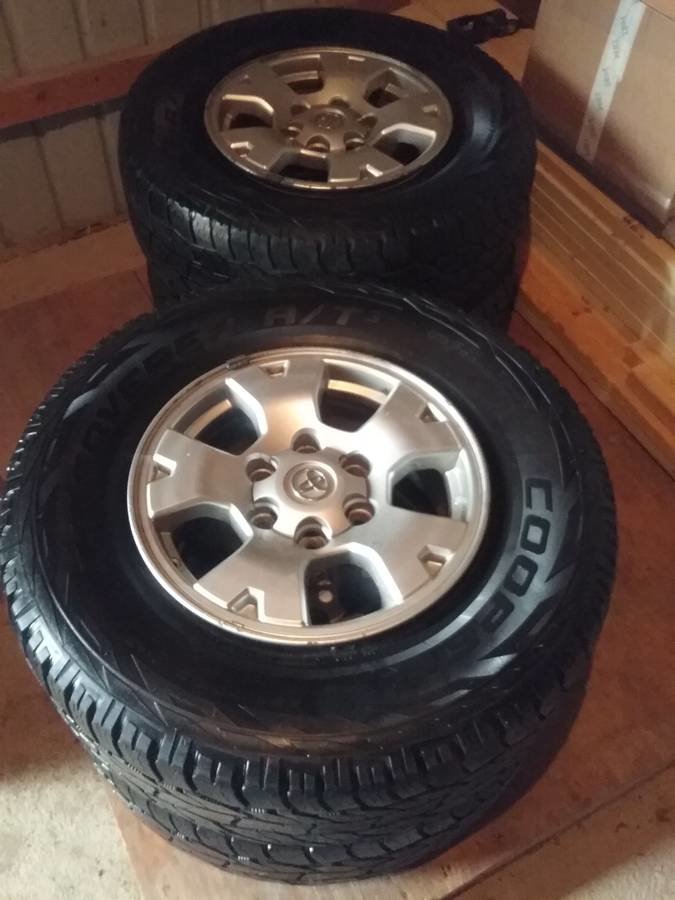

    Seller doesn't have much info, just trying to figure out if these will fit my '99 Prerunner correctly. Obviously the bolt pattern is the same, but I don't know about the backspacing.

    Hubcap heaven shows it to be a 16x7 with a 30 offset. If I am correct it would be a 5.25 backspace. Hopefully someone else will confirm that
