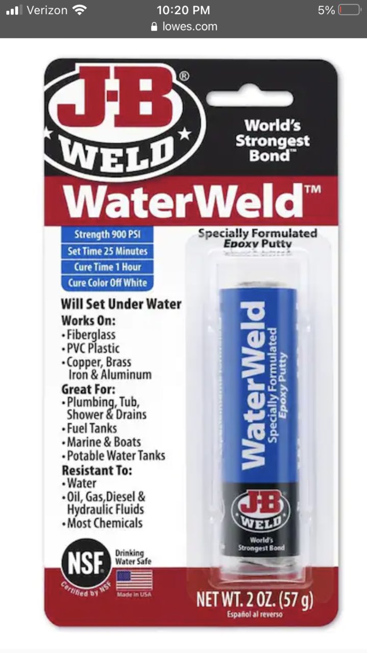

  11. Feb 9, 2022 at 10:23 PM
    Big Foot
    Big Foot Well-Known Member
    Oct 24, 2019
    #308925
    498
    John
    Washington
    2014 DCLB
    This could work
