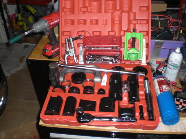

    So others have said they didn't need a ball joint press but you might. I know mine were cemented in there. The second link I posted early on in this thread shows a good approach.
    Also, any photos of which bushings and your progress?
