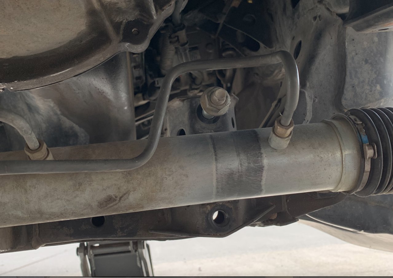

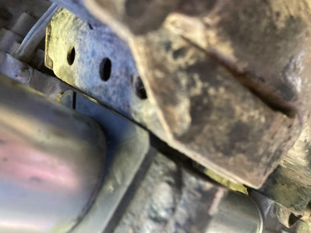

    Anyone else have an issue putting the bolts back in? I got the two singular bolts in fine, but for this one (pictured) where the two bolts hold in the side, I screwed up and the bottom bolt got stuck threading in, then popped off the nut that was welded inside the crossmember. The top bolt for me popped out also into the crossmember (the nut on the end also wasn't attached to the crossmember from the get-go). I had watched a couple youtube videos previous to trying this job myself, and everything had gone really smoothly for everyone else. It had gone smoothly for me until I was trying to bolt these last two in. The bottom bolt being stuck in the nut that had popped off the cross member, I had to cut the bolt out between the U-shaped thing and the crossmember, and fish out the nut on the inside with a magnet dangling from a wire, as the only hole to access that internally is tiny. Now, I am going to have to take my tacoma into the local dealership to have them probably un-weld that part of the crossmember to get it out, and finish putting it back together.IMG_3596.HEIC.jpg IMG_3595.HEIC.jpg

    Mine was that way also. Every video I watched said to put on the right side nut & bolt, and the bolt on the other end of the rack in first, in order to line up the center bolt hole. That worked for me.
