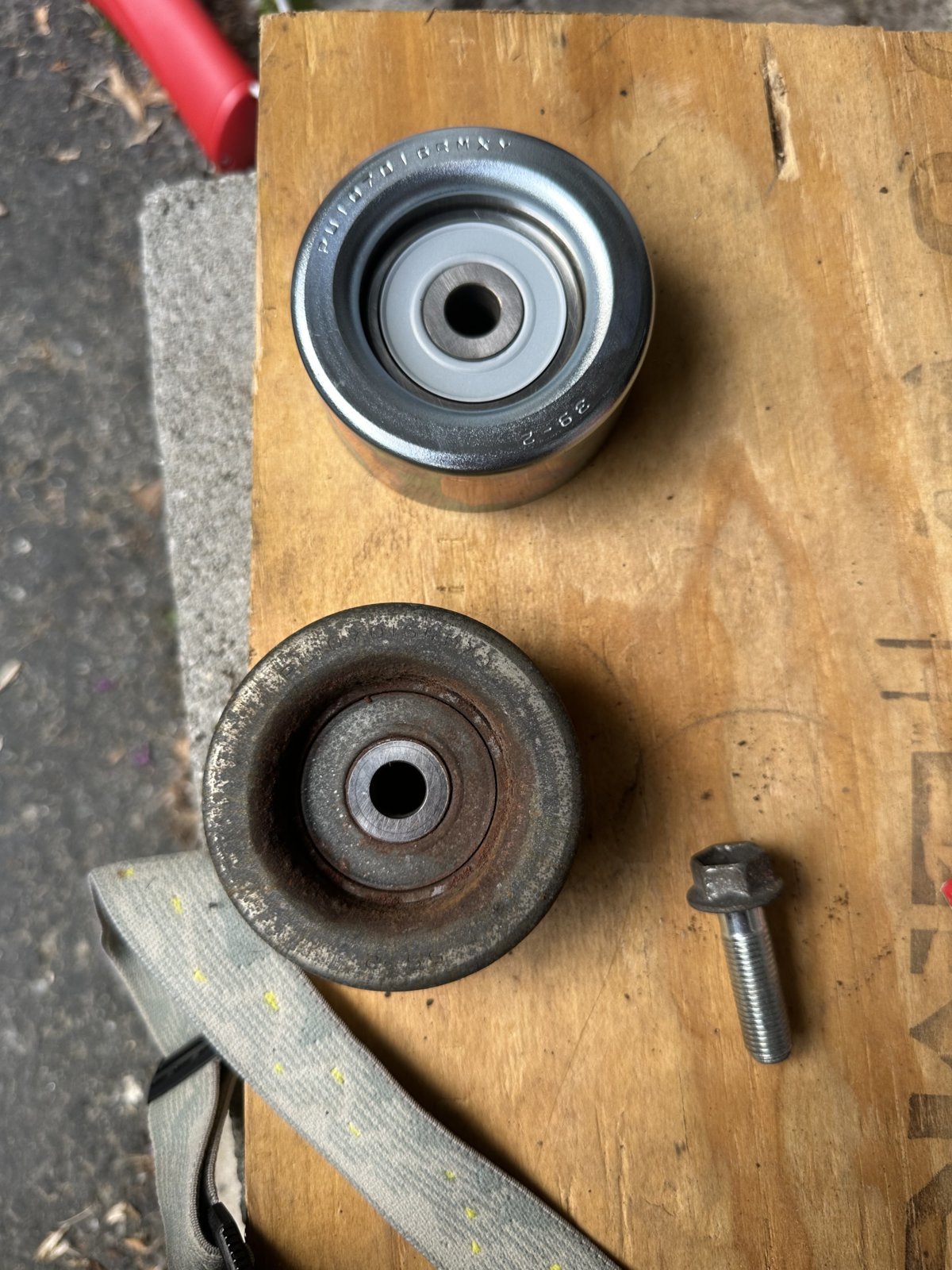

    I replaced the serpentine belt in the 2016 Taco today. Here is how it went. Before I go into the story, I will start by mentioning that I have done this at least four times in the various 2nd Gen Tacos that we own. From the time I open the hood, I can replace the belt, the three idler pulleys, and the tensioner in well under an hour, not rushing. That was not the experience here! I purchased the three idler pulleys and belt from Rock Auto. I purchased a Febest pulley from Amazon.
    After removing the belt, I first replaced the pair of idler #2 pulleys. I replaced them with Gates 36173, torqued to 29 ft-lbs, and this was easy enough.
    I planned to replace the idler #1 pulley with Gates 36174, but that is still in the box. I could not figure out a reasonable way to remove the pulley (in the middle of the pic below), thanks to some oil cooler or whatever the heck that thing is that is in the way. I imagine there is a way to get it out of the way, but I didn't have that much time to screw around with it. I loosened the bolt that holds the pulley in place and had thoughts of seeing if I could get it out, but I started thinking that even if I could get it out I might have a bitch of time getting the new one in; I just tightened it back up and left it.
    So, it appears the idler pulleys on the 3rd Gen truck are the same as those on the 2nd Gen trucks. That is apparently not the case for the tensioner. I purchased a Febest 0187-GRJ200, which worked fine as a replacement in the 2nd gen trucks. It is not a match for the tensioner in this truck. In the pics below, the Febest pulley is on the left, the original tensioner pulley is in the middle, and one of the Gates 36173 pulleys (idler #2) is on the right. The Febest tensioner is pretty close to the Gates. The hole in the middle of the Febest is bigger than the one in the original tensioner pulley. My memory of this from the 2nd Gen trucks is fuzzy, but I think the bigger hole in the tensioner slides onto an extension from the front of the tensioner. The Gates idler pulley, on the other hand, comes with a sleeve that fits in the hole, around the bolt, and that would be about the right size for the tensioner. In fact, the Gates 36173 appears to be a pretty darn close match for the Febest pulley.
    However, there is another difference between the Febest/Gates pulleys and the original idler pulley. For lack of a better term, I will refer to this as the offset--kind of like a wheel offset. Looking at the original pulley (see the last picture below), the mounting surface is about flush with the outer edge of the pulley. With the Febest/Gates pulleys, the mounting surface is recessed from the outer edge of the pulley. Looks to me like it won't work.
    FYI, in case you were not already aware of this, the bolt that holds in the tensioner pulley is reverse-threaded. Turn clockwise to loosen!
    Febest---Original tensioner pulley---Gates 36173
    At this time I have two new idler #2 pulleys and a new belt in the 2016 Tacoma; I have a Gates 36174 and Febest 0187-GRJ200 in their boxes. If anybody ever finds a good replacement for the tensioner pulley, please post here.
