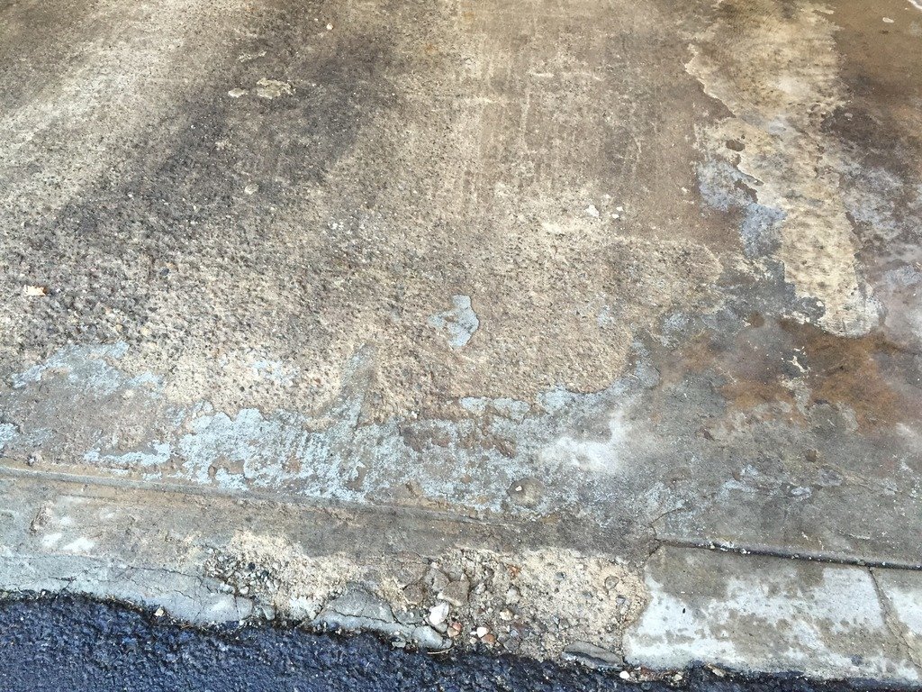

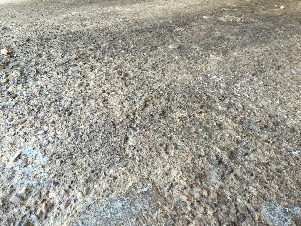

    Mine is in dire need of resurfacing... Looks like 30 years of salty cars have taken their toll.
    Obviously, the broken pieces up front need to be repaired. I'm just wondering if anyone has used a self leveling product, how it went down, and how it's holding up?
    DECAB521-5E09-41BA-9645-B2AEF7814F60_zps_c45c708f523833a3f739ffedf461685c5bb5244a.jpg
    499AB8A3-66BB-4820-B08F-D2061B9EA5BD_zps_b928e245577c69bce94e52c36da1f0690ff24ad7.jpg
    The back of the garage is still nice and smooth. I'm not sure if I can get away with just doing the front, or if I should just do the entire floor.

    From what I've seen, the professional garage floor epoxy companies grind the floor down. They will not trust the top layer because of oils and crap not giving a good bond.
    I'm sure if you powerwashed it down with a degreaser, let it fully dry, you'll be fine with a self leveler and whatever finish (epoxy or paint).

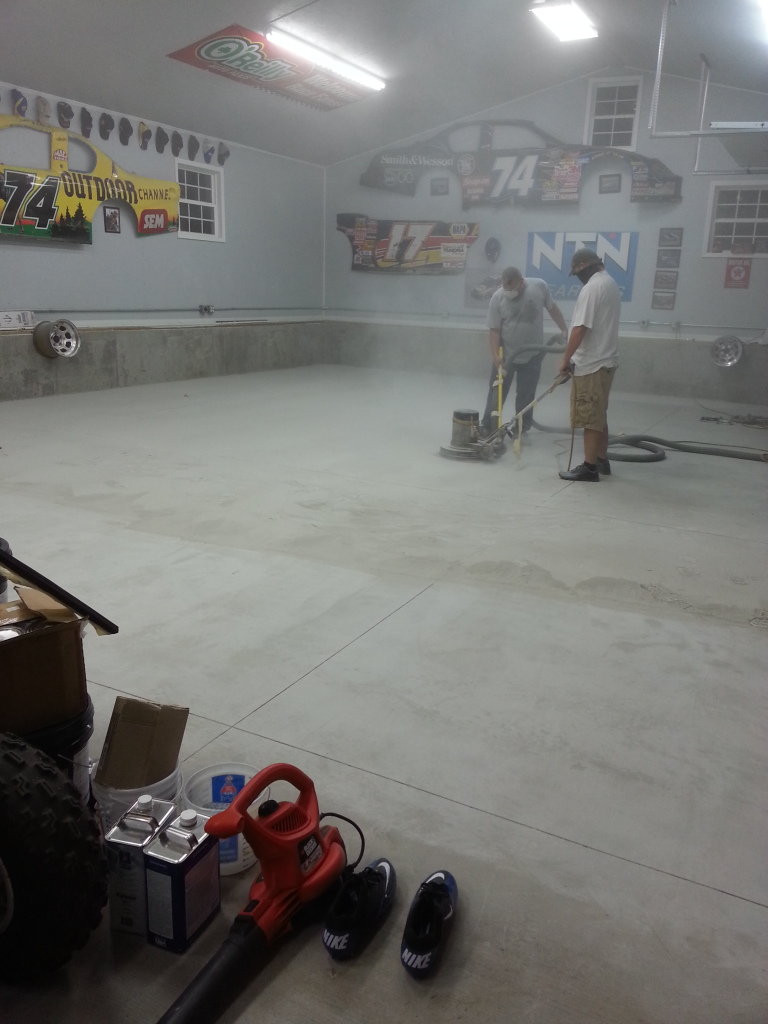

    I haven't done the leveling stuff, but the guys that did my shop floor used a floor buffer with some big diamond cutting discs bolted to the bottom of it to grind my floor smooth before epoxy coating it.

    WOW They didn't use an exhaust fan during the grind?

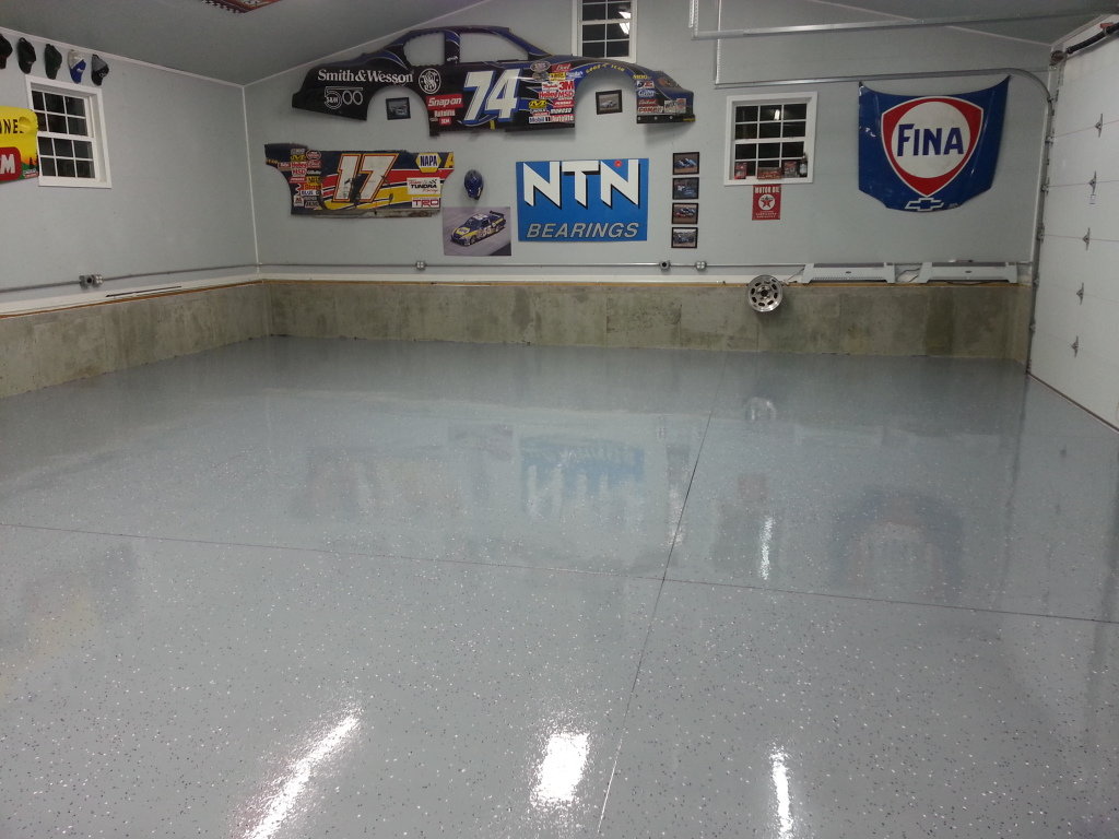

    I'm thinking the floor looks great, but it took a month to clean the walls, displays, and ceiling. :D

    You can barely see the door up in that picture and I had some box fans pulling some of the dust out, and they had a shop vac trying to capture some of it as they were grinding, but....

    He is right about one thing, You can see it in the pictures, just how much brighter the shop became with that reflective floor surface. It has the colored paint chips in it to help give a small amount of texture, for grip and to cut some of the glare off of it. But it is still quite slick when something oily gets on it, but it wipes up so easily.
    I got a deal from some guys that work for a big commercial outfit that does this kind of work. My shop was way to small for the company to mess with, so they take on small projects in the evenings/weekends to make some extra $. They use the same products (leftovers from bigger jobs) and the company equipment, so the price was about the same as I could have paid to buy the stuff and do it myself. I think it wound up around $1.50/ Sq. Ft. for 3 coats. Primer, color coat with chips, and urethane clear coat for UV and scratch protection.
    I would do it again in a heartbeat for sure.
    BC
