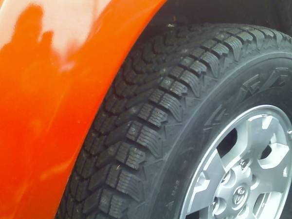

    Got a super deal on longbows' rims.(thanks dude) Put a set of Winterforce with studs on them. Driving a new route this winter with a few bad hills so I wanted the extra peace of mind.
    Aready had 1 trip home where nobody else could get up the hill, imo already paid for themselves. Made it home without slipping a tire.
    If it wasn't for that 1 hill I would have followed Demoncleaner and went with the Blizzaks for sure.....
