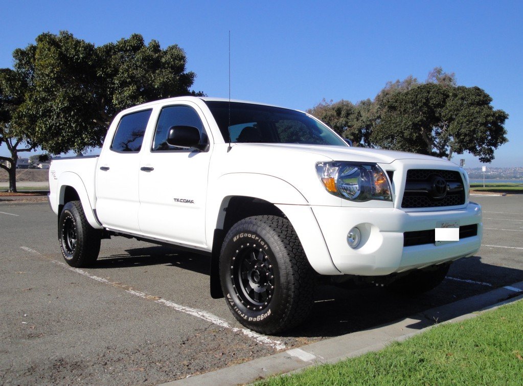

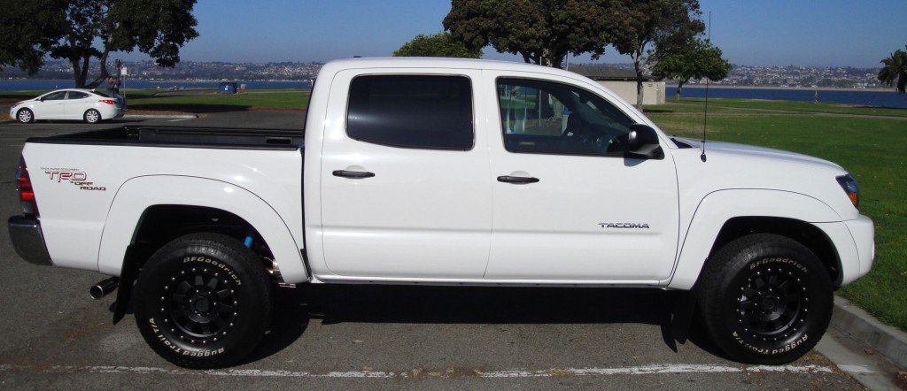

    hoss...are those 16x8 rims? what size tires? what kind of backspacing?

    16x8 Method Race 301s. 4.5 BS 0 offset. Stock 265/70r16 BFG rugged fails.

    An 8" wheel is only 1" wider than factory, so unless you get one with a -50 offset it's not going to look like a skateboard. And since there is no such thing, any 8" wheel you get is going to basically have the same stance as hoss'.
