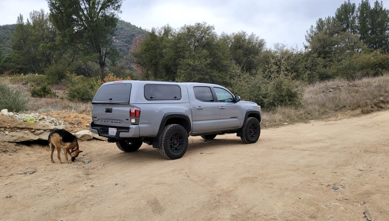

    255/80r17 Toyo AT3 on T4R "snowflake" wheels. TRD Off Road, Stock suspension. I have zero rubbing on or off-road, I have not gone "crawling" but for rough forest roads, it does fine. If 255/80's fit, I am sure you would be fine with 255/70.20221125_123803.jpg

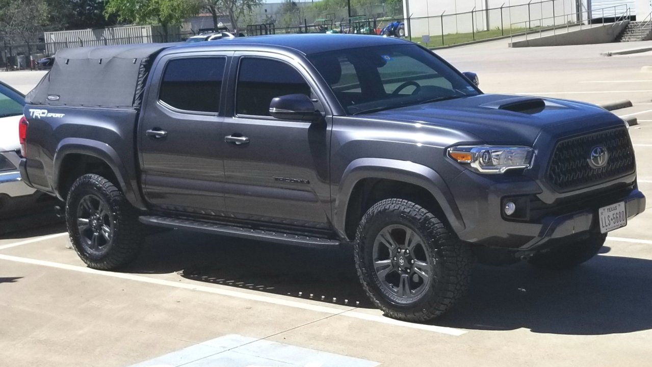

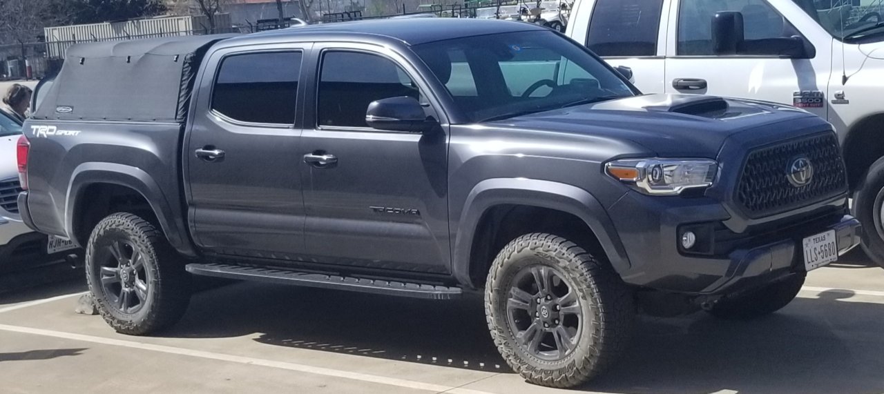

    No mods needed. Obligatory apples to apples picture time:
    In order,
    A: Stock suspension 265/65/17 wildpeak AT3s
    B: stock suspension 265/70/17 wildpeak AT3s
    C: 1" lift w/ +4 offset 265/70/17 wildpeak AT3s

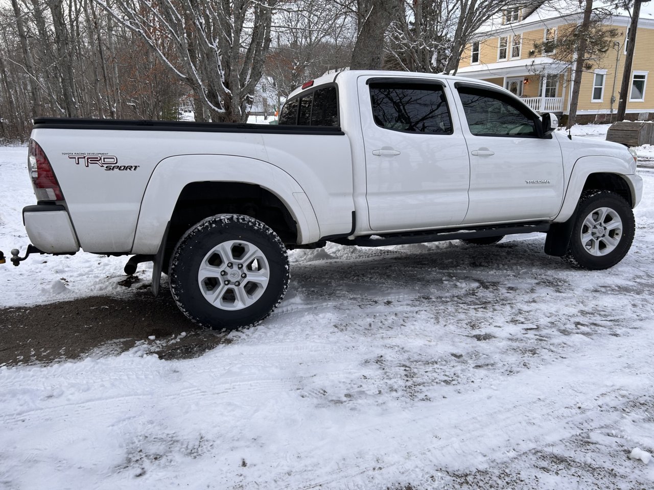

    255/70/17 Blizzaks

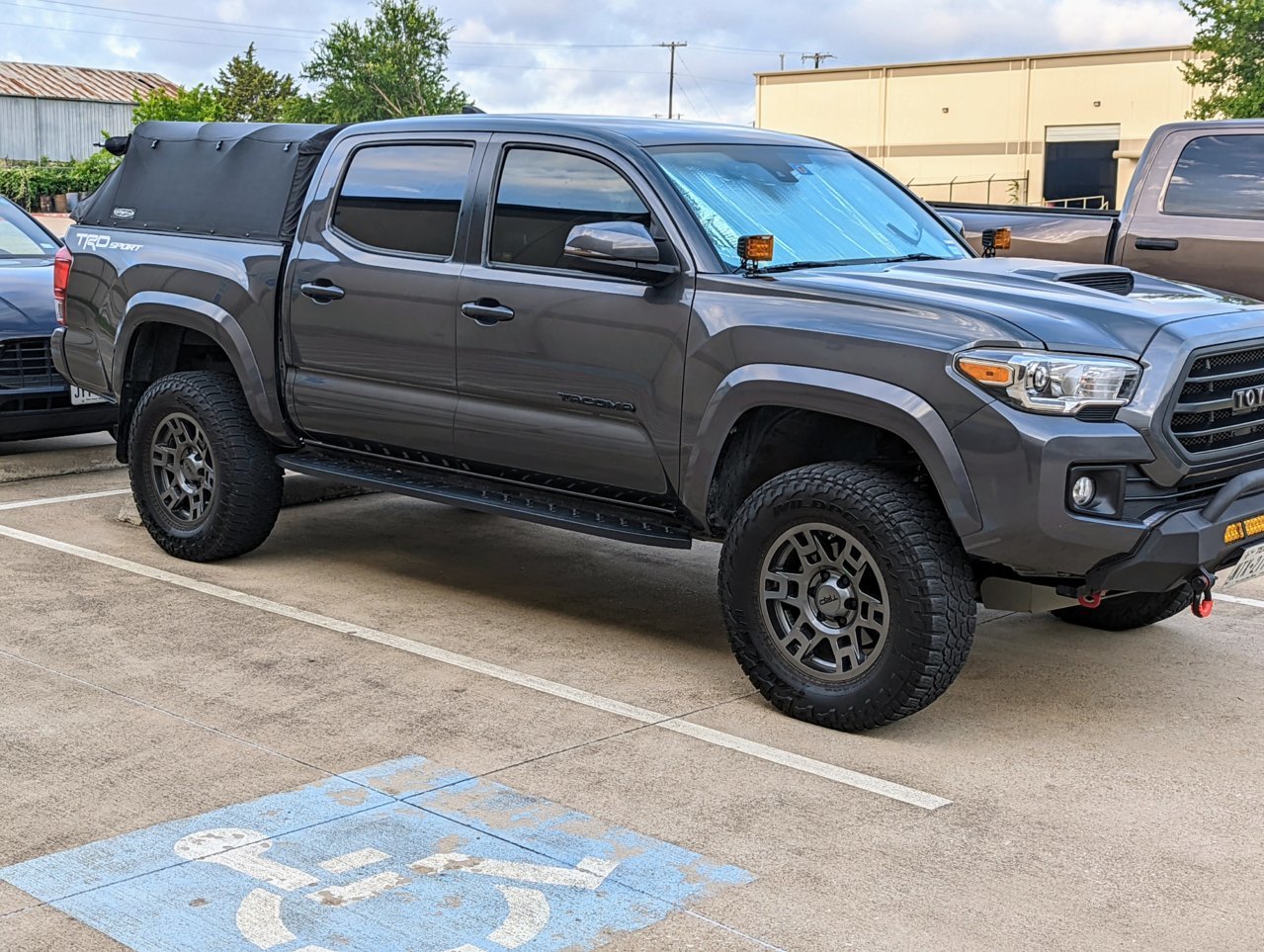

    Another vote for 255/75r17 ! Duratracs in this pic but I’ve also had Mud Terrains in the past, same size. Currently have 55K on this set which far exceeds my expectations. Mix of highway, grid, off-road and as always lots of ice/deep snow!
    Ran these on stock suspension for 6mos and then added a 2.5”/2” level. This is a stock Jeep size & in the past I’ve gotten these as take-offs from the Jeep dealers (just leave em your number, many of their clients swap or upgrade tires right off the lot)
    Last set of MT’s I got was $800 installed which is about 1/2 of retail!
    IMO this is the sweet spot for Tacoma tire size! Would love to mount some 255/80/17’s for a little more height but the selection is slim
