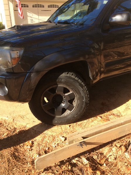

    I am running that size on LT load range C AT Revo 2s. I have some slight rub on the front driver side at full left lock only, but I think it's an alignment issue. I have my mud flaps removed. I also switched to FJ wheels at the same time which I think have like 1/2" more offset, so that may have helped too.

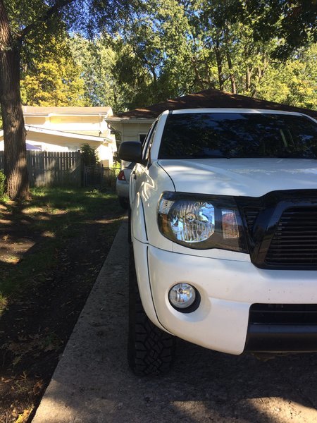

    I'm running that size with Goodyear Wrangler SilentArmors on the stock 17" sport wheels and I get a bit of rub if I hit a bump while at full lock, but otherwise nothing. The only time I hear it, really, is my
    wsurunner[OP] likes this.

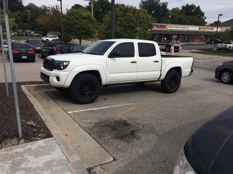

    Exact setup, no lift. The only time it rubs is full lock on the driver's side, and even then it's extremely limited.
    Goodyear Wrangler Duratrac on the 4Runner TRD Pro wheels, no mud flaps.
