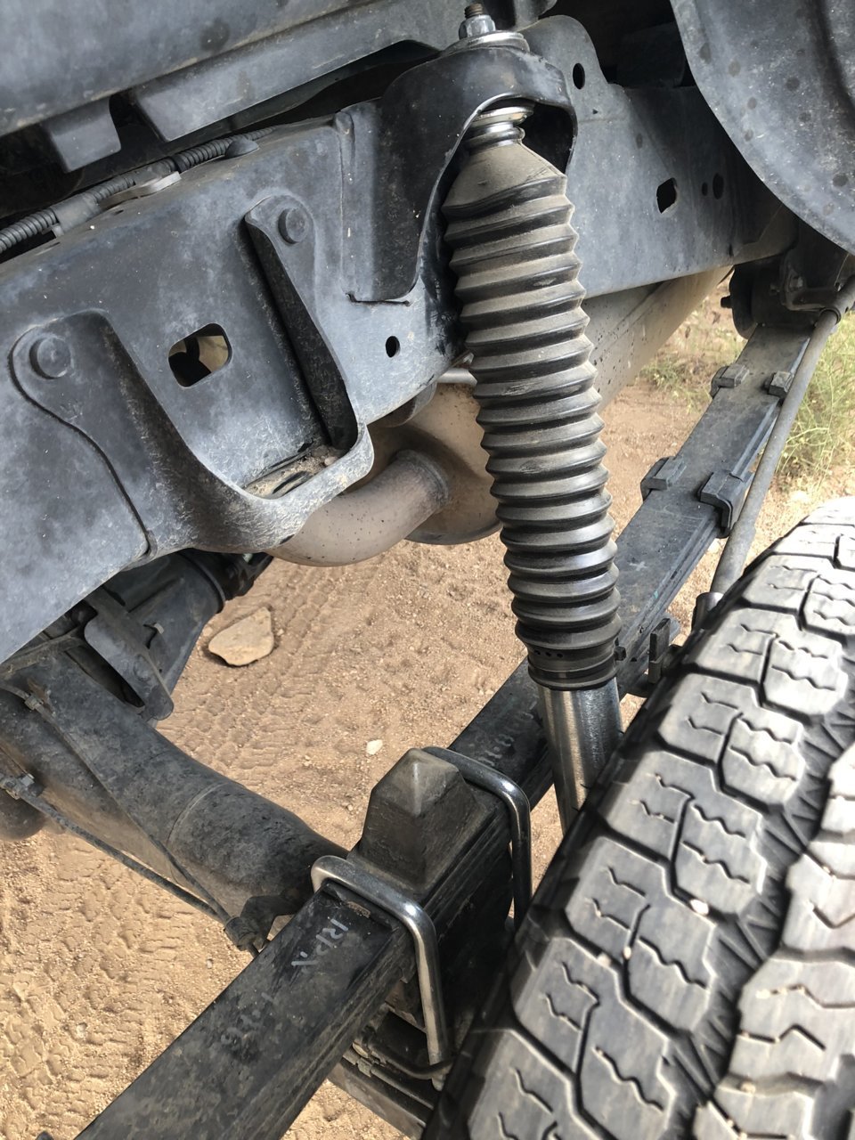

    Bilstein 5100 running the highest notch which gave me 2 inch lift up front and bilstein in the rear with 1 3/4 inch blocks. Running wild peaks at 265/75/16. No issues with harsh ride or drive train so no need for diff drop of shims and the like. Very happy with my set up, gave me a great lift without having to do a ton of small adjustments. I'll see about some pics.

    You can run them at stock, 1 inch 1 3/4 and 2 inches. I chose to also keep my stock springs so no OME springs, just swapped the OEM shocks. Cost me 400 with all the hardware and also saved money as I did the swap myself. Here are some pics and I’ll get better ones I hope by this weekend for you guys to see.

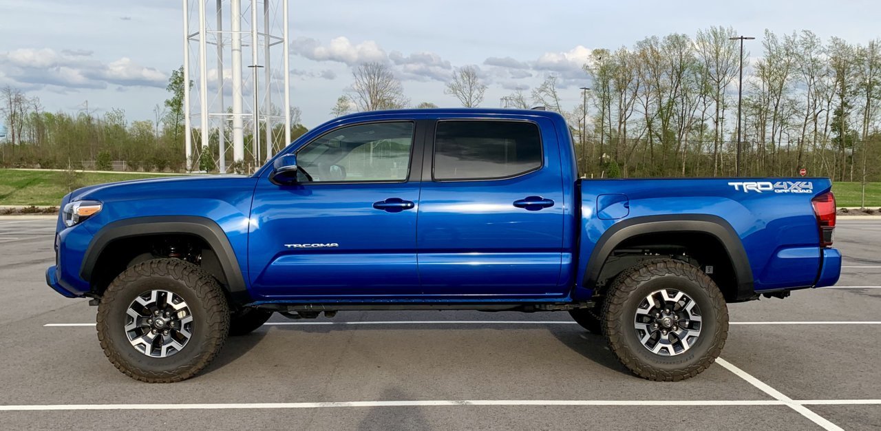

    Icon Stage 5 around a 2.25 or 2.5 lift with 265/75/16. Zero rub at full flex, full lock, good gas mileage and accel on stock gears. Keeps the truck sort of a sleeper too. But it goes anywhere. IEFX6218.jpg IMG_0709.jpg

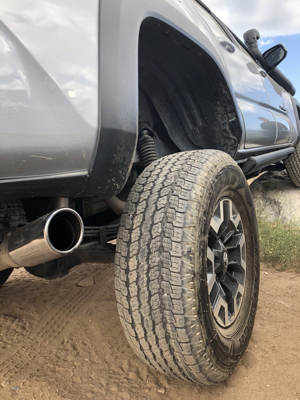

    Here's mine with the new tires and set up as well.

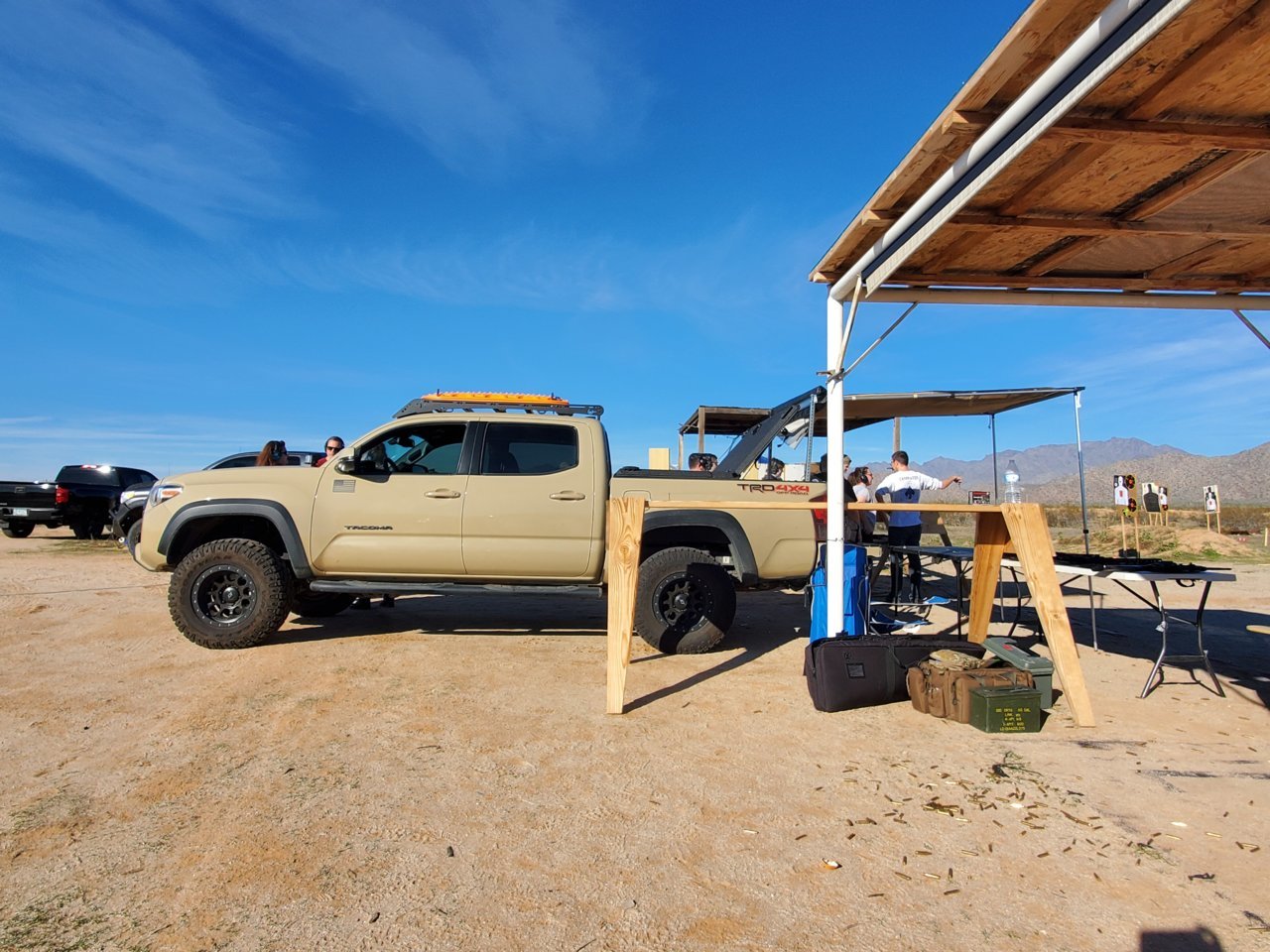

    Here is my old truck with a 2/1 lift and 265/75r16s. I also ran them with no lift and they fit fine.
    I honestly liked that tire size better with no lift.
    MandosTaco, RushT, Toyota09 and 2 others like this.

    This came with the Icon AAL pack. I also have a quarter inch shim on the axle between the pack. My overload spring is not in there so this pretty much is the same height as if I did.

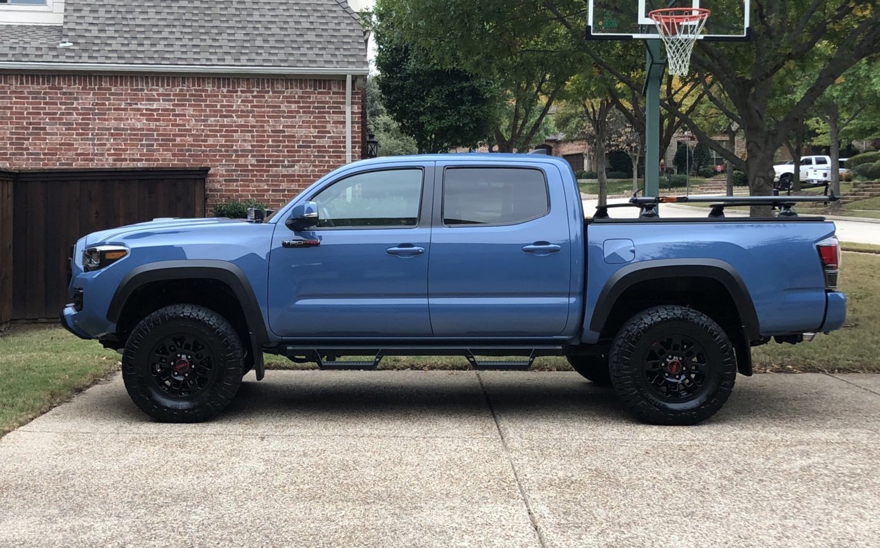

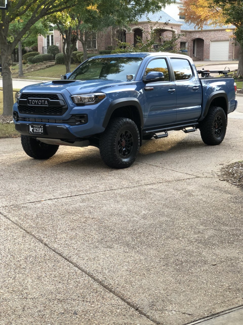

    2.7" lift in the front, 4.0" lift in the rear, with 2nd gen TRD OR wheels
