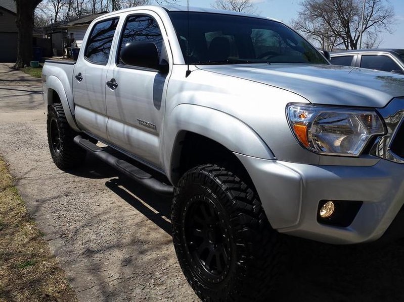

    I'm running a leveling kit that sits around 2.5-3inch higher than stock with 285/75/18's nitto trail grapplers with no problems.

    No trimming, no rub! Post pics of your rig. Thanks BTW I love tacolife

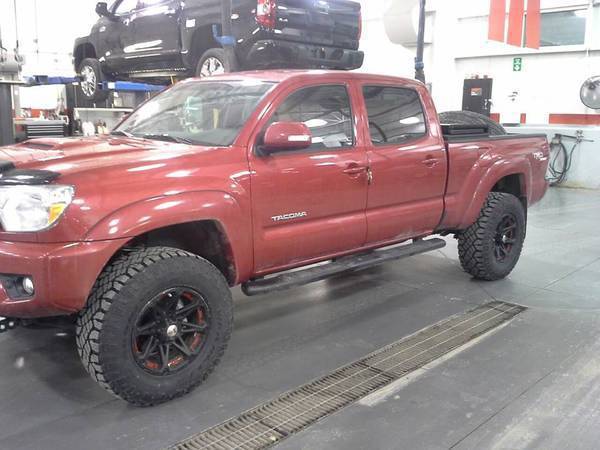

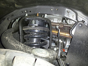

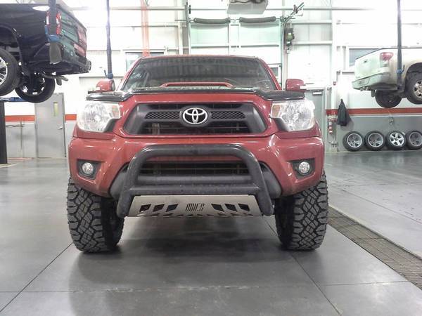

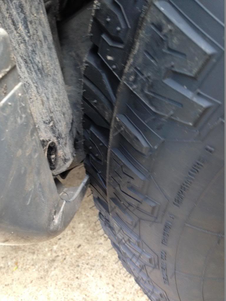

    On Monday (March 24th) I had a TOYTECH 3" lift installed and some Duratrac 285/70R17s installed. In order to not rub against the control arm of the front coils they had to install so 1 1/4" spacers to make them fit. Now my rims were the culprit, and if I had some rims they pushed the tires out, there wouldnt have been any rubbing issue.
    Side view
    There is still a bit of rubbing on the plastic in the wheel wells but I am removing the factory fenders flares and putting on some black Bushwacker fender flares. I might have to do some trimming but I will see and let you know.

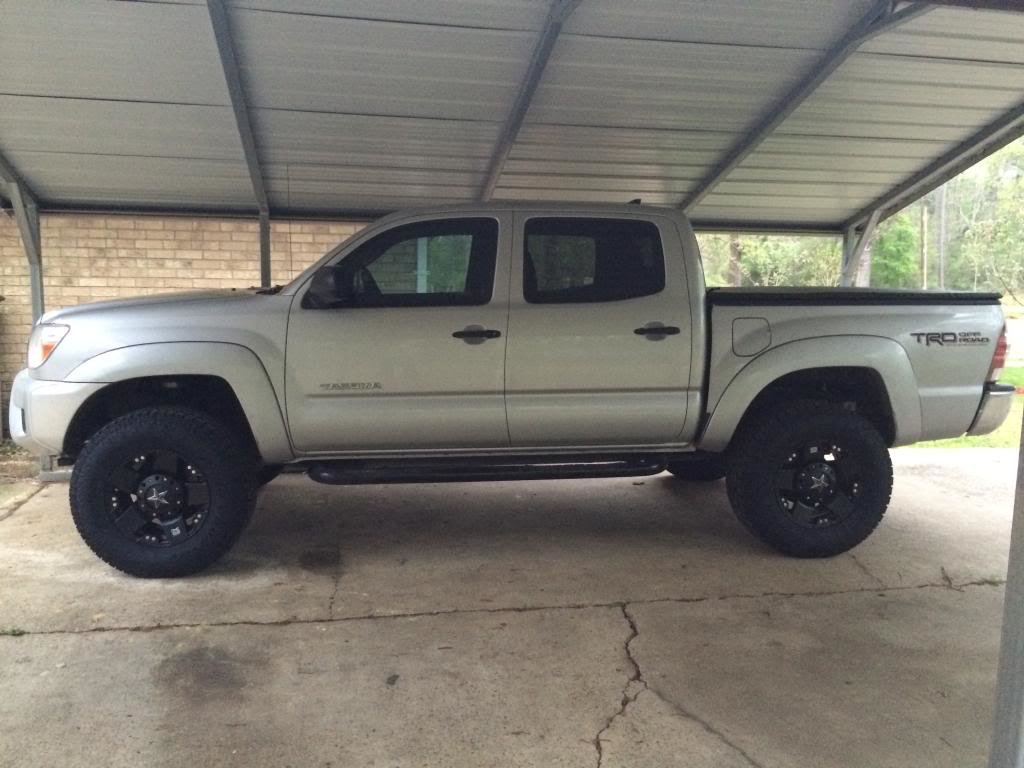

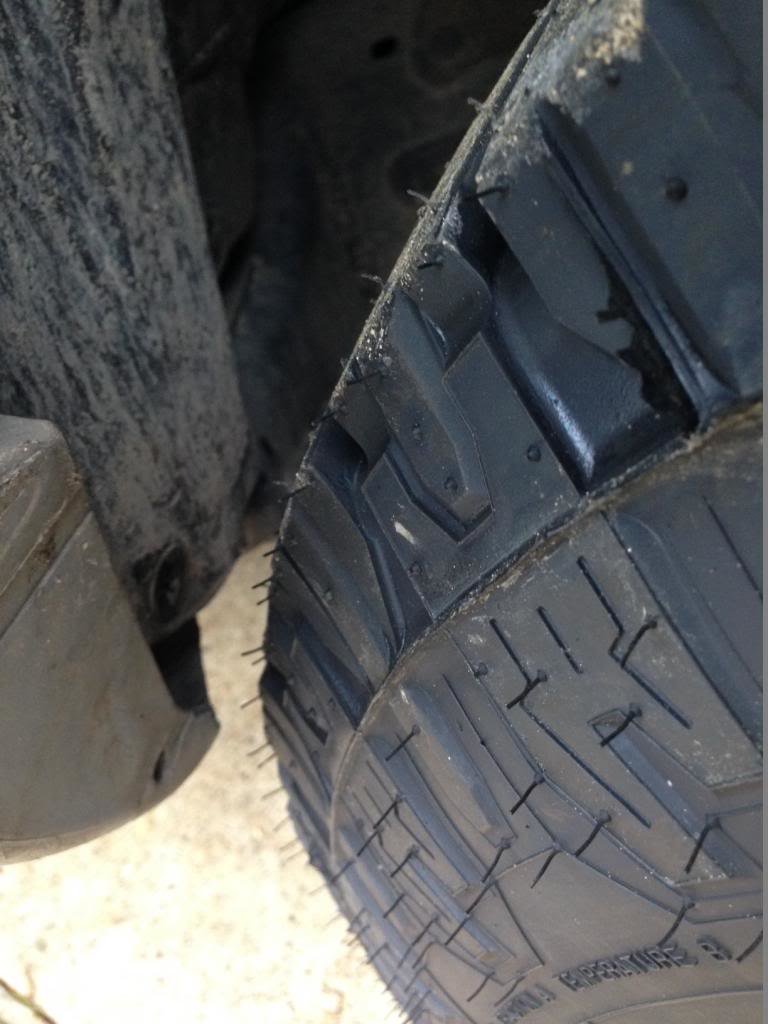

    2013 Pre DoubleCab 3" Rough Country lift. I put Rockstar XD's with -12mm offset and 285/70/17 Toyo's. Even after removing the mud flaps I had to cut a small portion from the inside of the front flares. The outer lugs of tires were rubbing.
