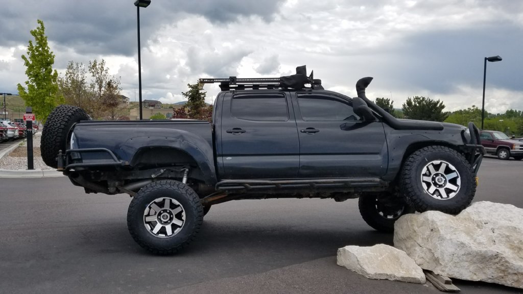

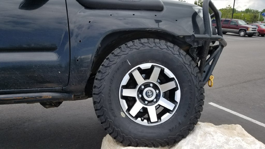

    Any updates on anyone that was going to get the 285/75R17's installed. I am cut like crazy everywhere except the flare area. Is it needed to open the entire flare area all the way around to fit the 285/75R17? I know offset of wheels will play a big part of that as well. Which is why I am putting them on factory 4Runner offroad wheels first. 17x7.5 ET 15mm I have a set of spidertrax wheel spacers that if I put those on will set the outside of the wheel in the exact same spot as a 17x8.5 ET -10mm. BUMP FOR AN OLD POST AND WHAT LOOKS LIKE A PERFECT TIRE SIZE!

    Just picked up a set of these exact wheels yesterday, planning on ST maxx 285/75 17.. Any pics not flexed by any chance?

    Sorry, only pic I have at the moment. I was plasti-dipping the shell so it wasn't silver for the time being.

    Thanks!.. Now to find a store near me that will stock this size in the tire I want.

    Bro, that's one of the nicest looking balanced trucks I've seen.
    I think that's the money size tire for the Taco's :mudding:

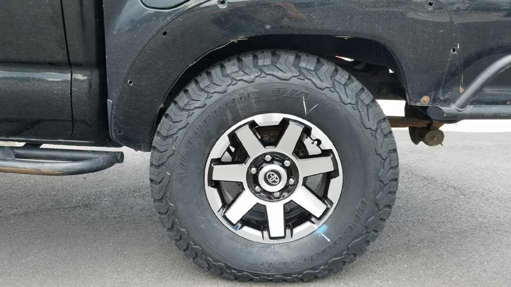

    Icon coilovers w 14" 700lb springs, Icon billet UCA w/ Delta joints, custom built Icon rear resi-shocks, Icon stage 3 rear leaf pack, Archive Garage Hammer Hangers w/ homemade spreader bar, superbumps up front and timbren bumps in the rear, Crown brake lines, U-bolt flip,4.88's with front ARB locker and ARB dual compressor mounted behind back seat, 285/75R17 BFG A/T KO2's on Bronze Icon Alloy Compression's, 5th gen T4R budget big brake kit, CBI Off-Road Fab. custom Trailmaster 2.0 with swing-away tire carrier, CBI custom tube front bumper, CBI kickout sliders, CBI full flat belly skids including gas tank,CBI Ditch Light brackets w/ Heretic Studio Quattro's, Heretic Studio's 30" Amber on the front, Heretic Studio 40" bar under the Front Runner Roof Rack, Expedition Essentials RAM mount, Leer used shell, OEM black chrome sport headlights, fog lights always on mod, rear locker anytime mod, TRD supercharger, URD Ucon-EMS, Deatschwerks 255 fuel pump w/ URD external fuel filter kit, AFE intake paired to a Safari Snorkel, URD spec-U exhaust w/ factory Tundra muffler behind URD equal length headers.
    I will update the pics, but I just put the same tires as a couple posts up above, the 285/75R17 BFG KO's on a set of bronze Icon Compressions 17x8.5" w/ a 00 offset and they rub just slightly on the outside of the frame in the back side of the wheel well. But they look great.
