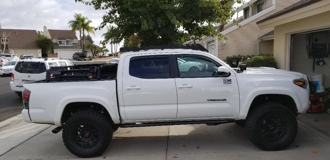

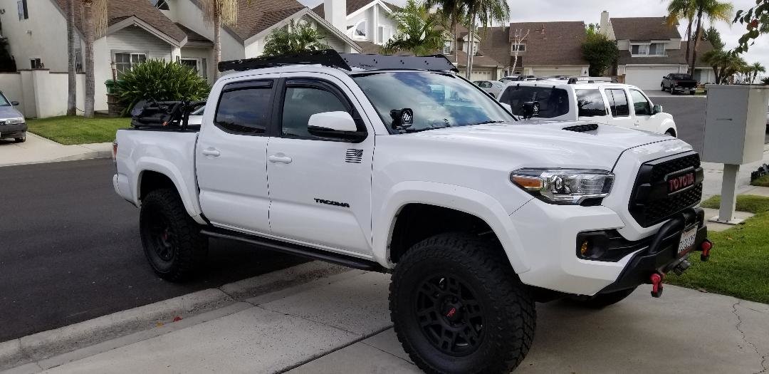

    ghfds.jpg jjhjh.jpgCooper ST MAXX 285/75/17 trimmed fender plastic down low nearest body mount area re shaped plastic inner fender with heat gun,added icon 700lb springs no rubbing on any city driving . However offroad it does rub on plastic in the lower areas and i don't have CMC done yet. I have a really good alignment and these TRD wheels help alot with the offset. Just ordered the Demello Baja front bumper that should take care of the fender rub!

    How do you like the Cooper St MAXX?

    Awesome so far. Had them on for about 3 months. Surprised at how quiet they are on the highway!

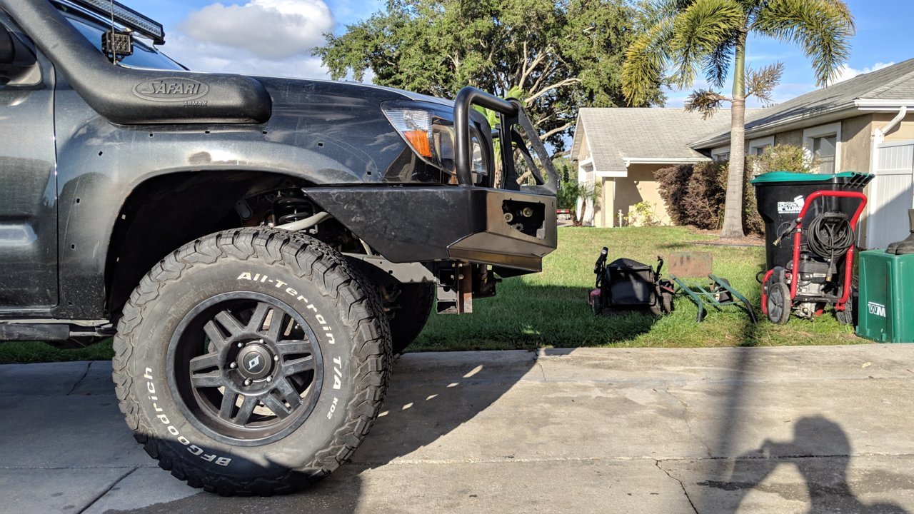

    Yup the ARB bumper is cut a bunch!

    Got a link to a build/your mods on the bumper? I just threw a 12-15 ARB I picked up for $200 on my '10. I made / am making some custom brackets and am going to have to cut the wings and polish up the fitment some more; would like to see some similar work know things to look out for.
