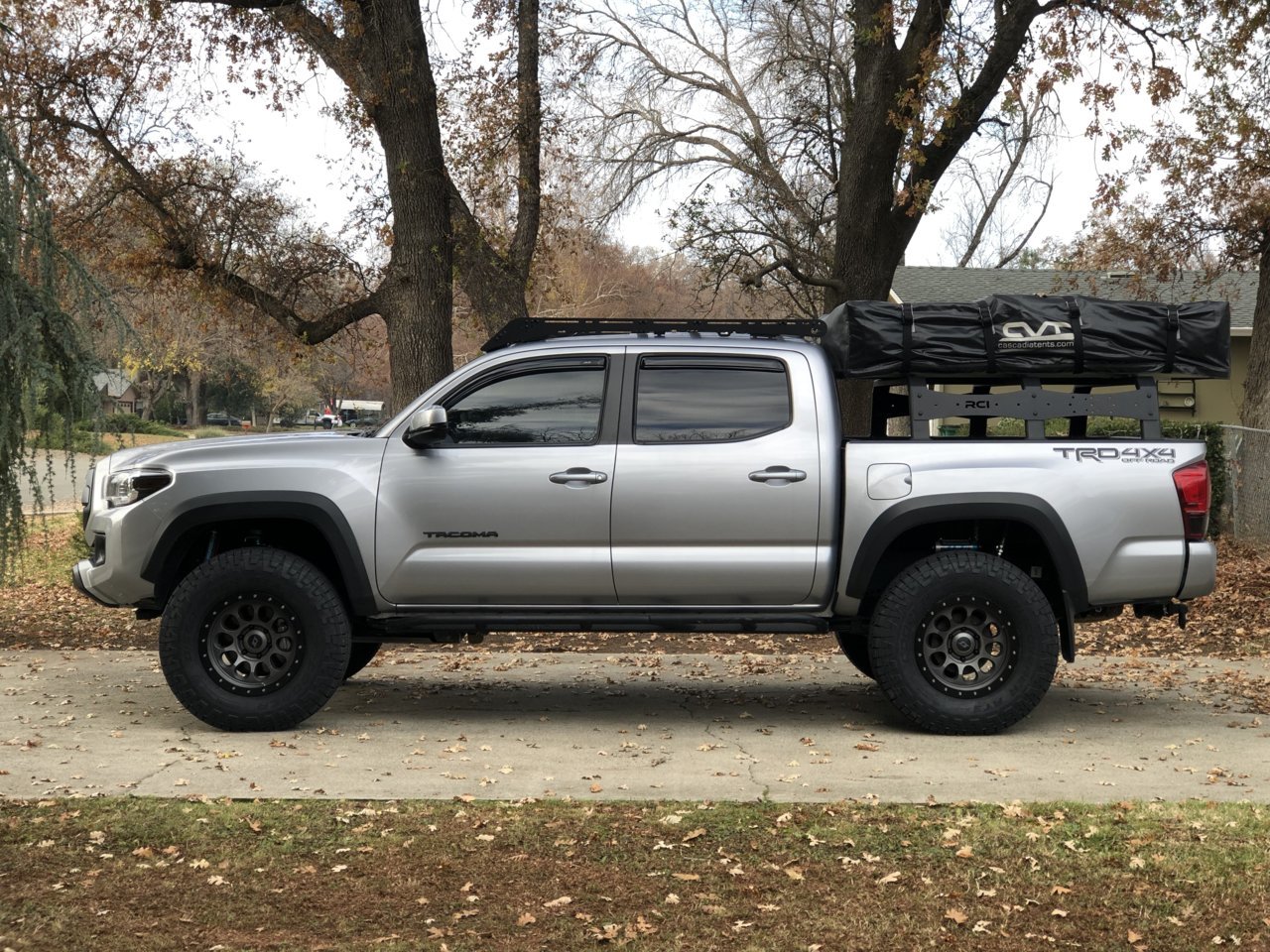

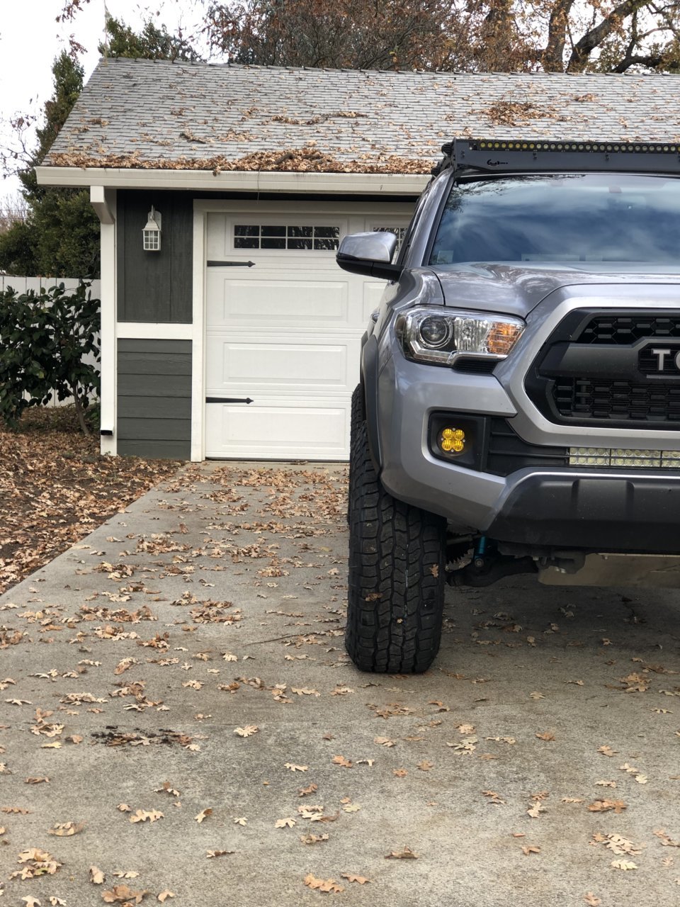

    I have Kings but similar set up. 700 lb coils with 3 threads showing (so little to no preload), 285/75/17 Cooper AT3 XLTs. Super happy with it. I have aluminum skids, steel sliders and a roof rack, plans for bumpers eventually. With what I’ve got it all feels great on and off road and it’s great to know I can easily go up when the time comes.

    2016 TRD OR DCSB
    Forgot the pic
    trdt44 and Hookedup like this.

    Sure is purdy.. for whatever reason I’m digging the looks of the 75/r17 over the 70.. did you do a diff drop or carrier bearing drop?? thanks for the info.. I’m taking notes..

    2016 TRD OR DCSB
    Thanks! Yeah I really liked the look of my 265/75/16 until I installed the lift.. way too small..and I wanted the same look/sidewall-to-wheel ratio, so this size was perfect. Haven’t noticed any loss in power or anything either. Looks mean from the front too, can’t wait for front bumper to get more tire showing

    Thanks for the pics i just ordered an OR in cement and good to know about the power.. i assume you have an AT?
