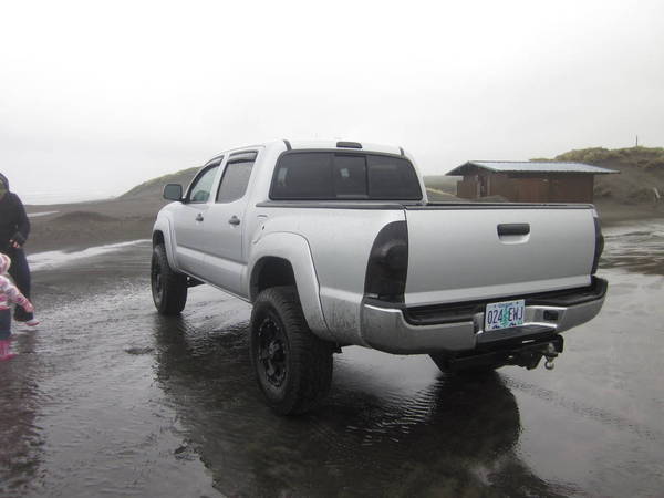

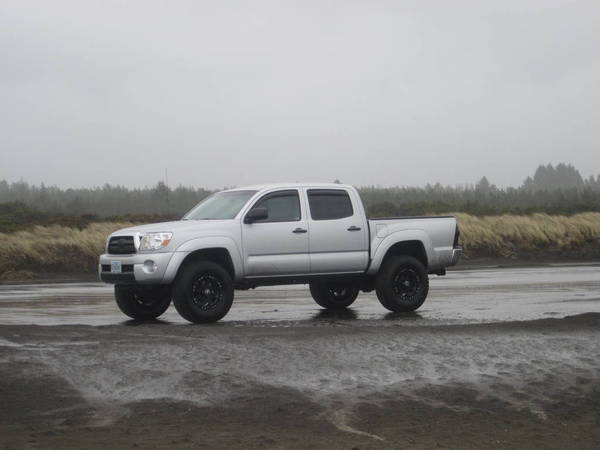

    5100 front at 2.5'', rear leaf tsb and 1.5'' AAL, tinted tails,Race Line Raptors 16x8, Wild Country XTX with mountain snowflake 285 75 16, tow hitch w/brake harness, locks on storage bedsides, tailgate theft mod, heather blower tsb, custom bed rails, black front valance, mud flap delete, 12v full time power, seatbelt buzzer silenced, custom storage behind rear seat, bottom of cab painted, rear view mirror on/off switch, diff breather relocation,
    Here is some pics of billies at 2.5. TSB and 1.5'' AAL. If your not doing upper control arms I would not do a spacer ontop of the billies. It will throw your alignment way off.
