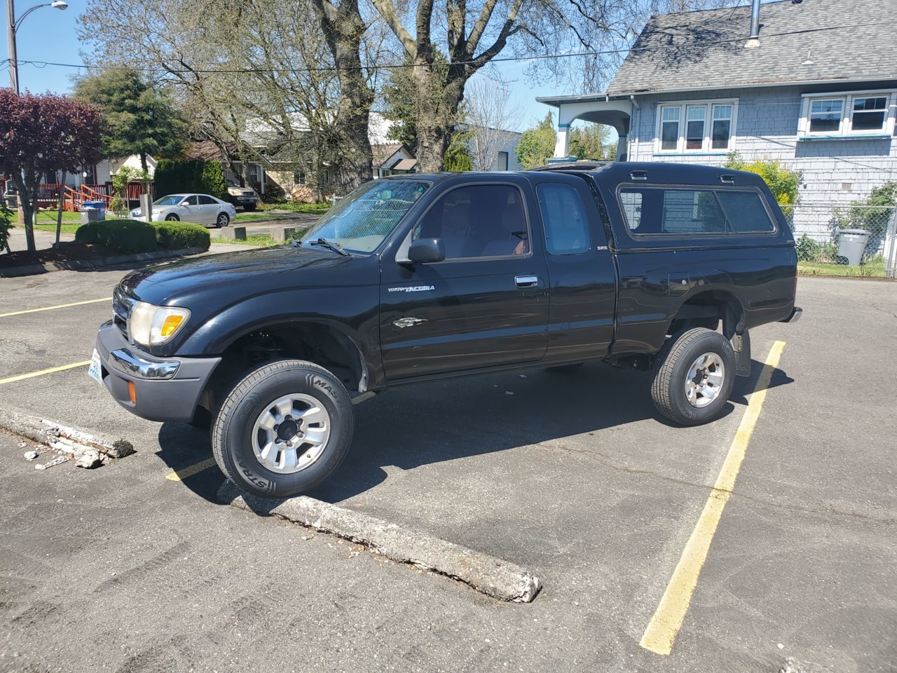

    What gear ratio is in your truck? I had worn out 31x10.5s and went down to the 235/75. I like them alot more because I have 3.58 gears, now the shifting is so much smoother and I can actually pretend like it can accelerate from a stop20230429_130645.jpg
    Now I'm ready to crawl all the malls
    Jedwin[OP] likes this.

    Haha. Stock gears, with no interest in changing that. The 31s seem like overkill for the errand truck this is becoming… and I do live in an area with expensive gas and lots of hills. However, I’m curious about the 30/9.5s because the weight difference doesn’t seem like as much of a factor… 3-5llbs depending on brand. But does seem like some lighter 235s will allow me to use gears 3-5. I like having access to more than 2 gears.
