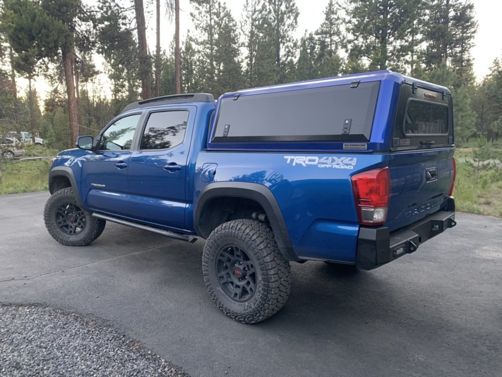

    I ran a 33/10.5 tire on the 17” 4Runner Pro rims. They fit and worked great. And just so know, as it seems most people don’t realize this, that lifting your truck won’t help you fit larger tires except when it’s parked. What do you think happens when the suspension compresses on your lifted truck? Everything ends up in the same location it was at before you lifted it. So if a tire doesn’t fit on your stock truck it’s not going to fit on a lifted truck.
    A 33x10.5 tire is a great size for these trucks lifted or not.3C63AE7C-AD2C-44BC-AE2D-97E011164479.jpg

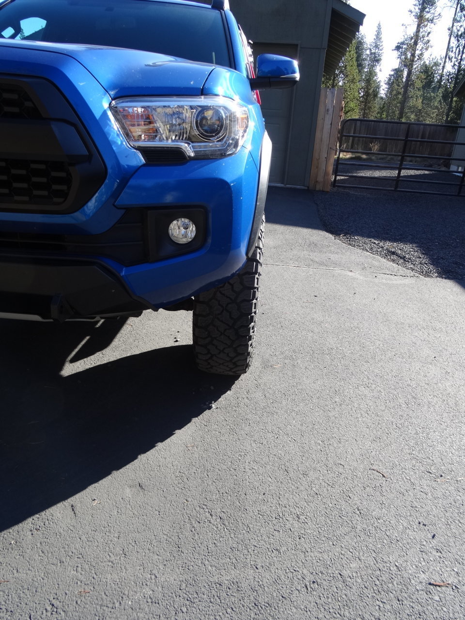

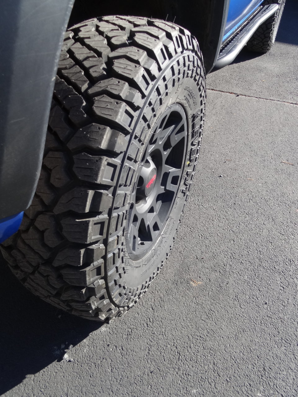

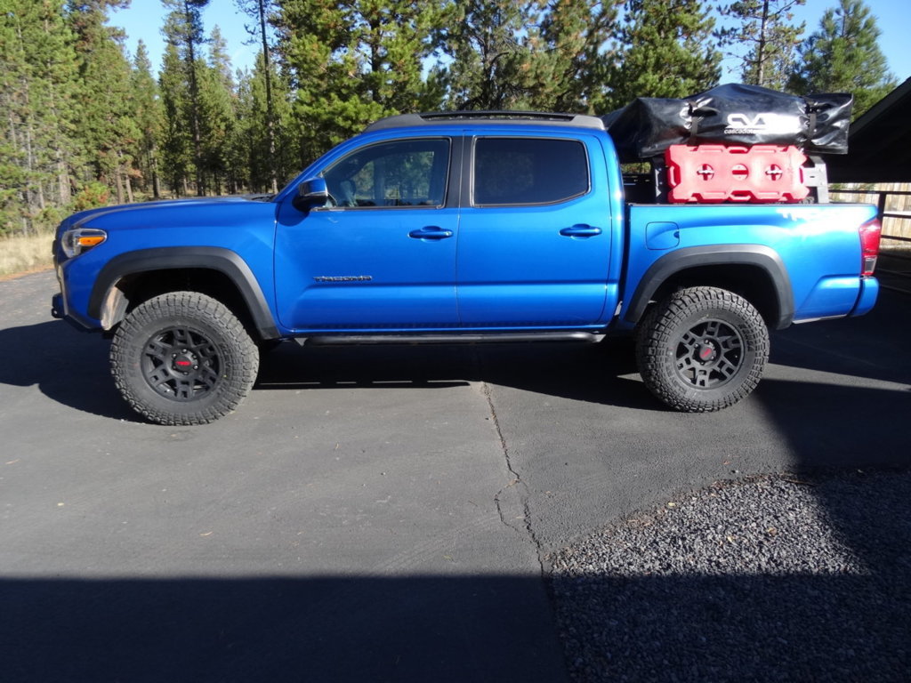

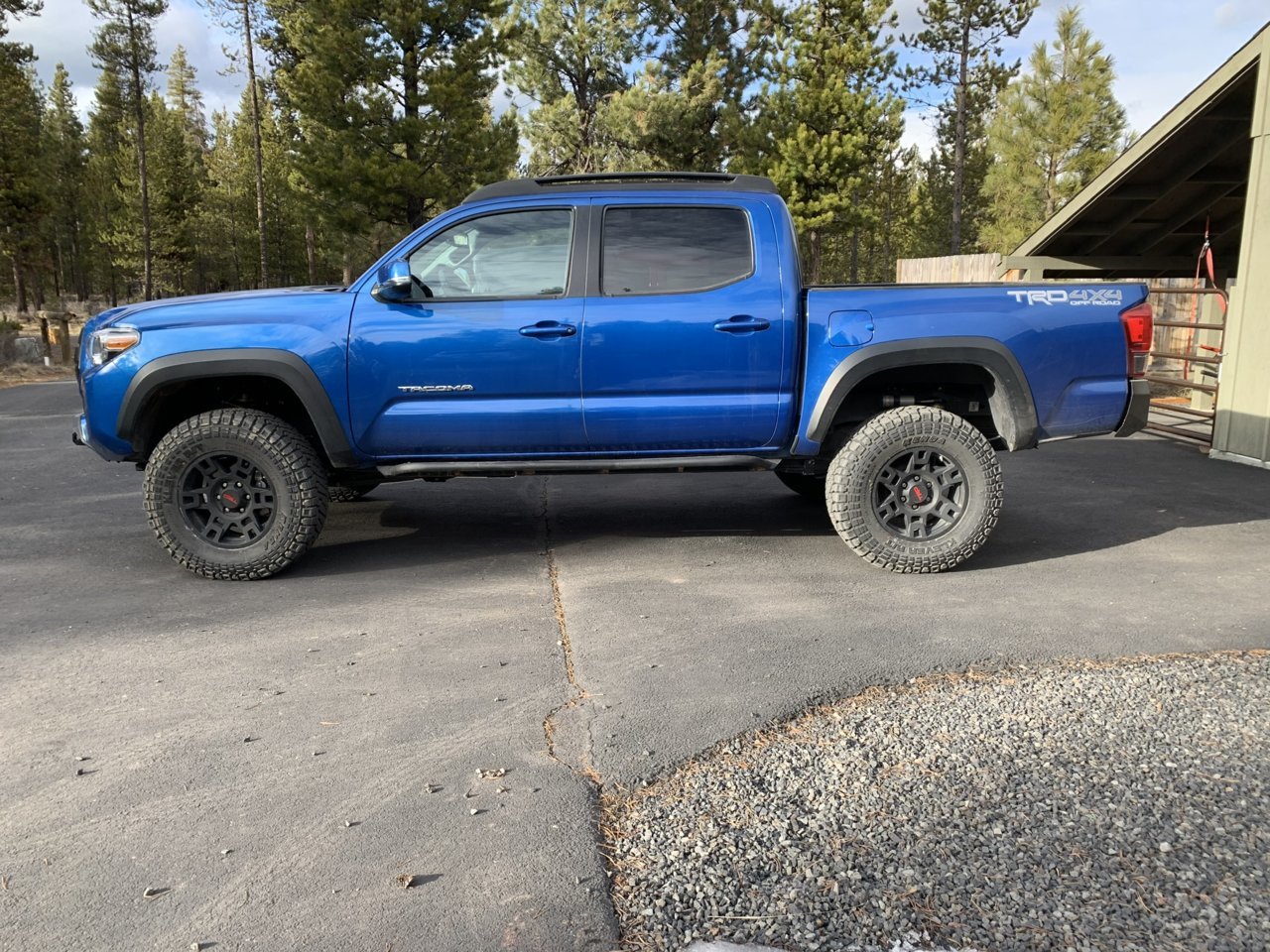

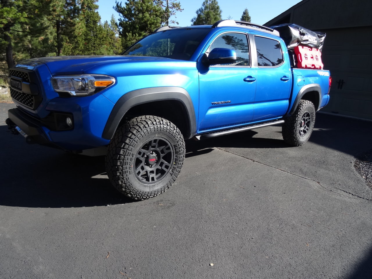

    20931FF5-E635-42CB-A1A1-B7A4DB1689B7.jpg 13893299-5D96-44BC-8648-4DFF0DC1DFF2.jpg B824403A-CC39-4947-B7A7-8BB71919D251.jpg BE1211F3-7BDC-4A7E-9B9E-FC8EB58CBDFA.jpg 88521351-4D17-4A0D-896A-AC99AEC99718.jpg

    Thanks a ton! Love the bed cap btw! Just to confirm, those wheels are +15 correct?
    GladiatorNOT[QUOTED] likes this.
  10. Nov 11, 2021 at 5:32 PM
    #30
    GladiatorNOT
    GladiatorNOT Well-Known Member
    Mar 19, 2019
    #287171
    632
    2017 TRD OR
    Old Man BP51 coilovers Dakar HD leaf springs Icon Delta control arms TRD Pro rims with Kenda Klever RT 33x10.5 tires Exhaust mod TRD front skid, RCI tranny and transfer case skids Southern Style Slimline front bumper Baja Designs S8 bumper light Warn Zeon Platinum 10s winch 4.88 Nitro gears ARB front locking differential ARB twin air compressor X2 Power 27 battery RCI rear bumper with Rigid SRQ lights RCI rock sliders RLD canopy Dometic CFX3 55 refrigerator TRD Pro grill Front & Rear anytime camera Seat Jackers Diode Dynamics Pro fogs
    4mm. Those are the factory 4Runner Pro rims. I believe the factory 16” Taco Pro rims are 15.
