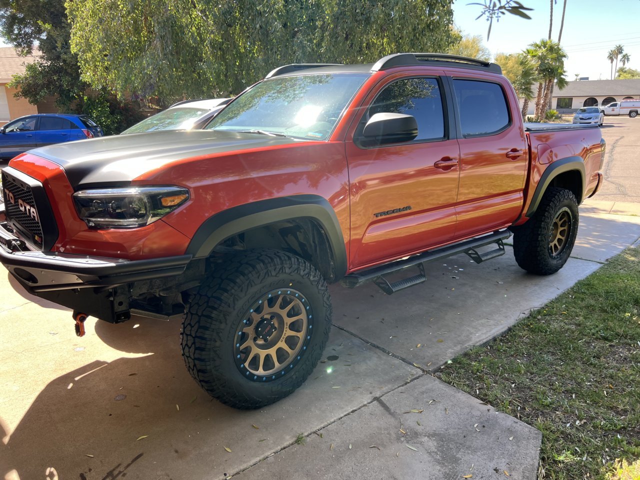

    Running 285/65-18 2 1/2-3 inches of lift with -12 offset 18x9 wheels. The alignment is the key to no rubbing. I did have to trim a slight bit off the inside of the front bumper though before the aftermarket one was put on.
