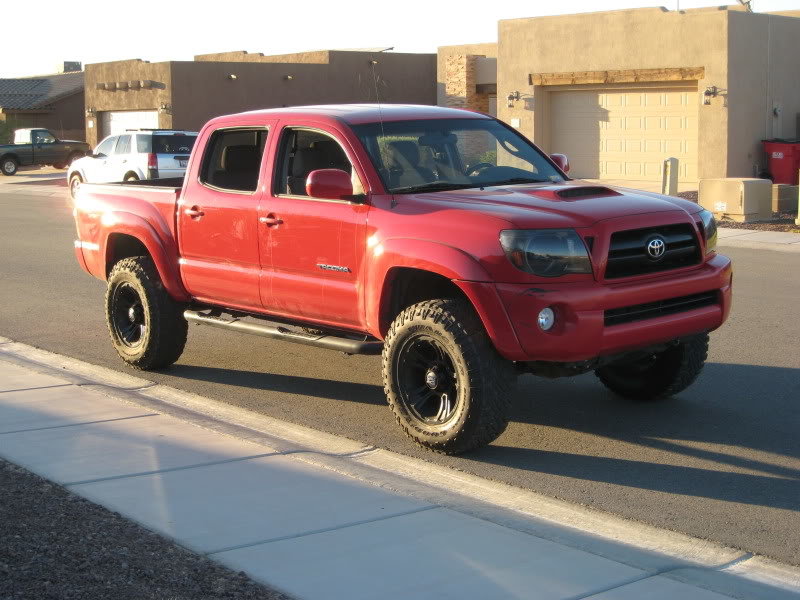

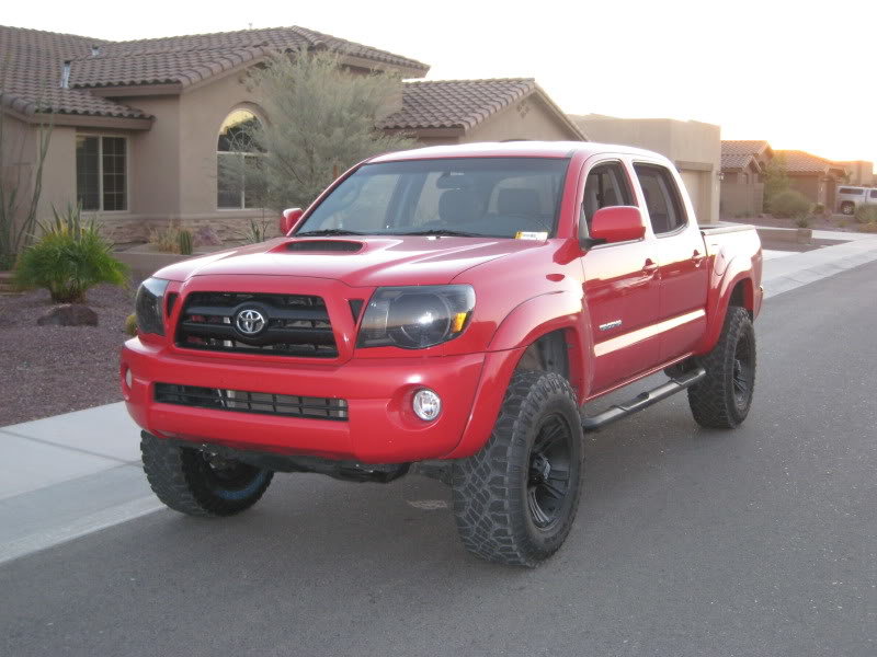

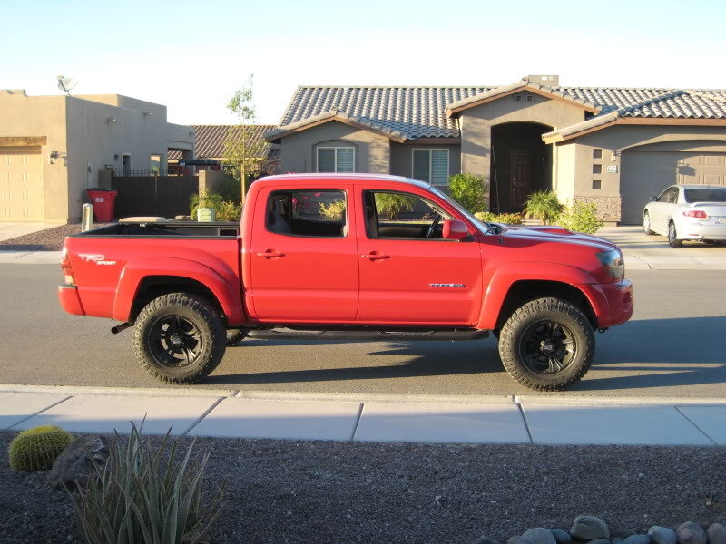

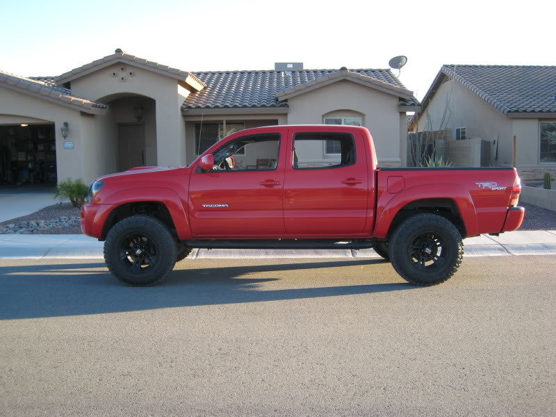

    I actually just got 5100's all around with the ICON leaf pack in the back with 285's. I however set the front to 2.5". I had to trim a decent amount of the fender liner towards the bottom and I still need to trim some of the fender flare towards the inside, about 2". My wheels are 17x9 with 0 offset. It aligned with no problems. Here are some pictures, hope this helps!

    AV8BTacoma - Awesome Truck. I have a RR TRDSport and been trying to decide between the XD Cranks / Revolvers or Monsters....Seeing yours just made that decision for me! I'm on the East Coast tho, so no worries on having to deal with a local clone! ;) BTW, do you have any issues with rubbing on the suspension running 285's with 0 offset and 2.5" lift??

    Thanks a lot. The cranks and lift totally changed the look of the entire truck, much more BA. I don't have any suspension rub, maybe only the slightest rub on the cab mount when going full lock in reverse, and that is only at full lock. I did have to trim a decent amount of plastic though but not a big deal and totally worth it.

    do you have a photo front on or from the rear to see the offset. thanks
