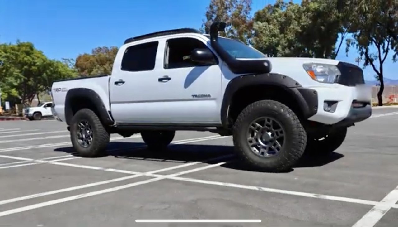

    Those are super cool. Are they hard to install?

    I have mine painted with some form of bed liner (forgot the brand).
    The front flares line up with the holes in the fender so provided you get longer bolts and a washer/nut the flares can be bolted on. I did this in my truck as the stock mounting system wasn’t great.
    For the rears the holes don’t line up at all (except 1) so I drilled straight into the fenders and bolted them.

    what rear roof rack is that?

    One of the most popular, common roof racks that Tacomas usually have... Prinsu. You can see the round logo on the back.

    I meant the rear one on the topper. The basket rack.
