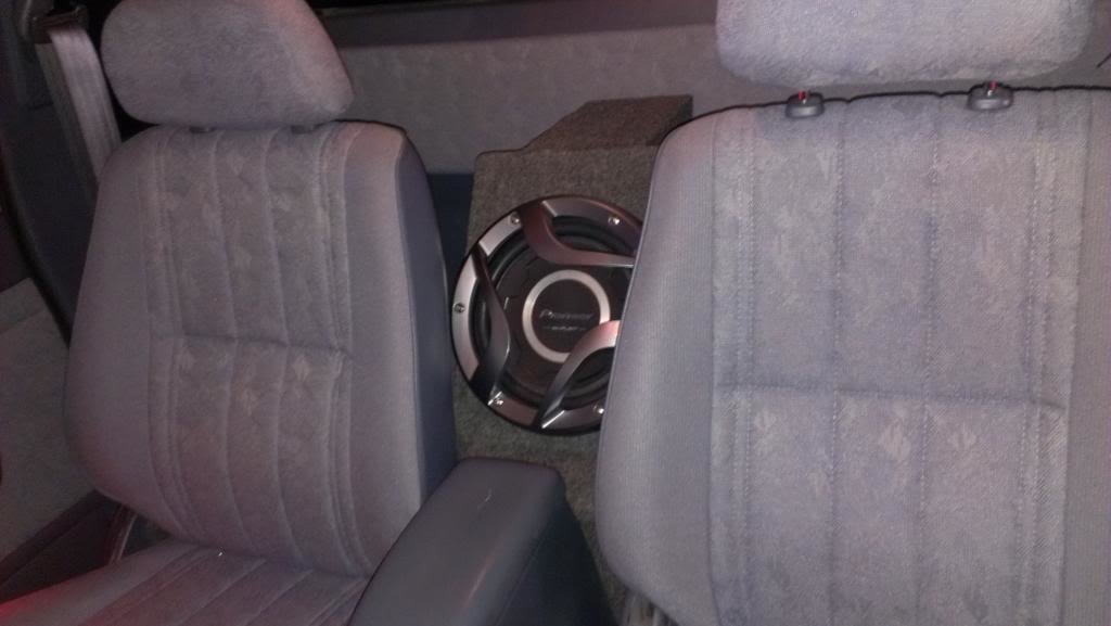

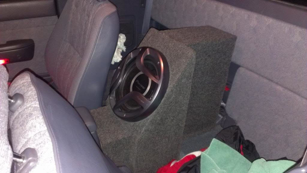

    Wondering if anyone is running different sized subs. They would probably have to be wired to a separate amp (dont quote me on that, idk for sure) but I know that smaller subs handle tighter bass and bigger subs are just for pounding the shit out of peoples eardrums. So i'm wondering if anyone has tried to put two different size subs in their rig?

    Of course not in the same enclosure. But depending on what music you listen to where the bass changes quickly and is not just one or two notes the entire song, smaller subs I think can change notes quicker
