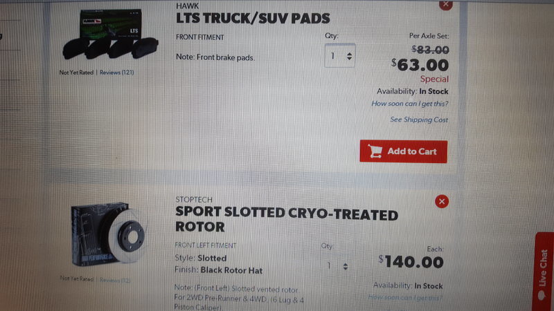

    Here is what I'm looking at. Anyone have a suggestion on better pricing than Tire rack?
