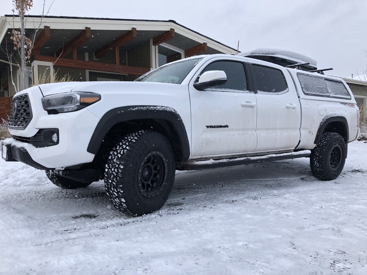

    16x8 w/ 4” backspace, -12 offset Ray10s wrapped with 265/75/16 Wildpeaks. Rubs ever so slightly on the left drivers side when making a rt turn due to the infamous “Taco Lean”. Currently stock height, but soon to be lifted about 2”.

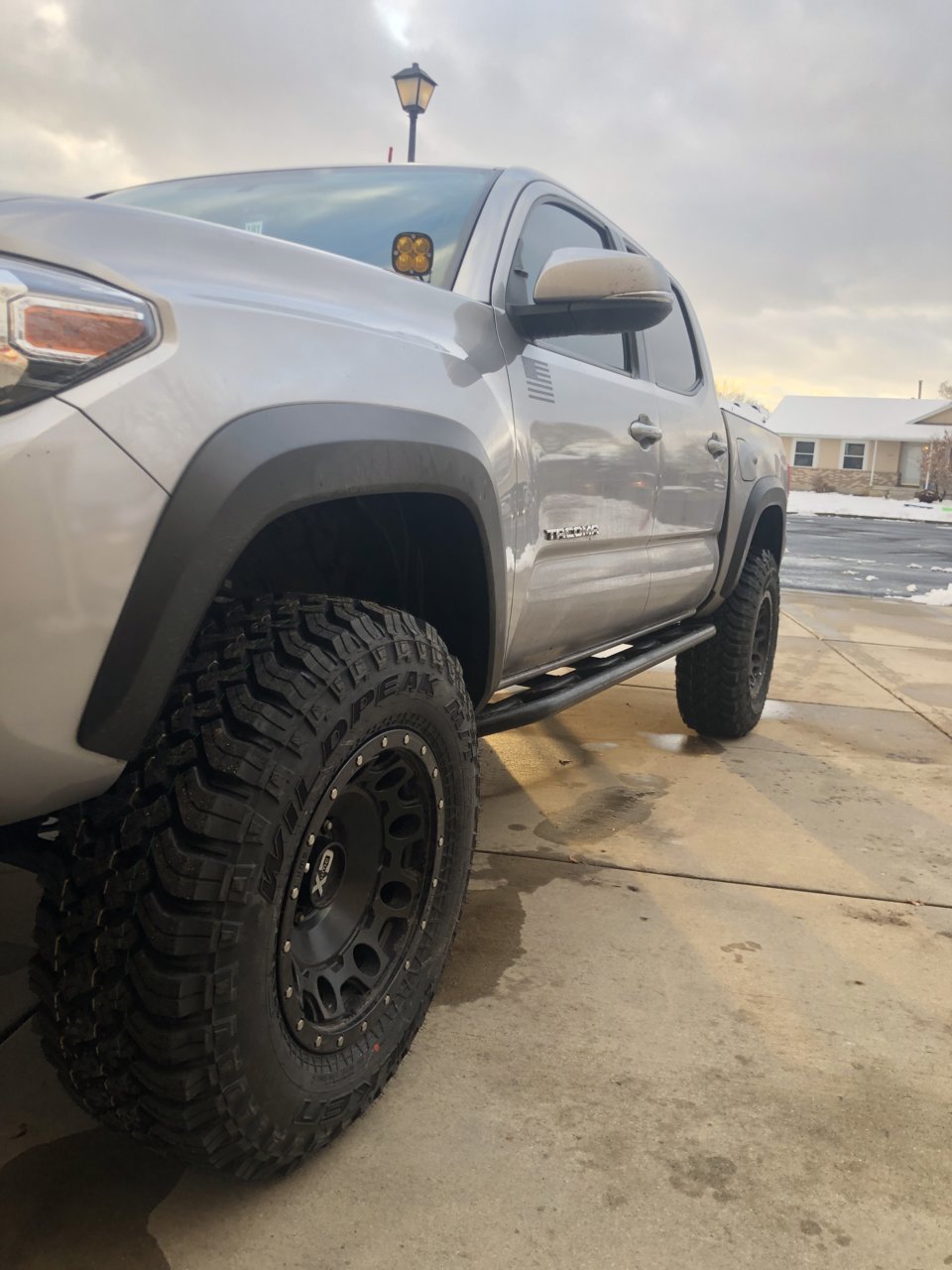

    17x9 4.53bs -12 offset KMC holeshots
    2nd picture is with 265/70s. the other two are 285/70s

    Looks good! It looks like you have a bit of a lift on it, have any rubbing issues?

    Love the look of that setup. Kind of surprised your getting interference with 265's...guessing it's the offset....which is what I was afraid of.

    Yeah it’s the putter edge of the tire rubbing on the inner plastic fender when making a rt turn. To fix it all I need to do is take a heat gun and re-mold it a touch, just been lazy as it’s not that much of a big deal right now.

    Yeah, with my 265/70s I had Bilstein 5100s with 885 coils. I rubbed still and had to take the flaps off. I still rubbed when turning downhill (the weight shifted to one side). I have 888 coils now and so far I have only slightly rubbed in reverse while goin quick. (I did CMC for these tires tho)
