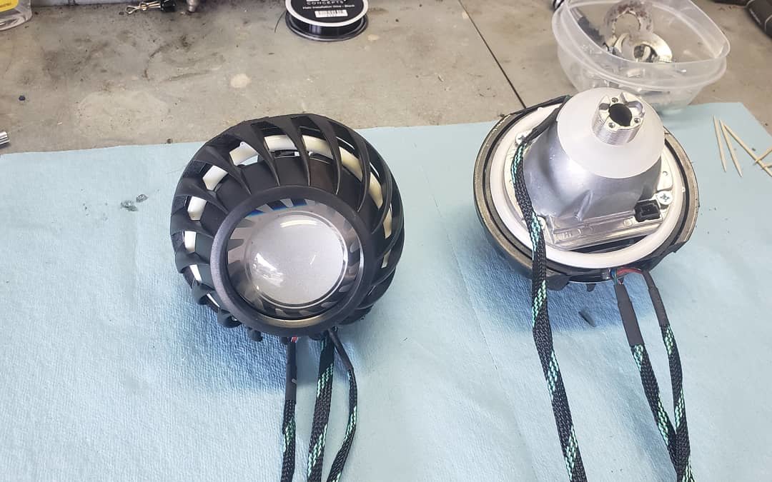

    TRS has a good discount right now. From what I'm reading in this thread, it looks like the Mini D2S bulb is one of two of the only bulbs that will fit 1st gens. Do I just install the projector and shroud inside the existing headlight housing? Is this legal in CA or can I get a ticket?

    He's got the bigger fxrs on his in that vid. You open the headlights and instal the projector/shroud and then reassemble the lens on the headlight

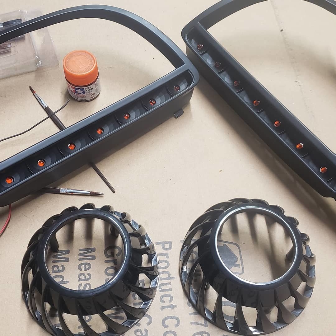

    I did black... but I was blacking out the inside of my housings.

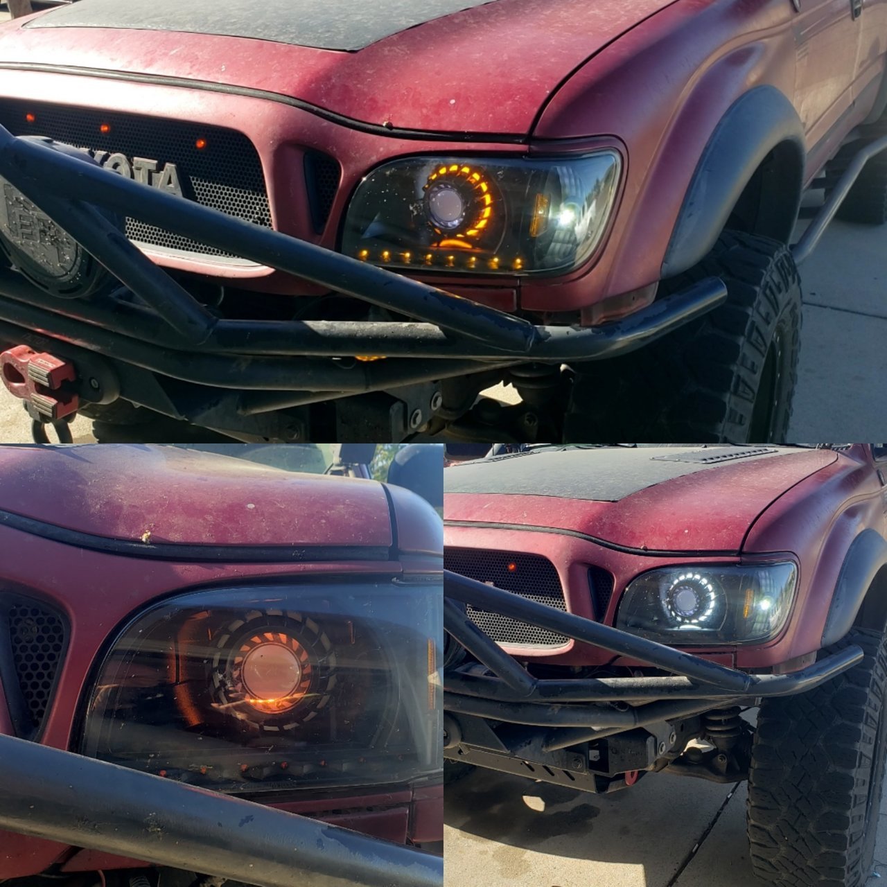

    What images are the ones where the low beam is on? High beam? I want to do what you did in the bottom right, in chrome, with a blue halo. Would the halos still be on when my headlights are shut off during the day?

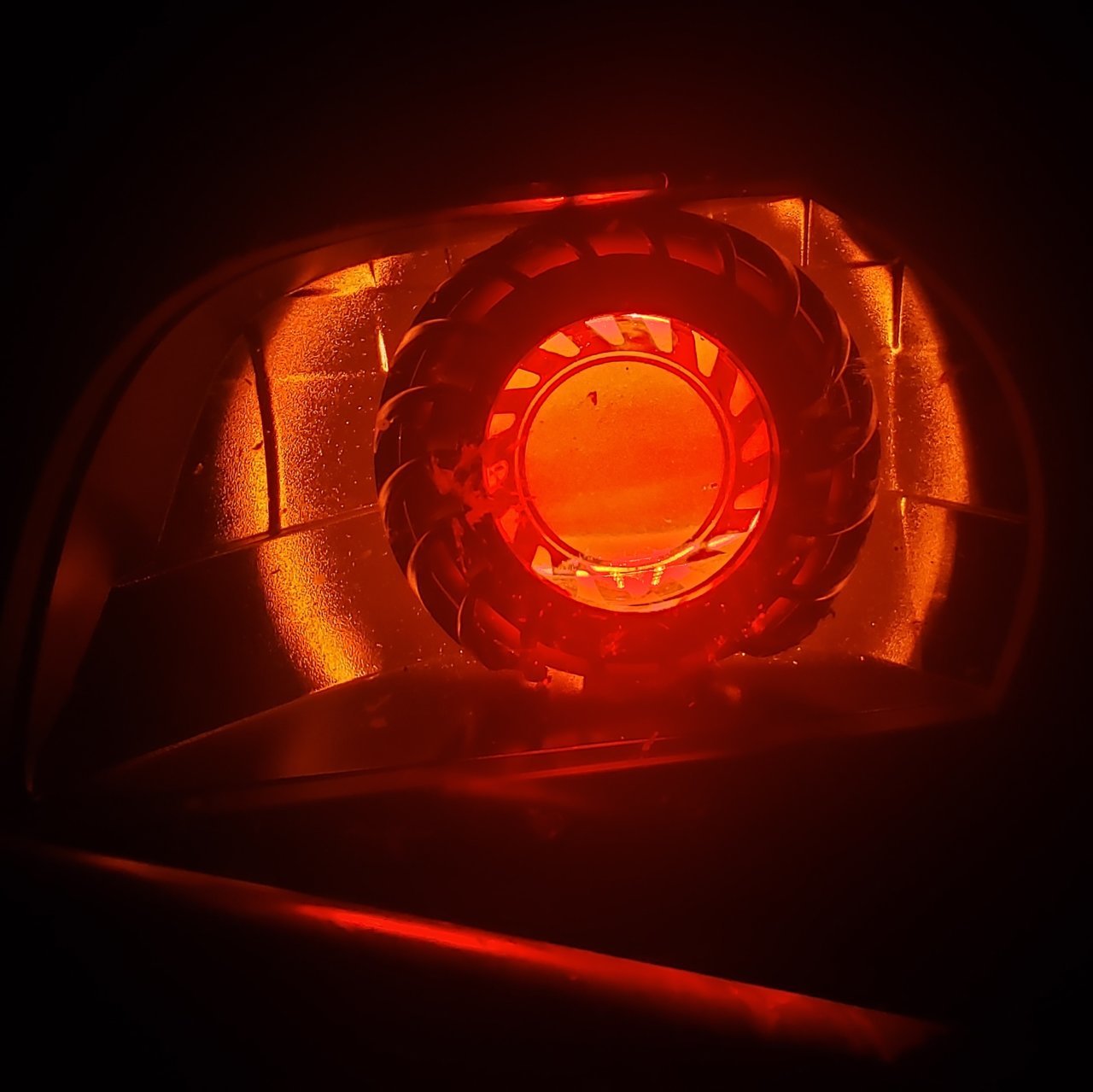

    Bottom right is running light. (I have clipped the day time running light wire so I can turn that off) With headlights fully on, the center gets brighter.
    Bottom left is just demon eys on.
    Top is signalling. The halo that is white in the bottom right pic is a switchback halo that changes to flashing amber when the signal or hazards are used.

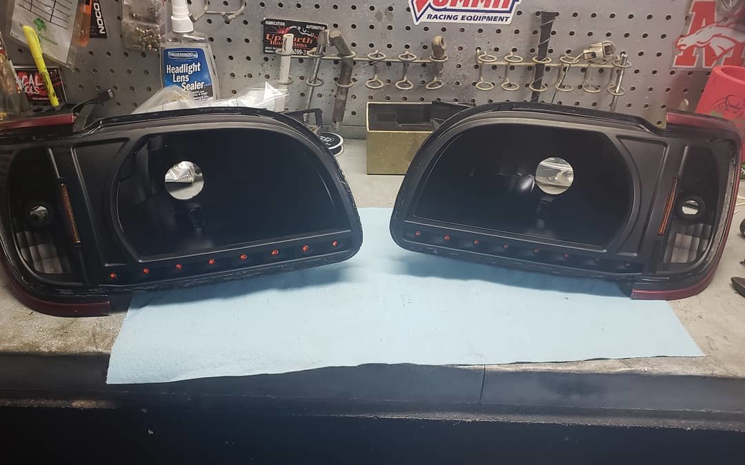

    I’m having a hell of a time getting my lens off the housing. I have some aftermarket housings from Amazon (not TYC). I broke the lip all to hell trying to get them apart. I followed TRS guide and use the “tool”. Hoping it’s just my cheap housing.
    Any advice on taking the housings apart on the TYC?

    I just did that a a couple weeks ago with TYC housings. I preheated the oven to 175 (I think. Whatever TRS recommends in their install guide) and turned the oven off. Put the lights in for 10 min or so and used a few difference sizes of flat head screwdrivers to pry it open.
    I’ve had good luck using a heat gun to heat up the sealant when installing the lens back on too for what its worth.

    Also I think starting at a corner seems to be easier.
