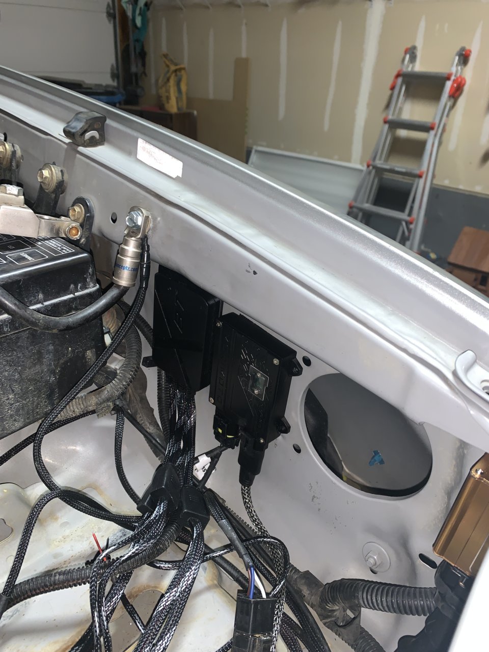

    Definitely a lot to tuck away. You remove the battery and intake box to get in those areas?

    Yes, more stuff on the driver side
    plus, people don’t realize that for every halo, demon eye or strip you ad, there is a little driver to go with it the should be mounted.
    I’m trying to clean everything up with wire loom and zip ties so it doesn’t look like a rats nest under the hood.

    that’s exactly where I mounted my ballasts

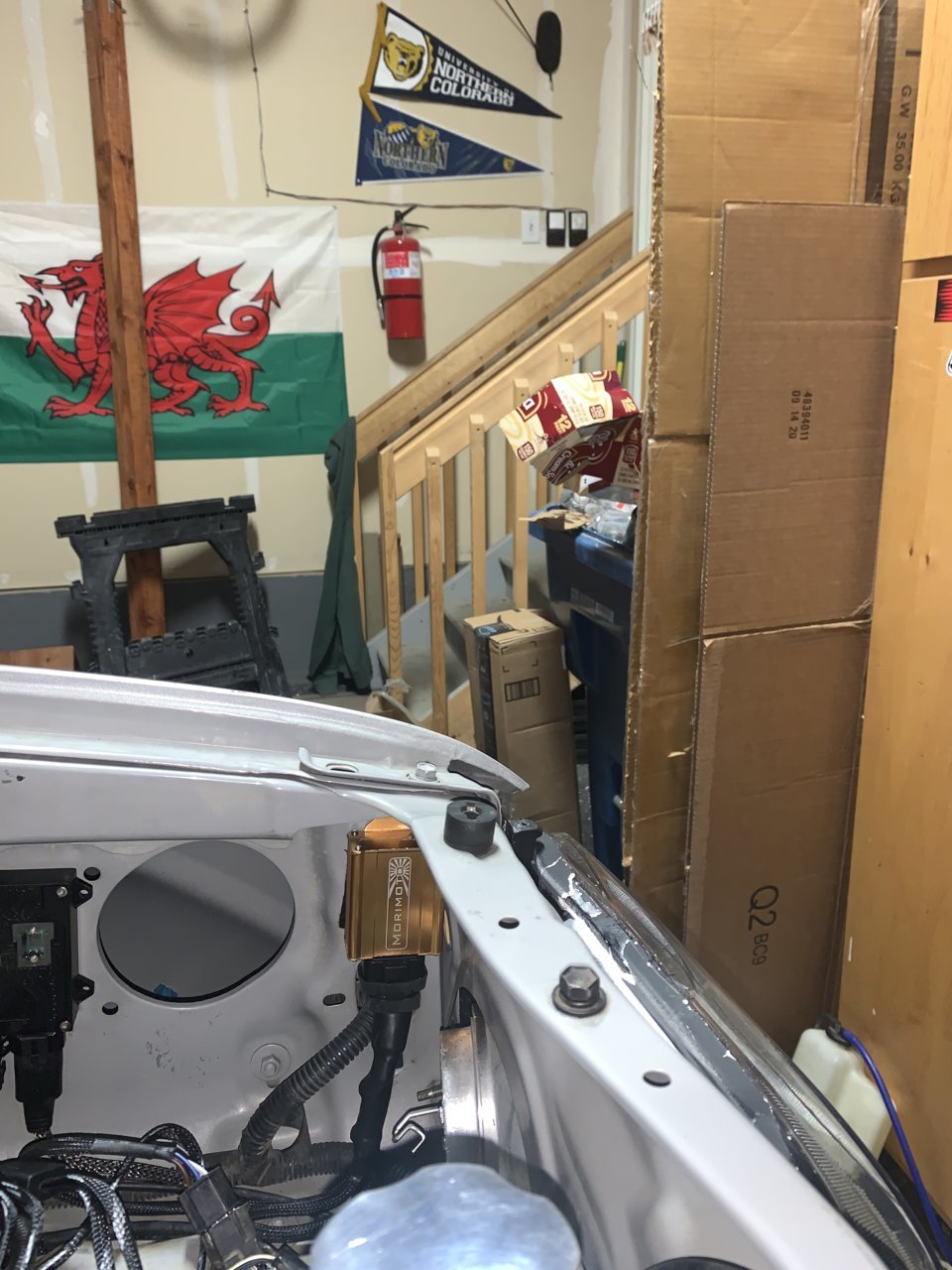

    What about the passenger side? The wire doesn’t seem to reach to put in the same location on the other side

    Whats the box closest to the battery?

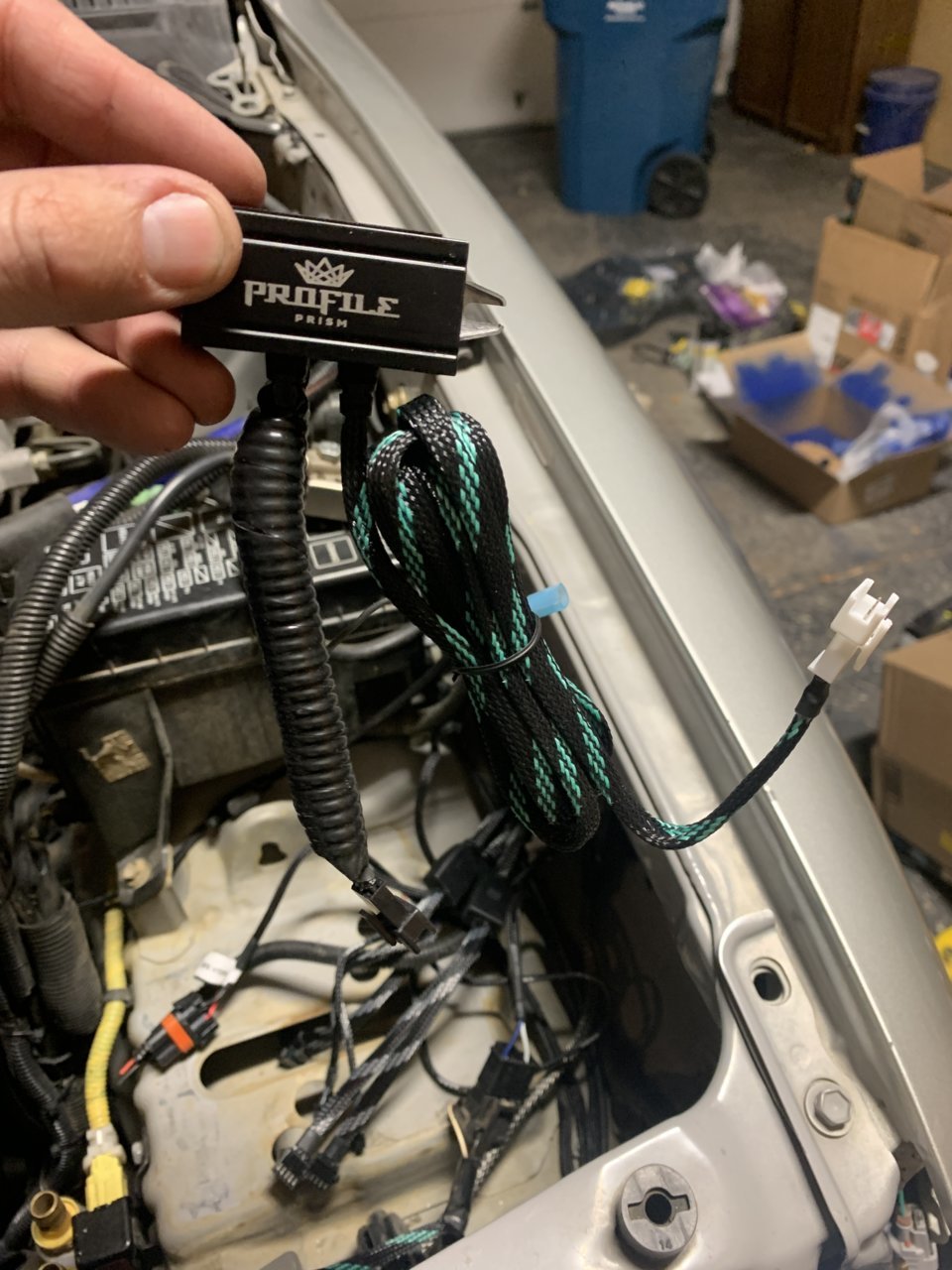

    Bluetooth controller/power supply for Demon Eyes and Halos

    Pretty sure I put it right by where the air intake goes through the fender...I think. It’s been many years since I did it though
