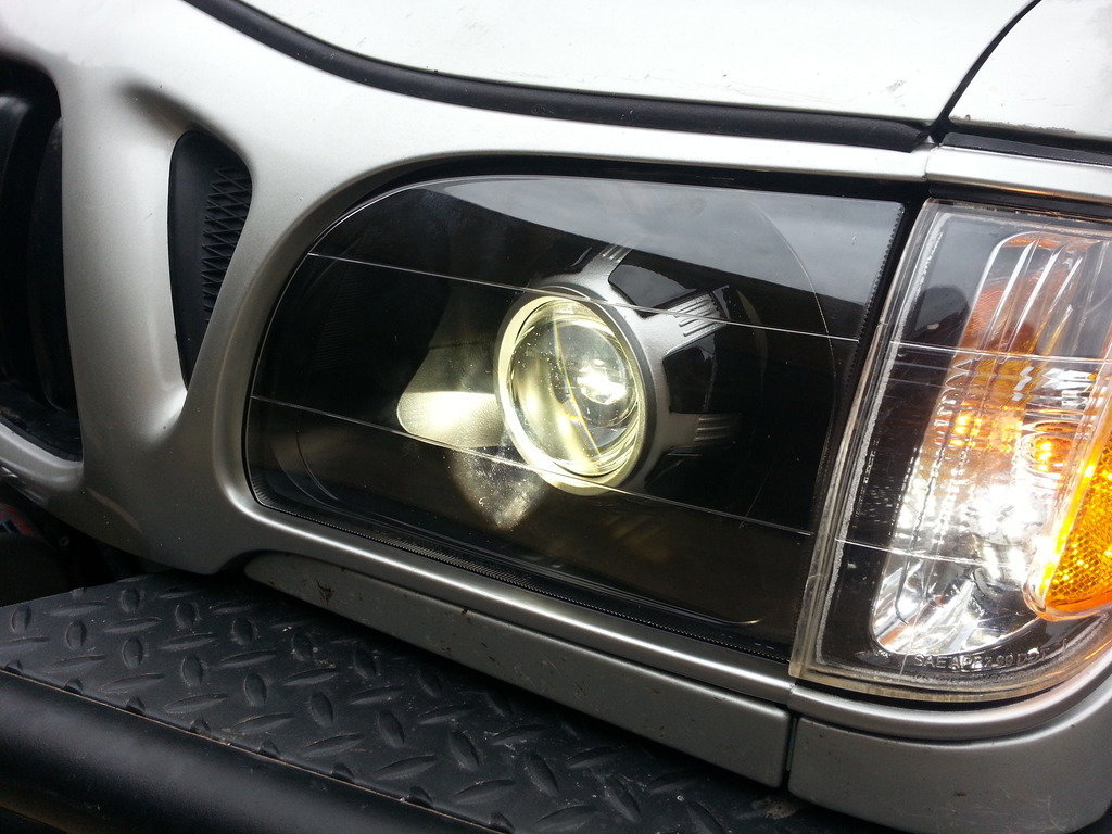

    I don't think mine does. But you can easily tell they're on from the light output. Think there is a cheap module that fixes it.

    Yes, the high beam indicator works fine
    Go right ahead, I think it looks great. The metallic flakes in the silver grab sunlight well and makes them pop pretty good for not having halos

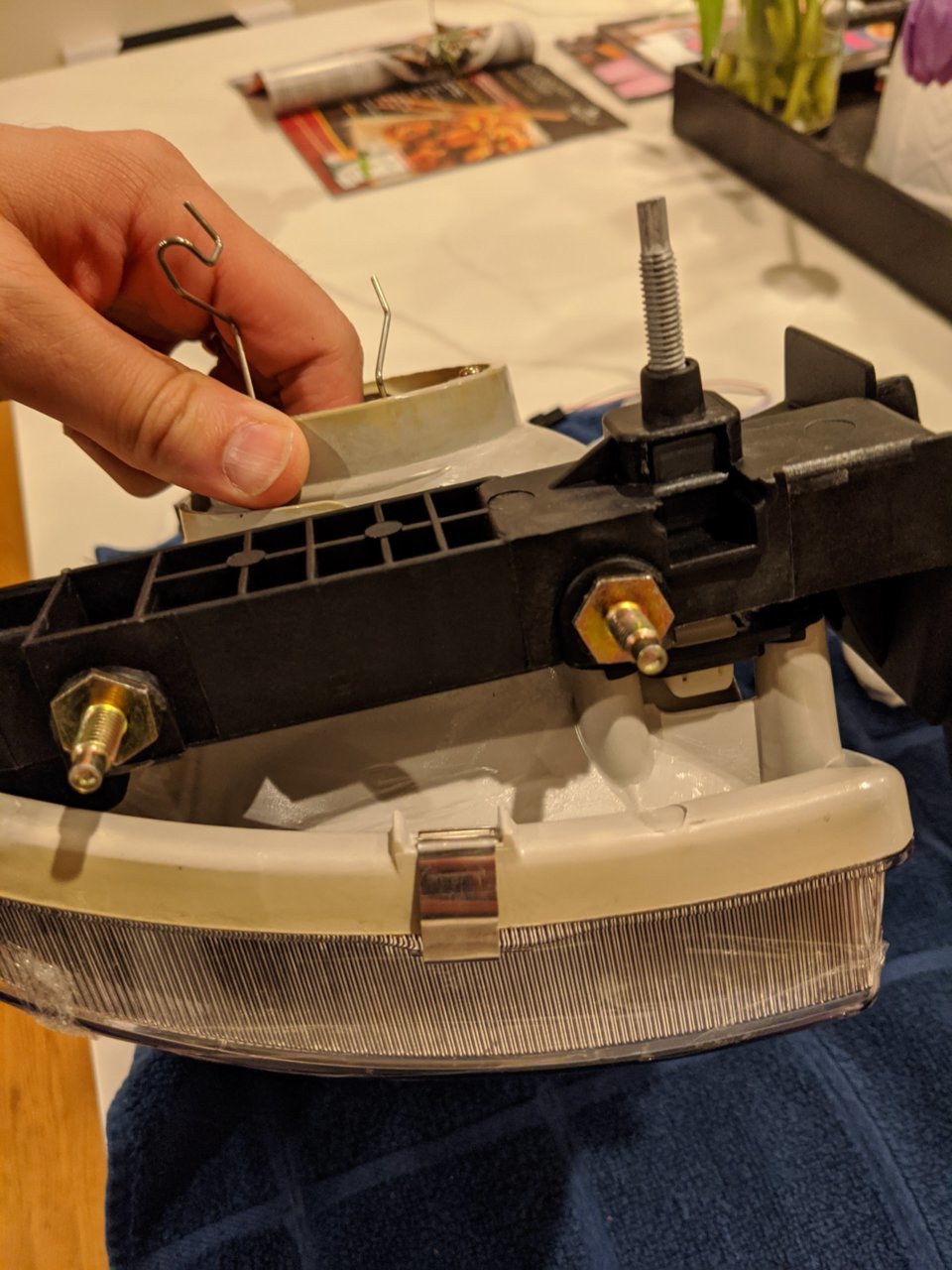

    The 1995-1997 have a smaller type bucket 5x7 and the D2S type are hard if at all able to fit in.
    The mini 7.0 will fit tho in the 7x8 headlight buckets
    Low beams here below,
    Not the best picture but an idea

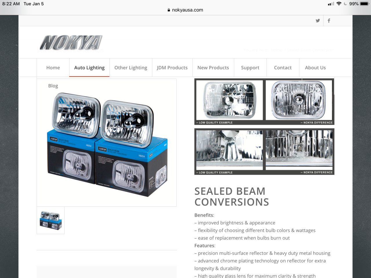

    These are the ones I use,
    They are metal buckets and glass lens the best quality,
    But harder to work with because they are metal but well worth it.
    No plastic lens to fade or dull or wrap

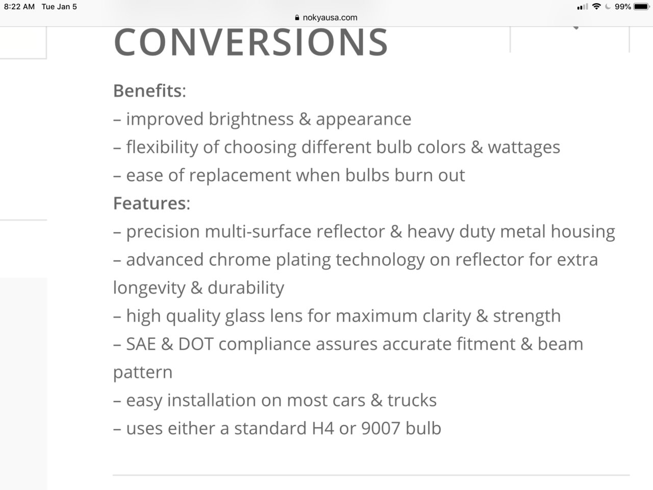

    I looked all over the place for the pilots because they had the long tail section that would not need
    cutting up but could not fine them anywhere,
    The Nokya make a glass lens and a Polycarbonate lens.
    I’m happy with them (glass) but they were a pain to get the mins 7.0 to fit.
    Sirius out of Taiwan actually makes the Nokya headlight,
    Glass will not yellow or get dim looking,
    Personally choice
    http://www.ns-sirius.com/products.php

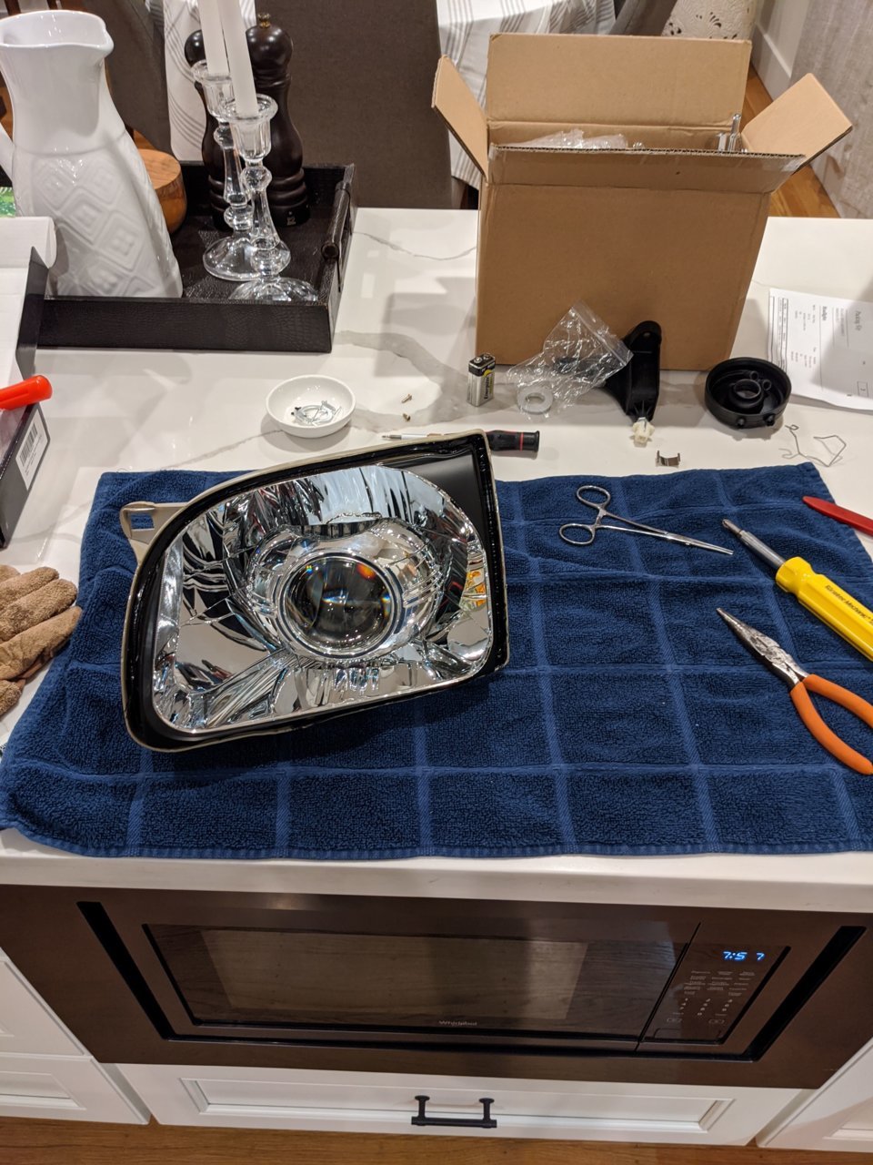

    Here's what I did, and have done in the past.
    Get yourself an extra set of headlamp assemblies. If you get ticketed, you can swap in the old reflectors and fix your ticket, only to swap them back. I'm sure all retrofitting is illegal, especially in California where I live, but it doesn't stop anyone, does it? You'll need to stick them in the oven to melt the glue that holds the lenses on. It's a very easy process.
    https://www.ebay.com/itm/Fits-01-04...r-Halogen-Chrome-Left-Right-Set-/382669197408
    Get some projectors and shrouds. Yes, I was surprised that these 3" projectors did fit:
    https://www.ebay.com/itm/Automobile...hrouds/322629378416?ssPageName=STRK:MEBIDX:IT
    You'll need a wiring harness:
    https://www.ebay.com/p/18020361670
    And an adapter if you're going to run LED lights:
    https://www.ebay.com/itm/9005-9006-...ter-Wires-For-Projector-Retrofit/380885187533
    And also some LED lights:
    https://www.ebay.com/sch/sis.html?_...+2019+New+Gen+of+HIKARI,+H1+&_id=273910605225
    They work.
    If you have a 1995.5-1997 Taco that uses the H6054/5x7 headlamp assembly, you can reference what I've done on my 1993 pickup here:
    https://www.toyotaminis.com/forum/threads/h6054-projector-hid-retrofit.23158/
