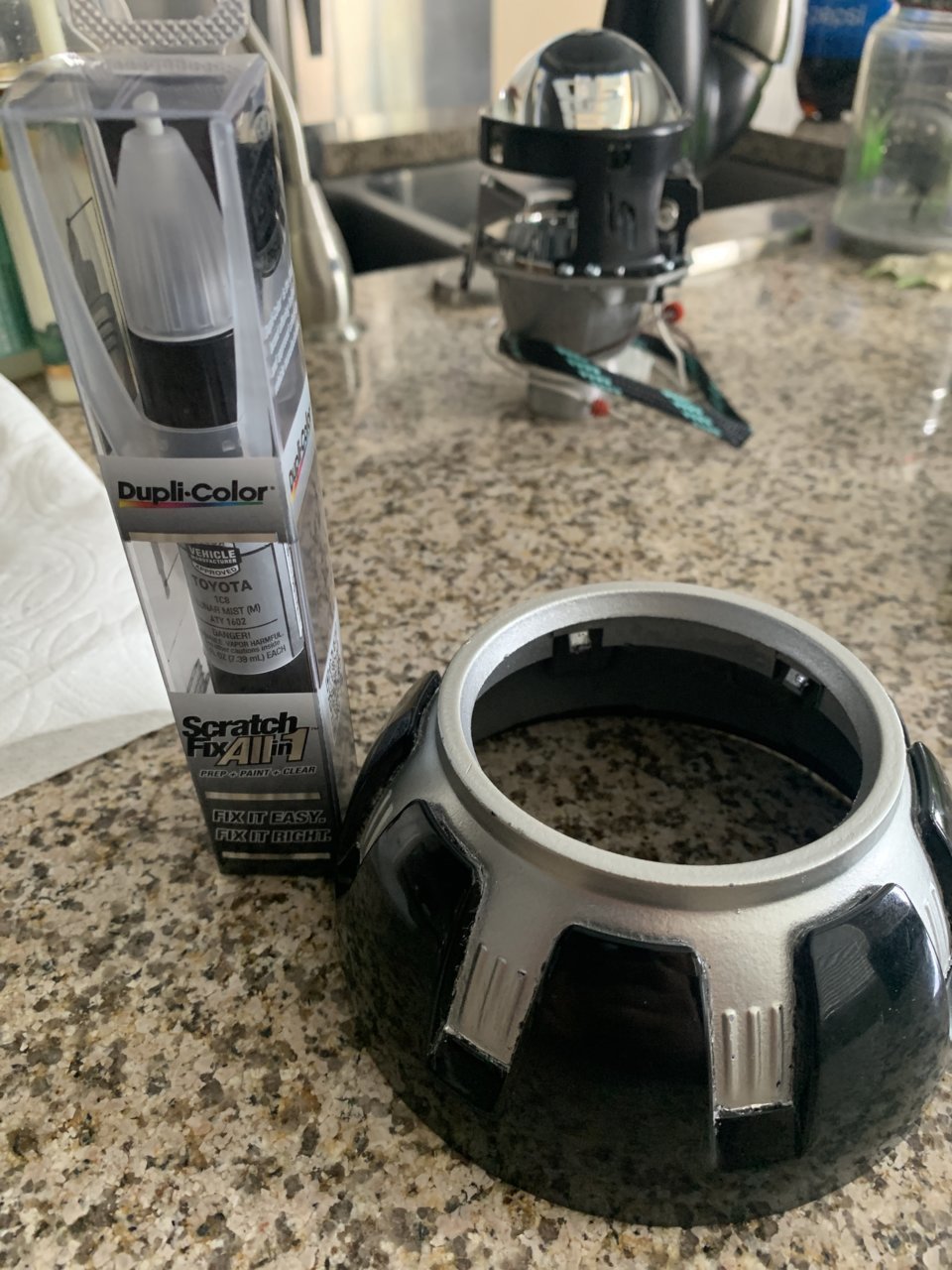

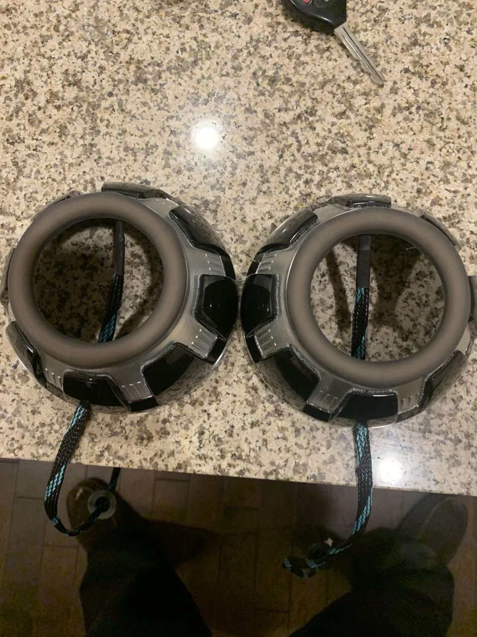

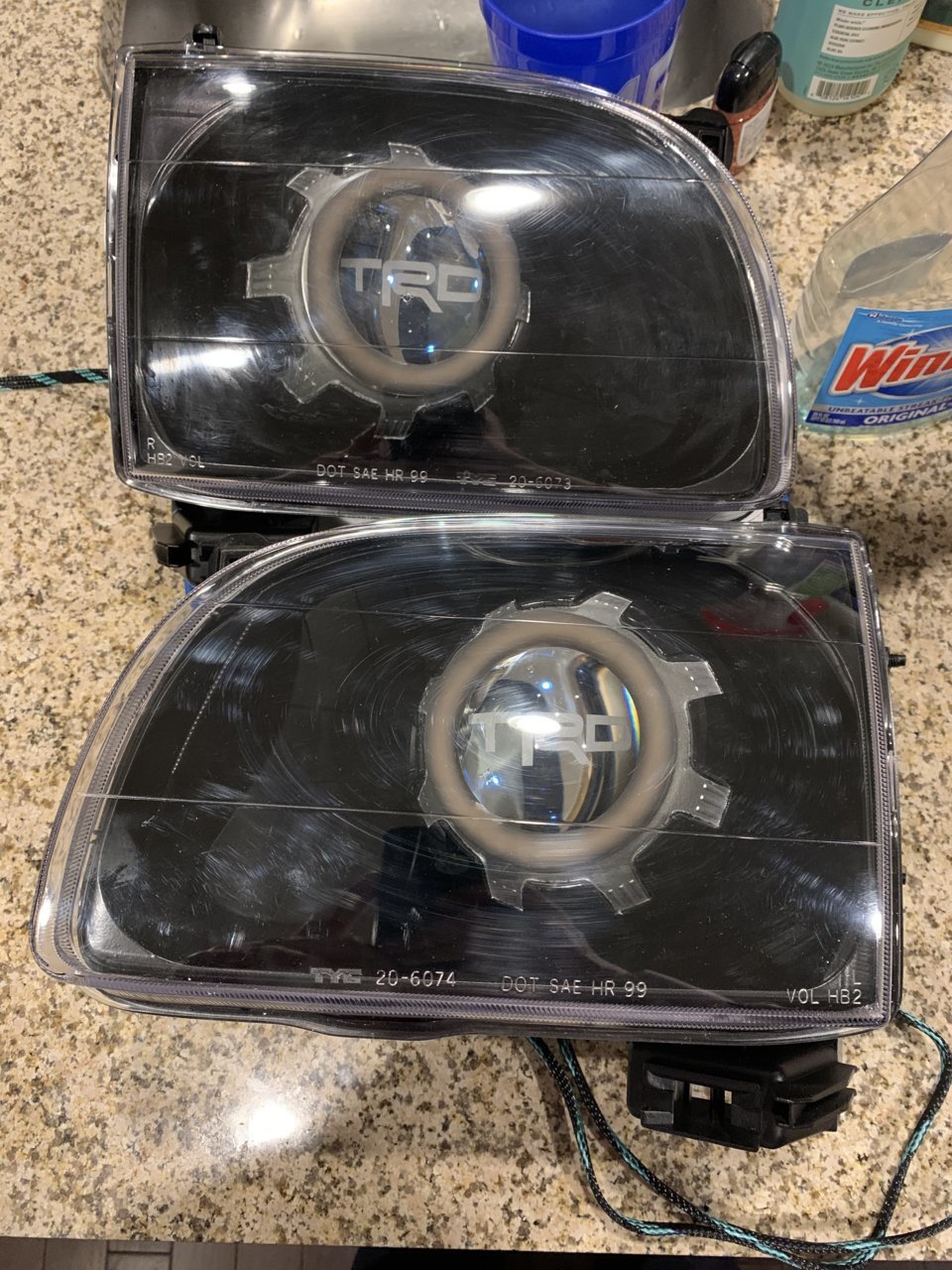

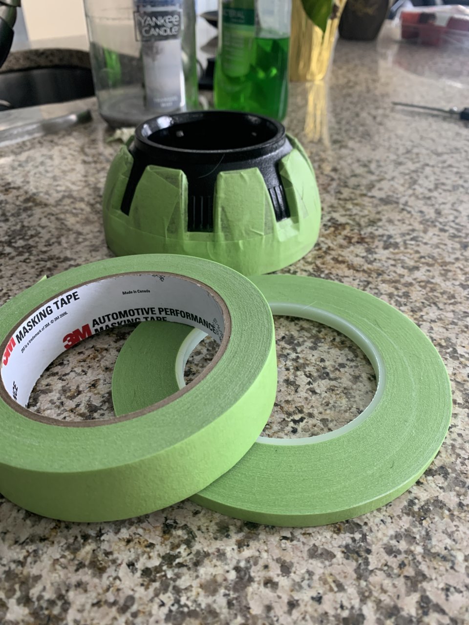

    using better tape on second shroud

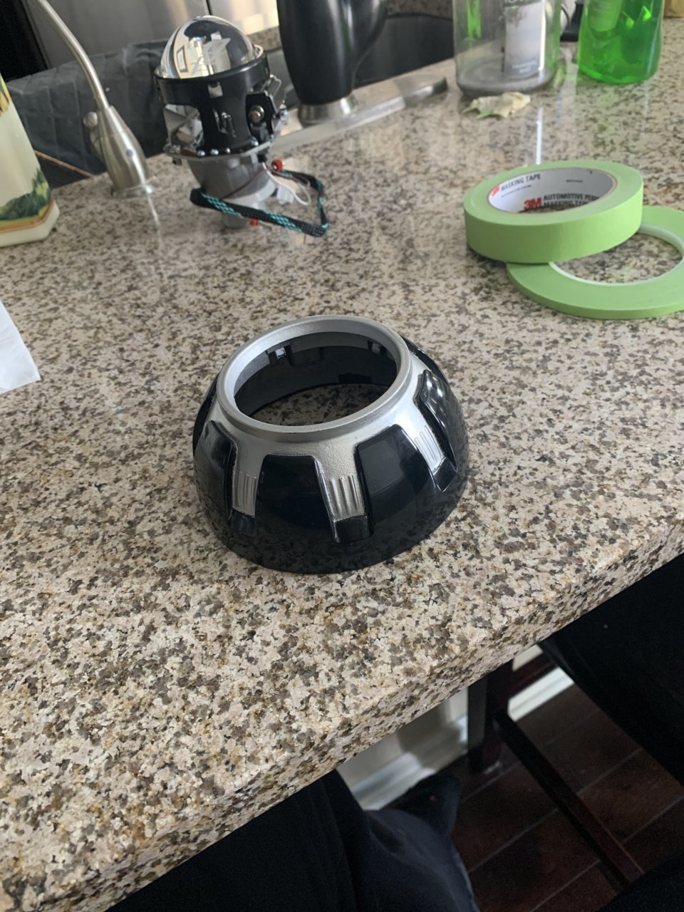

    touch up paint for first shroud
    touched up
    I think this is as good as I’m going to get given my painting skills

    Man, you’ve got those looking great. I think I painted mine all silver first, then taped off for the black.
    And for the two having the pissing match, I have the feeling one of you is the type of person who volunteers for the HOA to enforce the neighborhood grass height requirement at the houses in your cul-de-sac. If every part installed on our trucks was DOT approved and that was enforced, we’d be in the same boat as the aviation industry. You don’t want that. It is possible to be non DOT compliant and retain a stock (or higher) level of safety.

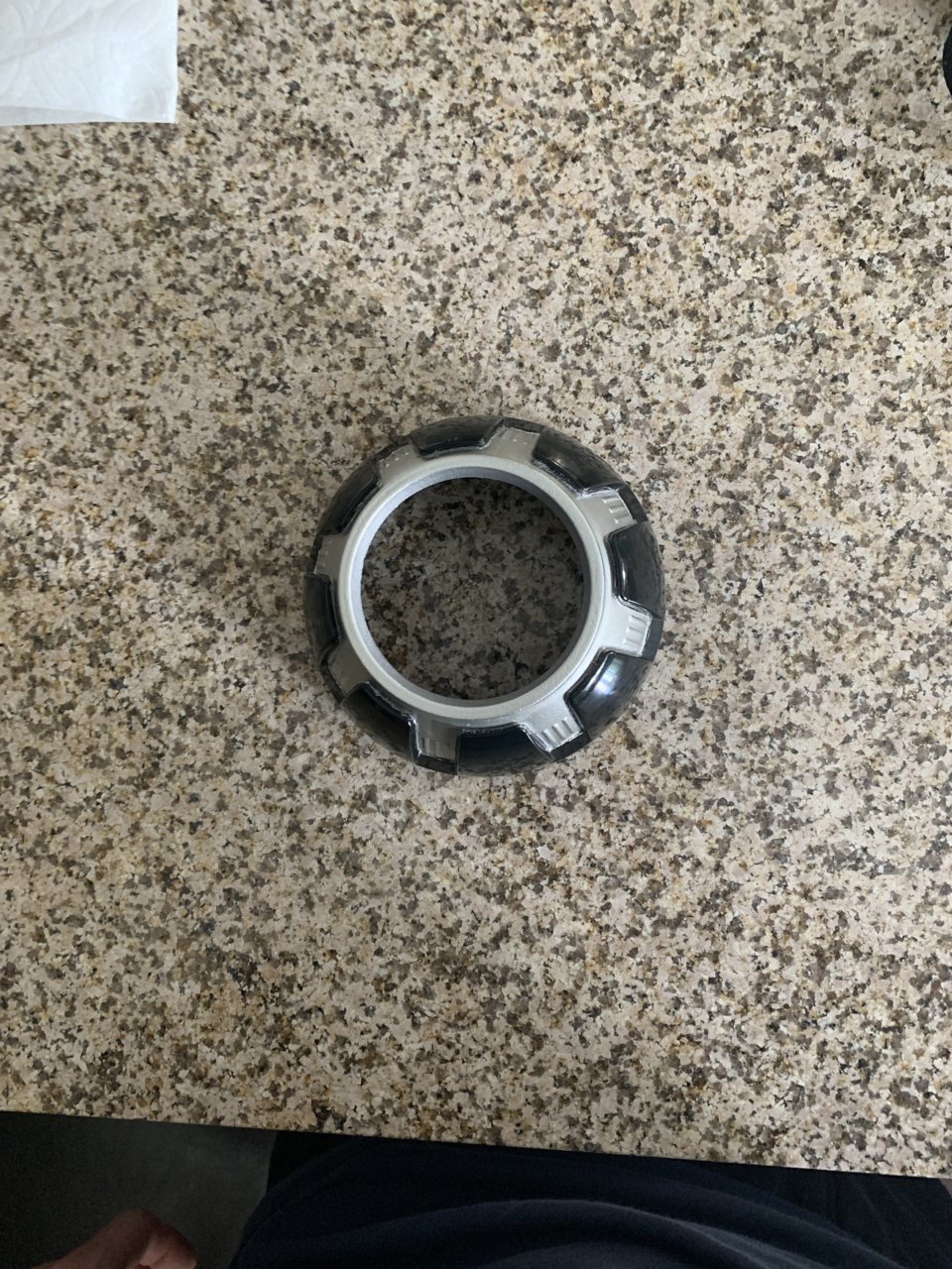

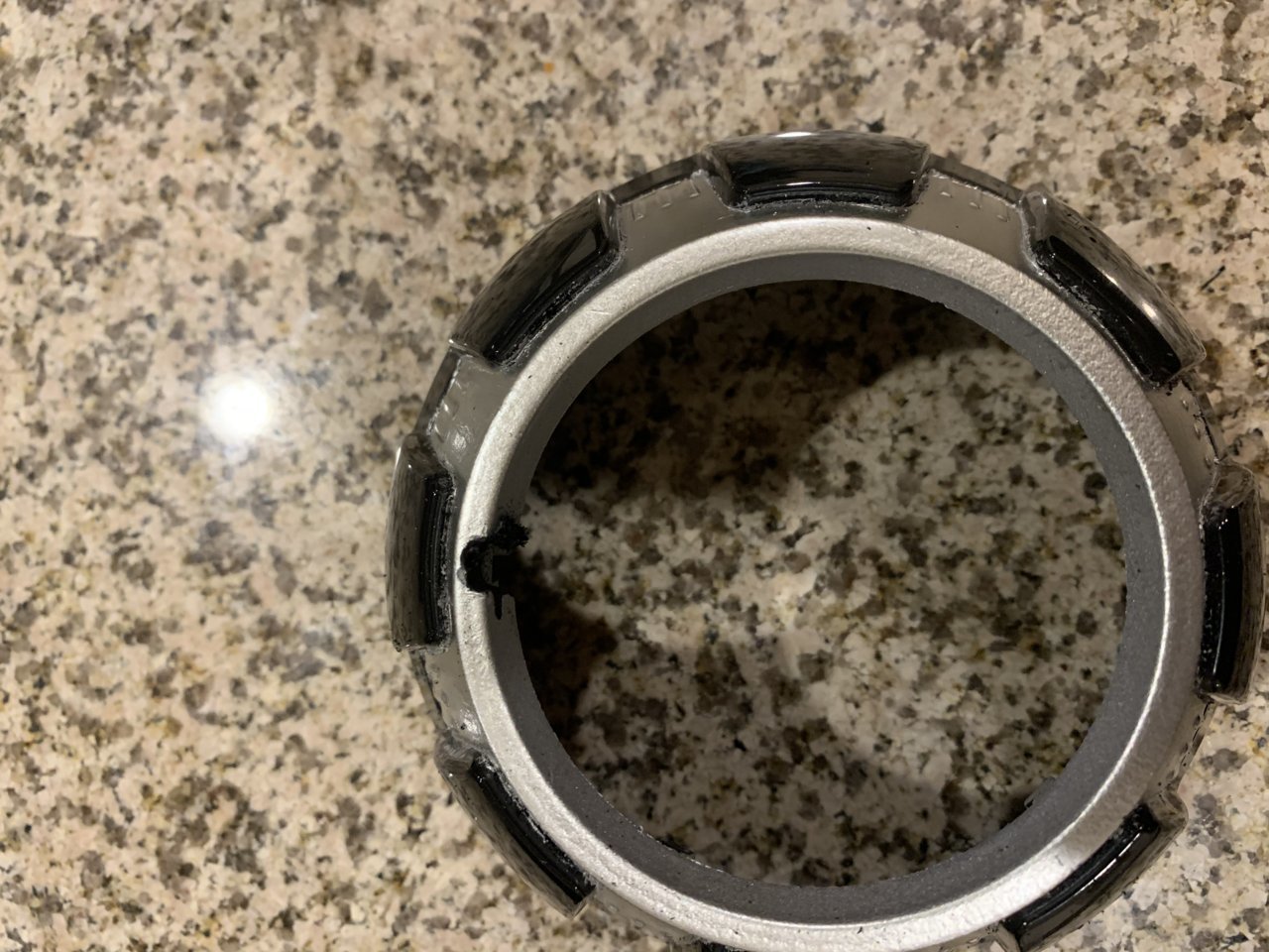

    I used easy off to remove the Crome
    They were black underneath
    Did you trim the back of your Orbit shrouds?

    I tried that, but the tabs melted so I need another way to do it

    I just scuffed them and painted, I didn't strip the chrome. Yes, I trimmed the backs a little bit.

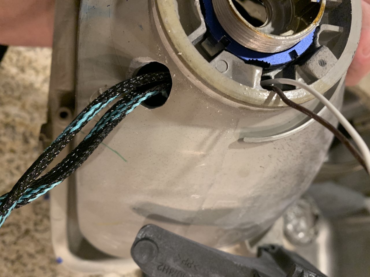

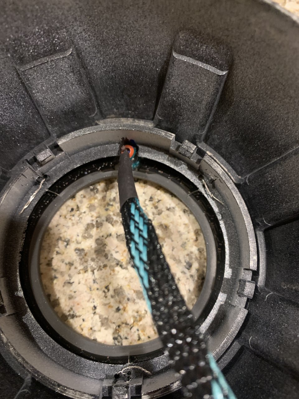

    I tighten mine down without trimming and they seemed to be ok
    really tight and scuffed off some of my housing bucket Paint, but You can’t see it when the shroud is in the bucket.

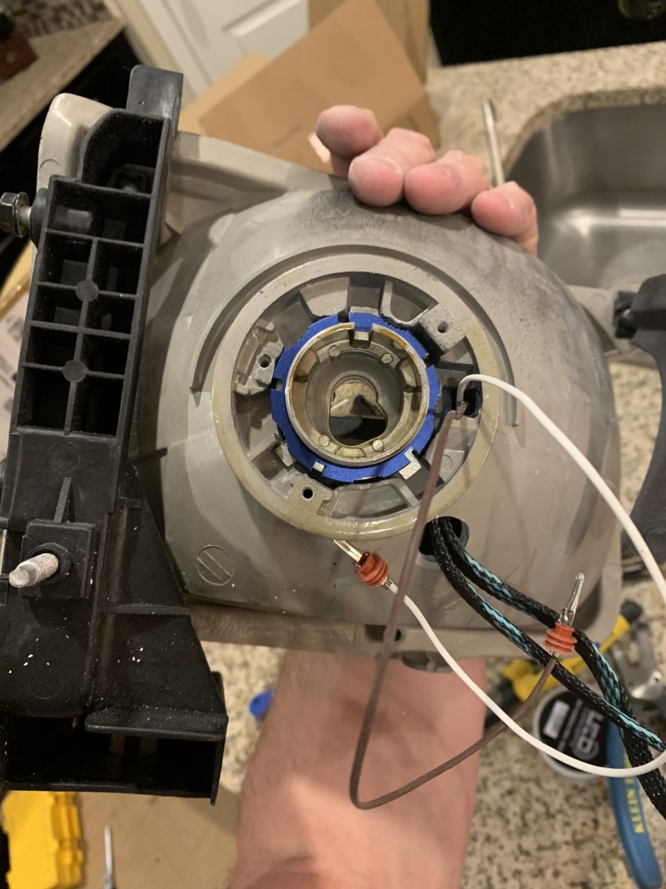

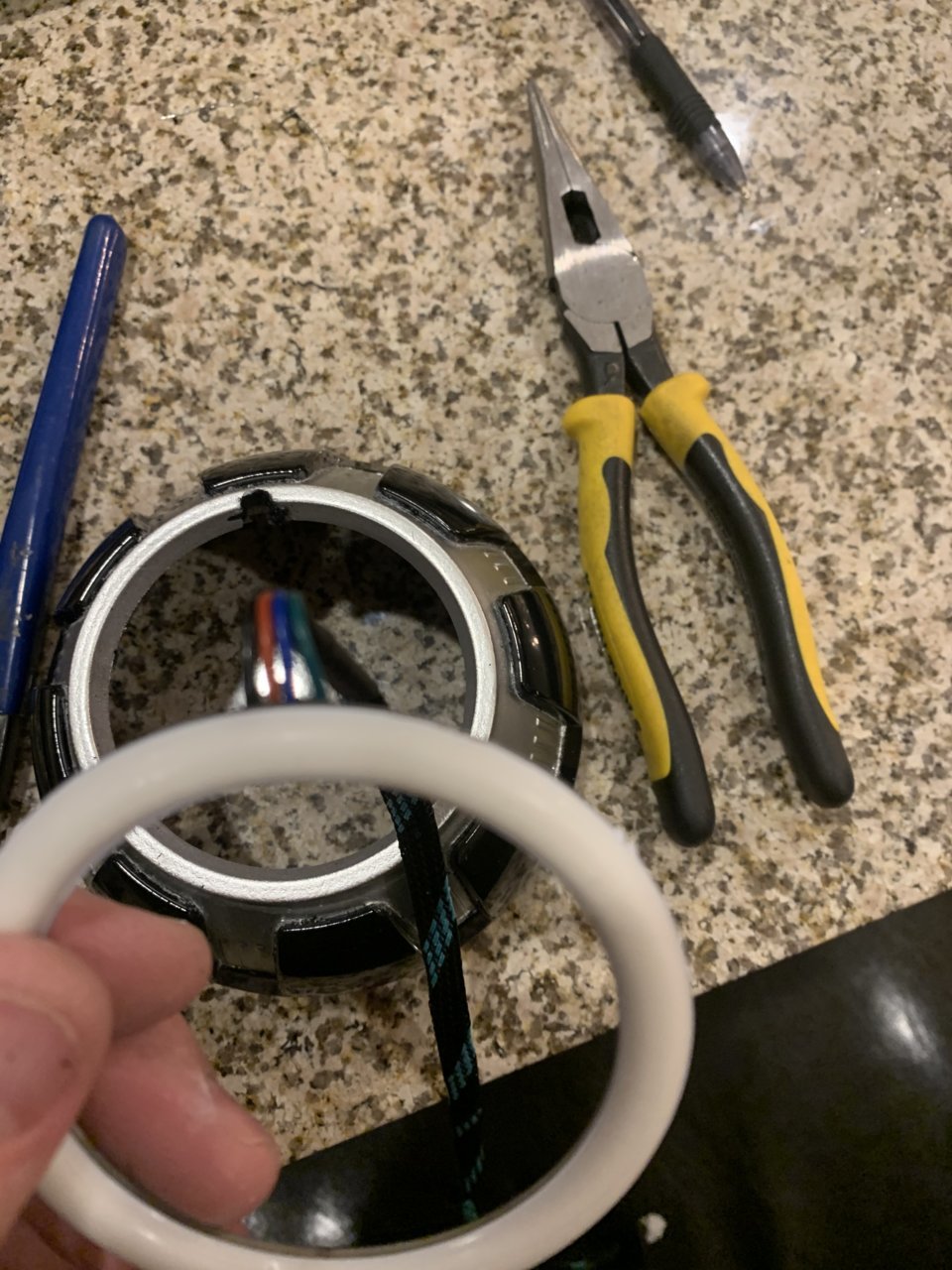

    Did you do demon eyes?
    Trying to decide how big of a hole to drill in the back to run my wires for the demon eyes
    Of course there is nothing online

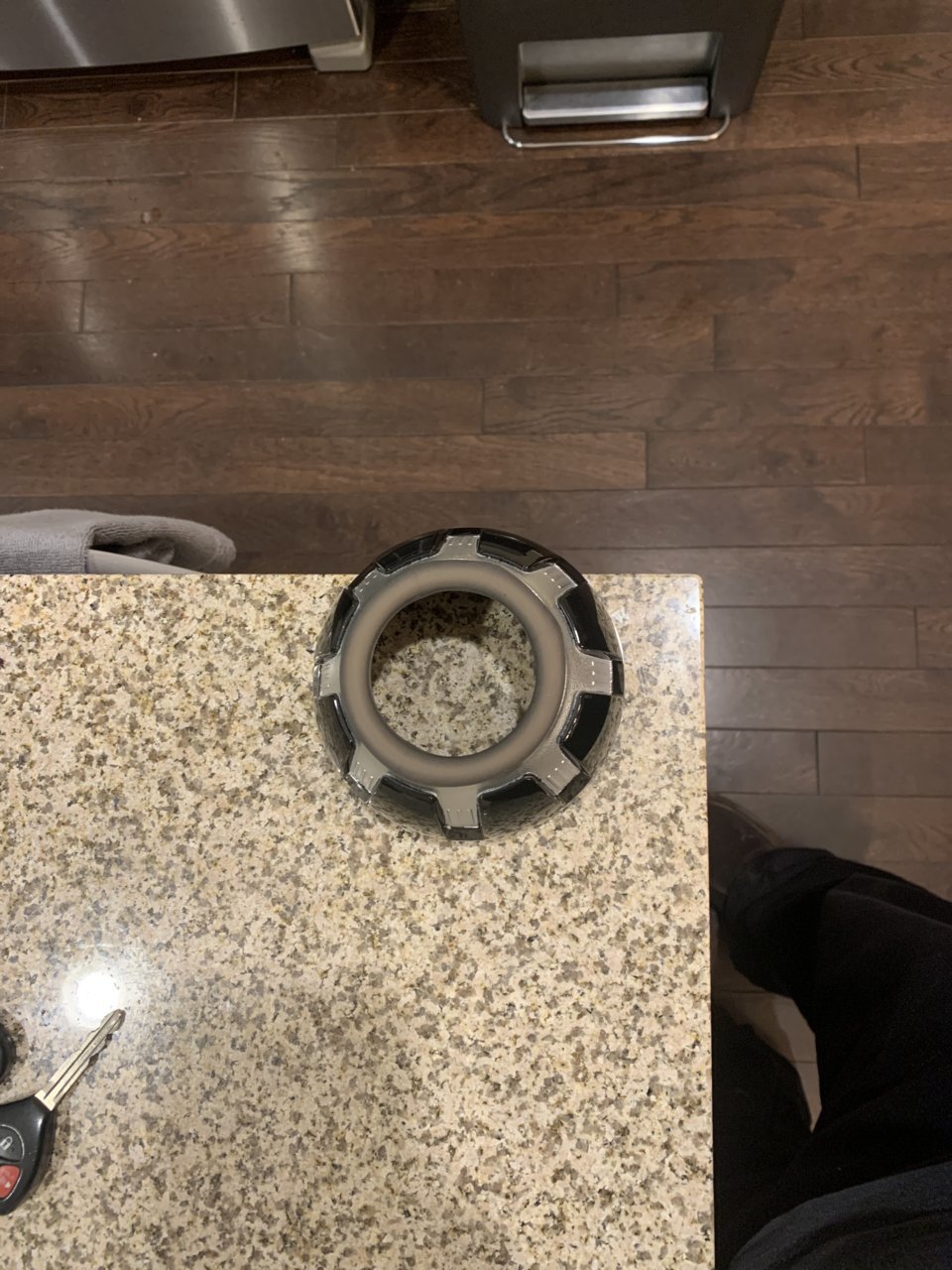

    Halos
    Dusty from cutting

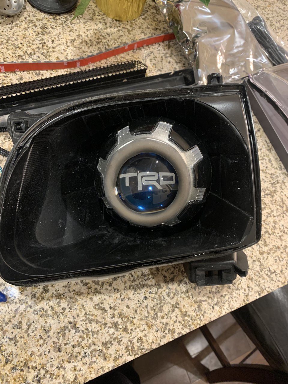

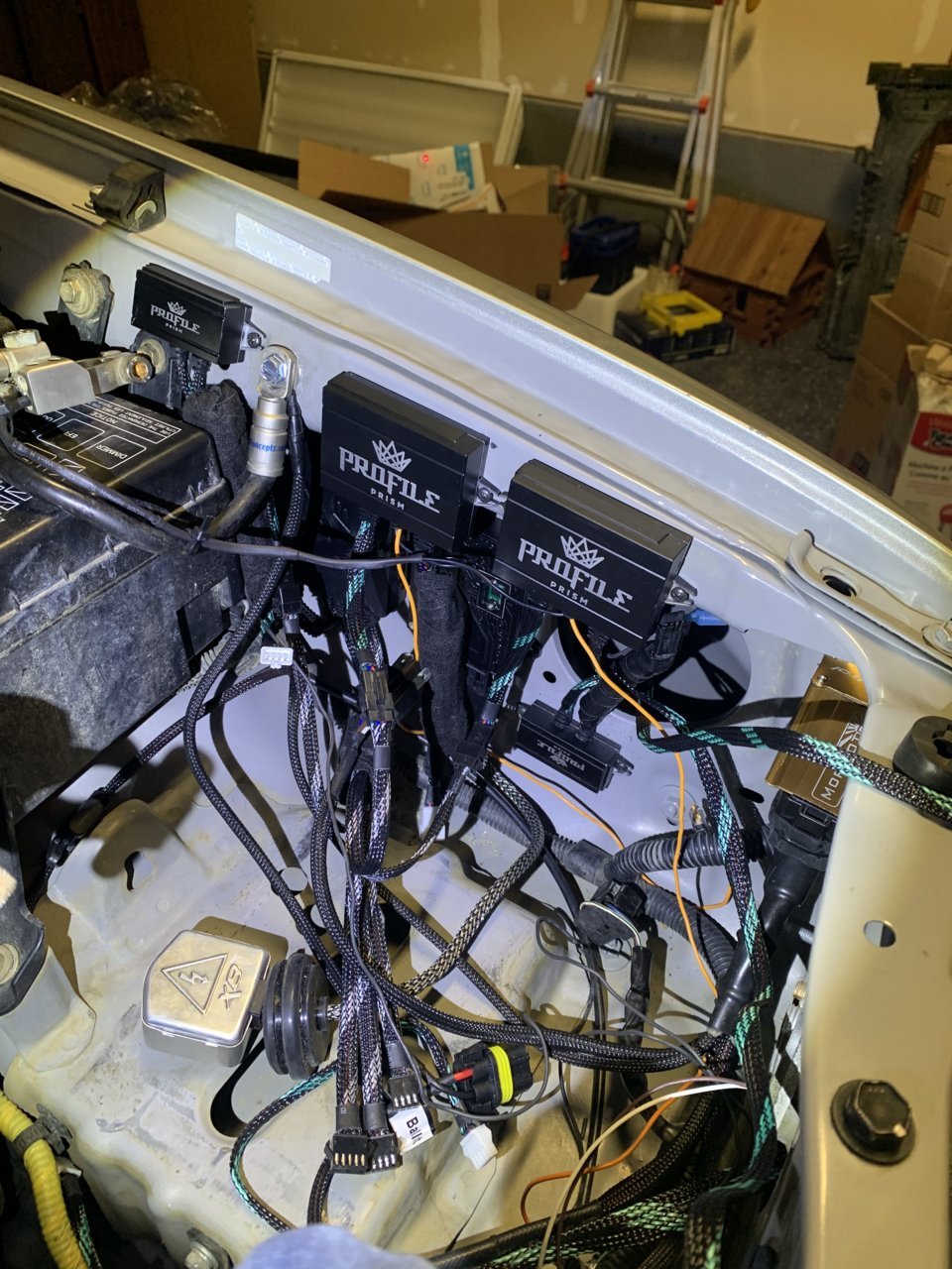

    Housings complete
    Back to wiring

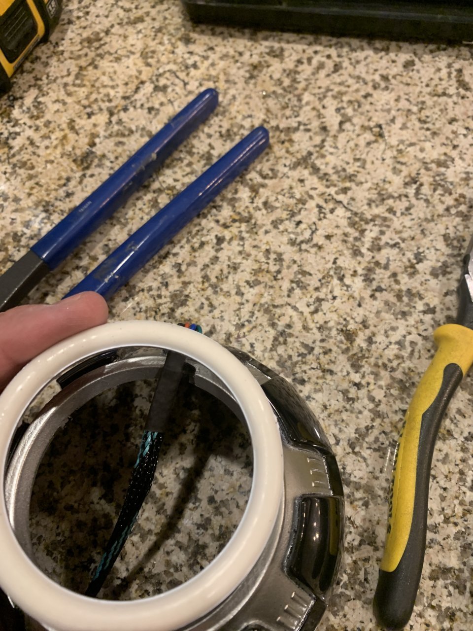

    Here are my mounting positions for
    2 Demon Eye Drivers
    2 Halo Drivers

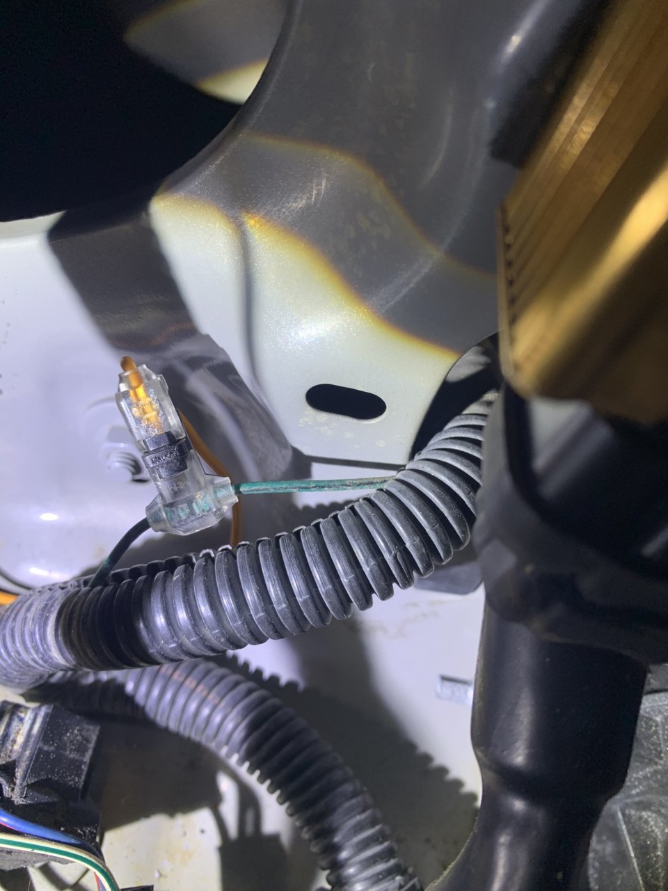

    Driver side blinker positive wire is green with a black stripe
    Connect to Halo orange switchback wire
    Passenger side blinker Positive wire is green with a yellow stripe, you can intercept it in the wire loom in front of the battery behind the drivers side headlight (there are quite a few wires to dig through)
