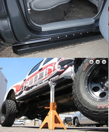

    Been looking for a low profile setup and I came across these body mount sliders. In theory this seems like a great design. They look great too. I've never been a fan of the pinch weld on the 3rd gen Tacomas...this would be a great way to cover them up and add some extra protection.
    http://www.randyellisdesign.com/ToyotaTacomaRockSlidersBodyArmorGen2
    Would be great to hear from anyone who has them installed? Thoughts?

    I guess they are ok if you like the sliders look. Real sliders don't attach to the body.
    I like how they show the truck on a jack lifted from the "sliders".

    Be careful with the jack and forklift videos. Steel is strong when moved slowly but has a tendency to flex and bend under force.
    You dont plan on doing any hard wheeling so should be ok but be careful that a substantial hit can push that into the body and cause damage that will be a PITA so fix.
    There marketing pitch is all wrong too.
    " If your tube sliders come out from the frame and cross the body in a few spots, the slider will flex up and dent the body where the tubes cross it. Either way you will loose at least 3" of ground clearance, you will loose less than 1/4" with our Rockers."
    This is incorrect, I did not lose 3" of ground clearance nor will they flex and hit the body, in fact their are videos on youtube showing the frame failing before the slider bends and hits the body.

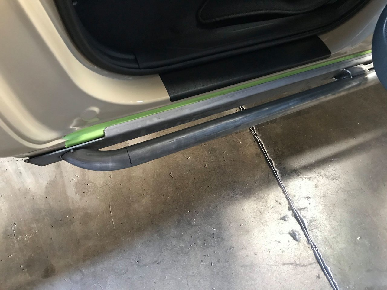

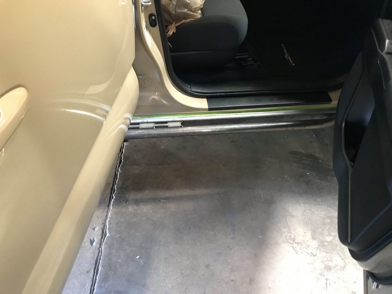

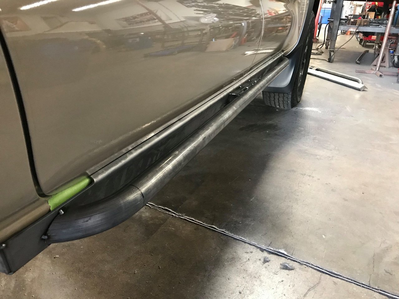

    I'll post pics after I pick it up. I took a tour of their shop on Saturday. He's got a great setup going and all his products look extremely well made.
