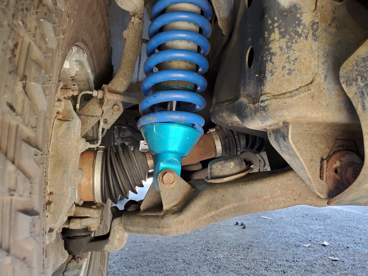

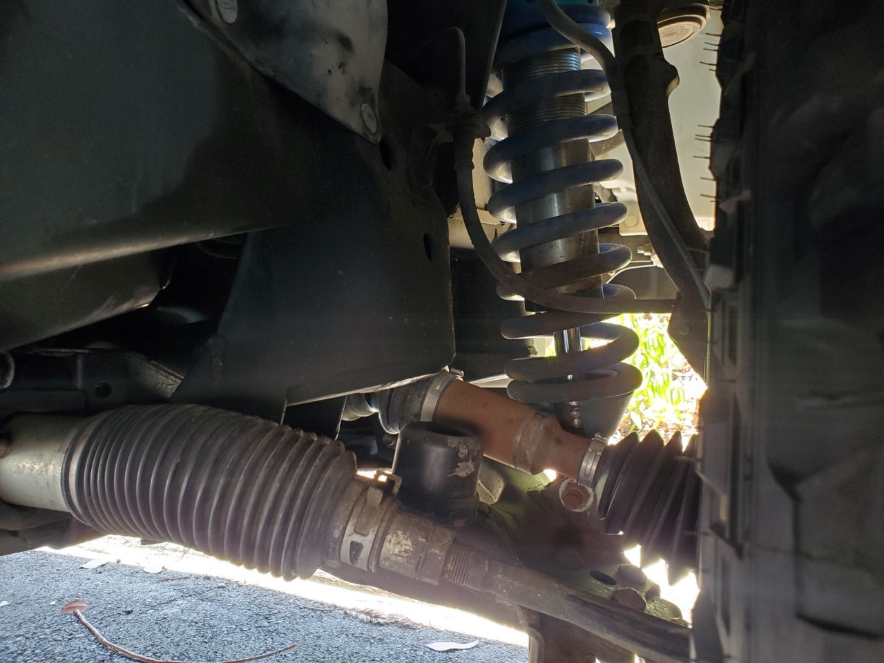

    Boots ripped, but due to the design, they do not/have not leaked.
    I posted an update in this very thread, and posting now is pretty much another update.
    Just went out and took pics a few minutes ago; I'll post them up in a bit.

    So, just to give you an idea of my driving;
    320 miles once a week, as I go out of town to my soon-to-be city of residence.
    On top of that, any miles I put on to run errands.
    Then, going to and from work.
    I put an average of 13-1400 miles on my 4Runner per month.
    You can see that there's no grease or anything anywhere (aside from the usual dirt/grime from the roads).
    I've taken my vehicle on light to moderate trails often, and knowing I've got 3 OEM spare cv axles, I don't care if I push these things.
    No weird noise, nothing.

    Thanks for the photos... It's a little disheartening to know the boots tear- I was really hoping that these CV's would be some sort of unicorn as they seemed to have so many other advantages to them. How many miles do you guess were on them before the boots tore / do you think it's fairly consistent to what you've experienced out of the poem reman/non-extended replacements?

    Ripped around April/May?
    I'd say I had a good 5k miles on them or more before they ripped, and another 3k miles on them since.
    If you have OEM cv axles, why not just get high angle boots for them?

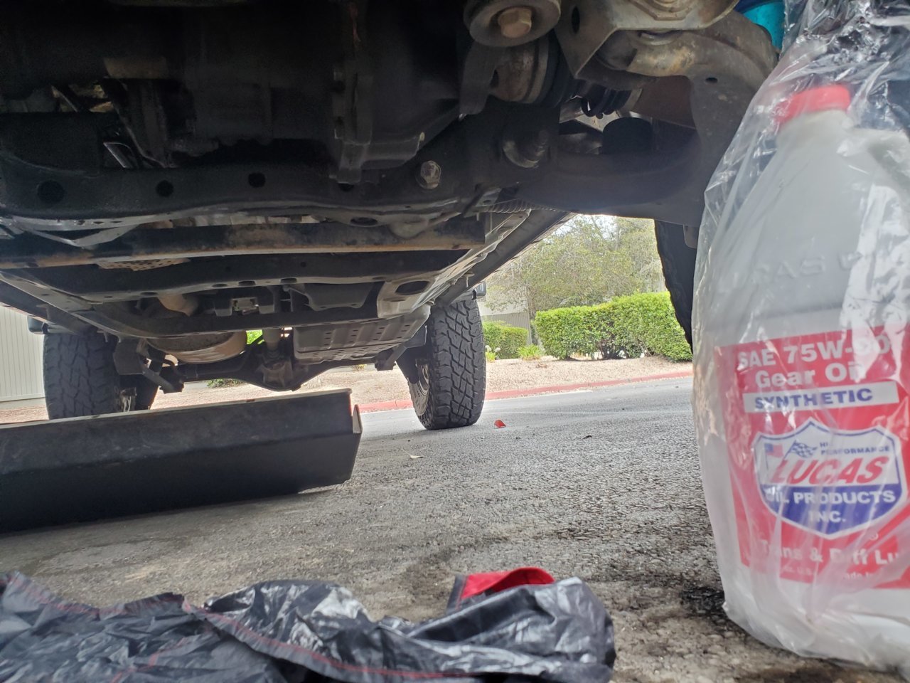

    Bumping this thread back up for; those who have posted and watched, those who have only read, and those new to checking these out.
    I've run well over +12k miles on these and have to say, I've really put them through the paces as mentioned above.
    One thing I've been doing in particular is, I've been going 4L and really hitting climbs (plenty of you know what I mean) and I am not afraid of the skinny pedal -
    I do so because 1. these CV axles have a lifetime warranty and 2. I have 3 OEM CV axles on standby.
    With that being said, I finally had to pull one as my CV axle seal was leaking more than usual. Here's me topping it off because I didn't want to risk driving with low fluid -
