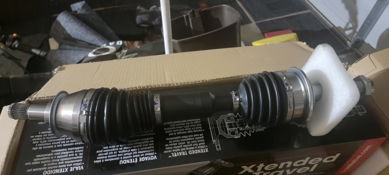

    Reminding the FedEx/UPS guys why they hate me. The shafts came wuock from rock auto. The 2 together were the price of 1 from the box store.

    Curious if they use the same 41mm size nut.

    I'll try and measure it out tomorrow.

    Did anyone catch these are fixed CV’s without a plunge joint. That’s why they can get more angle.
    SXS world had tried things like this and failed. They produce way too much heat. That’s why almost 100% of SXS’s have fixed CV’s and 1pc shafts.
    A friend designs 4x4 stuff for Porsche and is doing prototype Ultra 4 stuff. I’ll see what he thinks of these.
