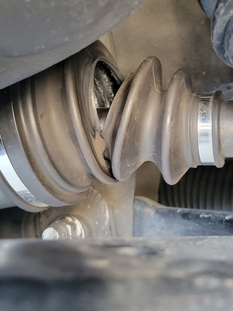

    I had a question about these cv axles I currently have a 3" icon lift I've been going through cv axles like no other I keep getting torn inner cv boots so if you have these on is it wise to remove the diff drop kit and bring the diff back up or do I keep the diff drop on when putting the extended travel cv axles on?

    Diff drops are useless.
    Easiest thing to do is lower your lift; you have an IFS truck and 3" is too much.
