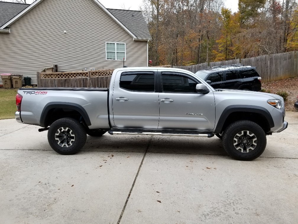

    As mentioned above, no lift required for 265's.

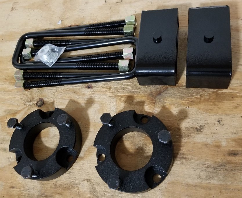

    2" lift front and rear worked with my 285's

    Just generic found on Amazon.
    Dont tell anyone if you use spacers. You'll be shunned from the community and ridiculed at every opportunity. :crapstorm:

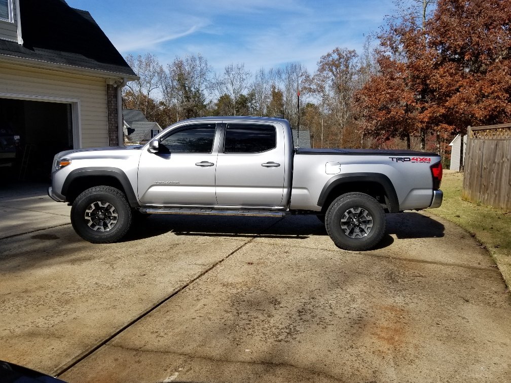

    My 285 Coopers are 32.6" and dont touch anything.
    At full hard lock they just barely touch the rear of the upper A arms. Not even enough to give a shit about.

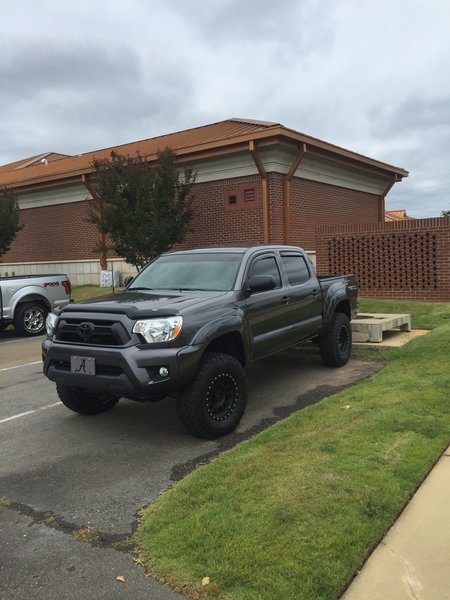

    This is my 2015 with a 3 inch lift and 265s. I didn’t think it looked bad. I was scared of 285s then too. But I also wanna keep my CV angles good without having to do a diff drop on this one.

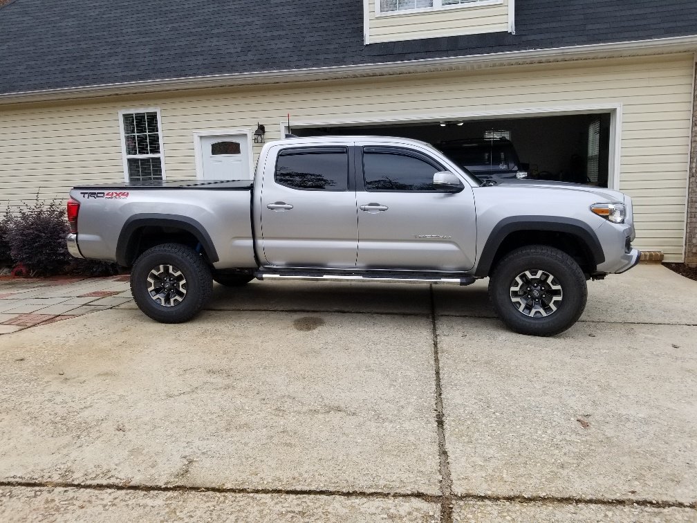

    2" lift on the factory 265's
