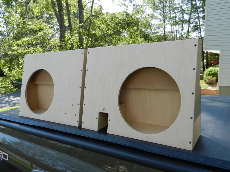

    After over a year of wanting to, and initially going with 2 Pioneer shallow-mount 12" subwoofers, I finally pulled the trigger and had Mr. Marv build me a dual 13tw-5 enclosure.
    First and foremost: Marv's build quality is excellent. I actually considered staining it until Marv stated that the birch does not stain well. I thought of carpeting it but went the truck bed liner approach figuring I can always carpet it later if I don't like the way it looks.

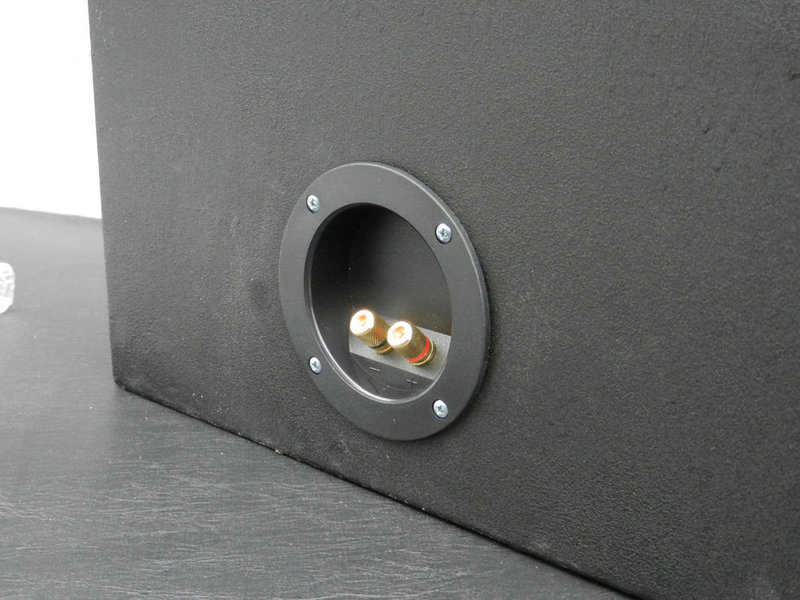

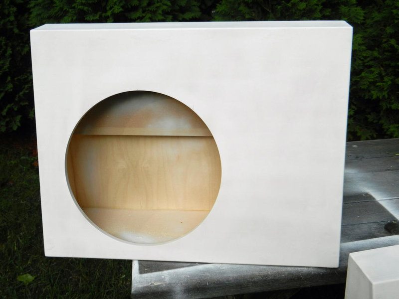

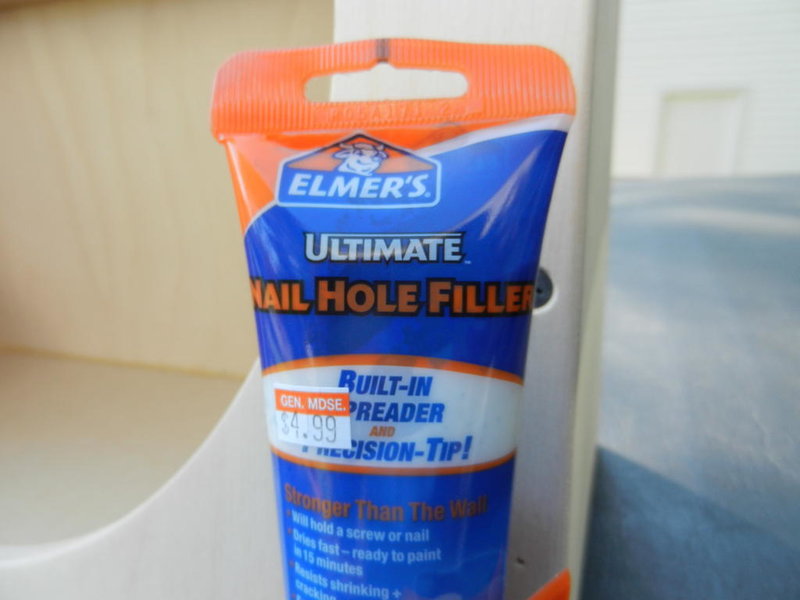

    With Marv's guidance I filled the screw holes, sanded, and then primed with a white oil-based primer. I went "off script" from Marv's instructions only by adding terminal cups to the rear of the enclosures.

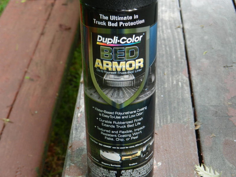

    Finally, I finished the enclosures with DupliColor Bed Armor coating. Which is kind of difficult to work with because if tends to spray unevenly and runs easily. I tried to use three light coats but still had some problems.

    Glad it worked out Scout and looks great! :)
