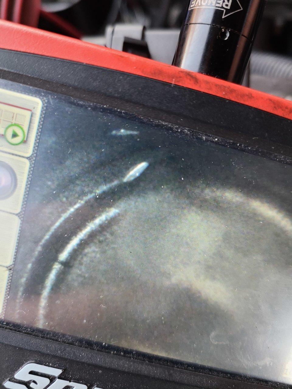

    The Cloyes timing kit has the big primary chain, the two smaller secondary chains, new guides, new tensioners, the exhaust gears (using URD ones) and the crank sprocket. The gears with the worn/missing teeth are the factory Toyota gears with 204k miles. Motor has been getting increasingly tappy at idle (loose tensioners?) and it actually jumped time dropping a motor to be built off at the machine shop. Borescope shows the piston barely hit the valves on the bank that jumped time seen by the small silver spot on what's otherwise a dark piston at the top. How it ran for as long as it did driving the way I do I can only chalk up to luck or Toyota reliability. Don't know where the extra bits went or what the crank looks like but everything up top looks okay, tensioners move freely, chains don't bind, cam caps aren't scored or seized anywhere. Have an oil pressure gauge that reads 16psi hot idle which I believe to be normal so tensioners I think would have pressure. I don't rev the engine past 5700 but putting down 402HP to wheels and driving spiritedly wondering if the cams are working harder to open valves but if that's the case why others haven't seen this. Could be like was said new chains on already wearing gears.20221103_173356.jpg

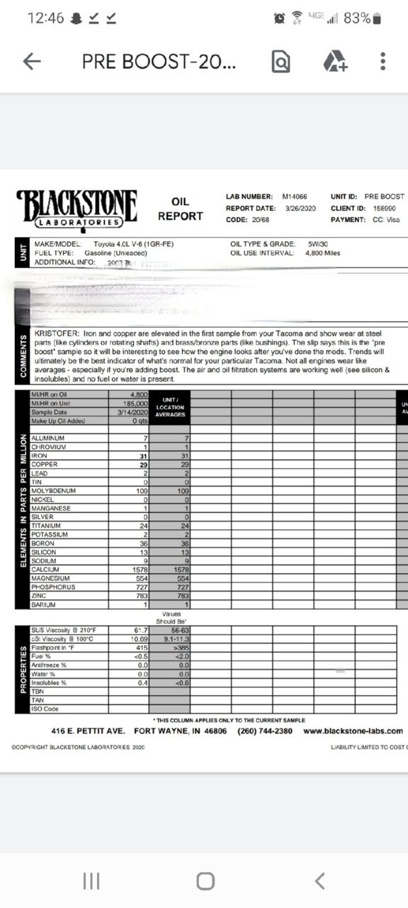

    Blackstone labs report from before I was boosted. Shows high copper and iron but I've seen worse reports. Could be a problem I missed during rebuild and the extra power just accelerated it. Screenshot_20221116-124607_Drive.jpg
