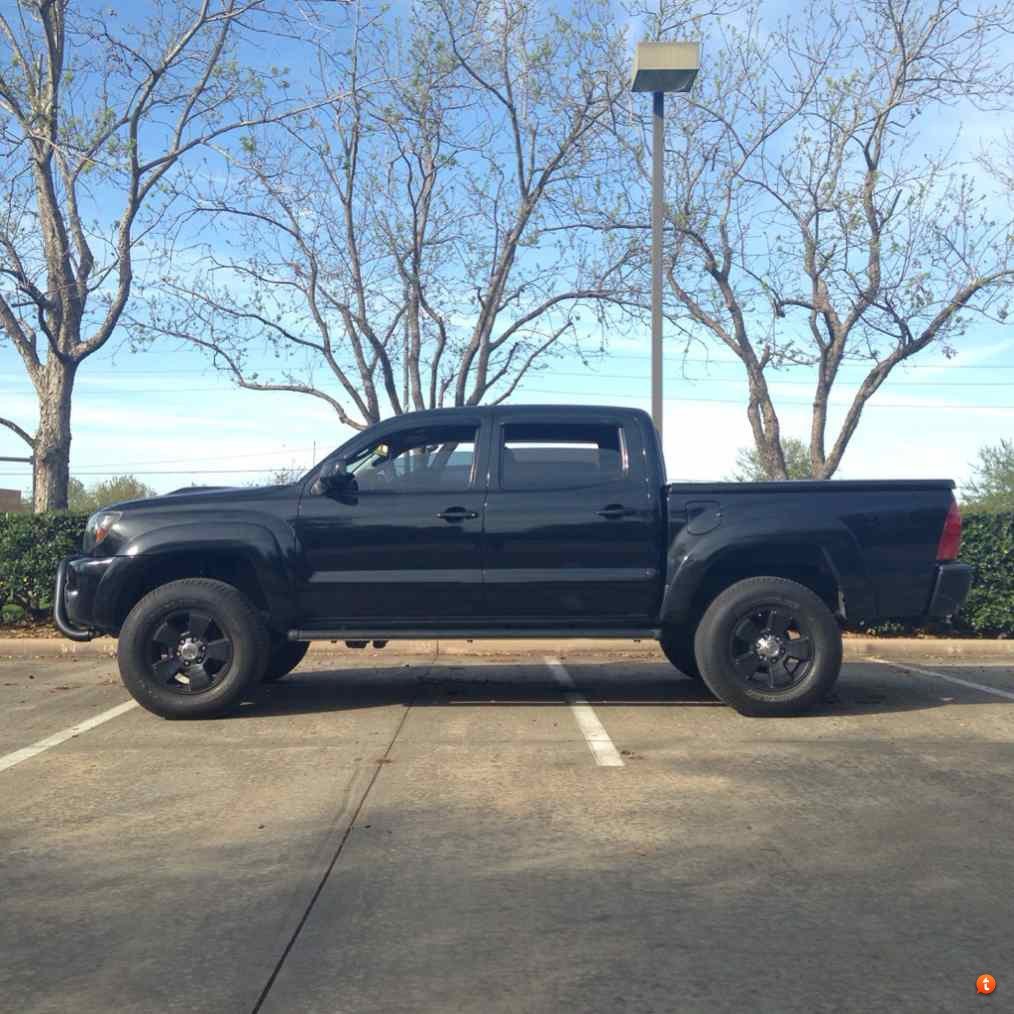

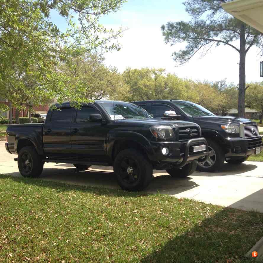

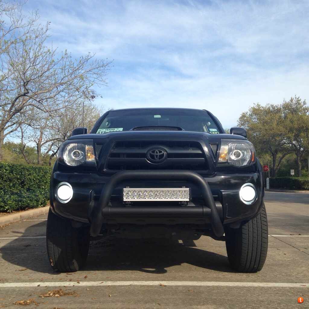

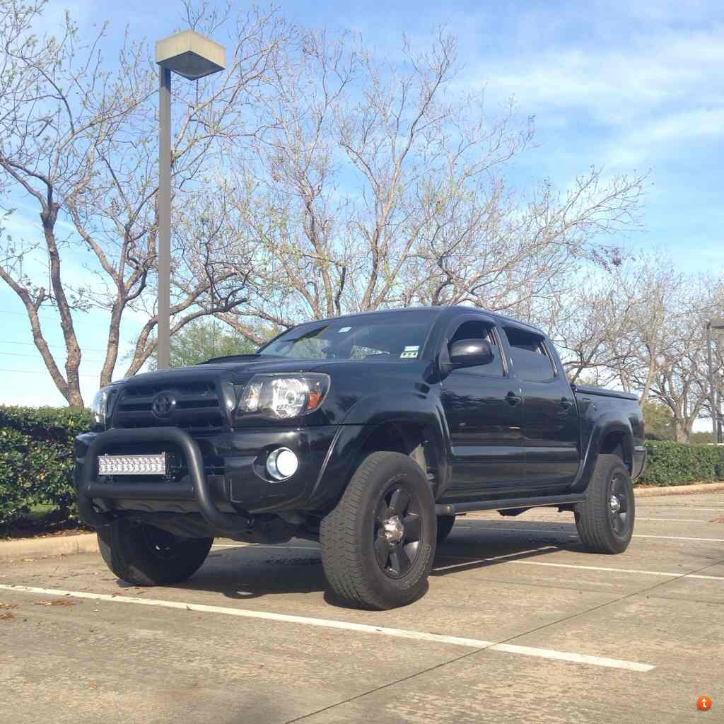

    Trd sport using stock coils and 5100s all around front set to 2.5 and 1.5 aal non tsb. Love the ride, way better than stock! Only problem now is that your just gonna wannt to go higher!!!

    Houston, Texas
    TRD Sport
    Took off mud flaps a while back for looks. Running 265/70/17 and never had rubbing problems with or without the 1.25 wheel spacers
    Its the westin bull bar without the skid plate painted with truck liner
    I bought the aal from toytec
    http://toyteclifts.3dcartstores.com...af-for-Tacoma-with-rear-TSB-springs_p_16.html

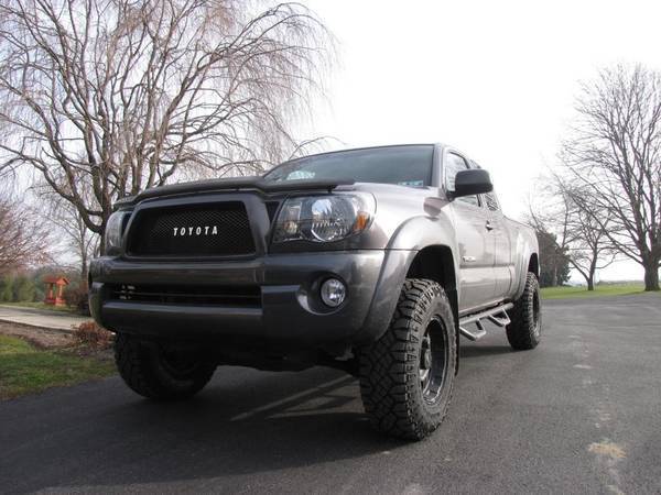

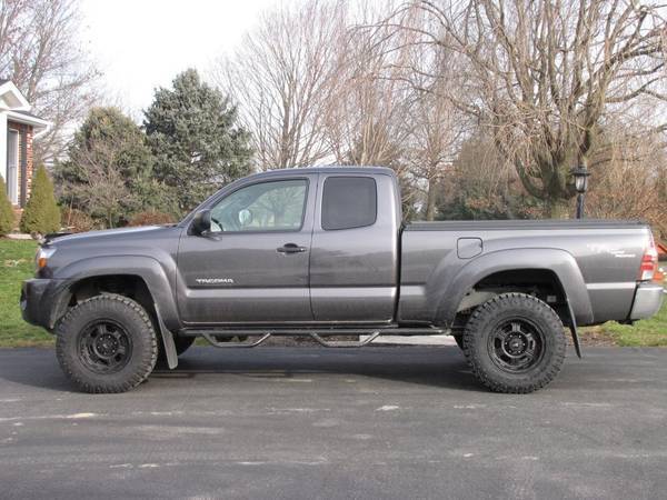

    This was my last truck at 2.5" in the front and 1.5" in the rear. It worked, but it was stiff. Plus I was in need of UCA's. Looked good though. My current truck I run it at 1.75" to avoid the UCA's.

    2.5" will be nose high with stock rear leafs.
    For the 5100 settings. Count your rear leaf springs. If you have 3 leafs (2+1), then .85" is the setting you want. If you have 4 leafs (3+1), then you want the 1.75" setting. Even at 1.75" it may look a little nose high depending on your truck.
    5100 settings are 0", .85", 1.75", and 2.5".
    You can also measure the height difference from front to rear and use the measurement for your 5100 setting. For example, if the rear is 1.5" higher, than you would go with the .85" setting.
