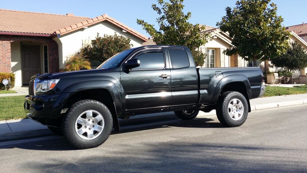

    2.5" front with 1" inch block in rear and TSB leaf with stock UCA's. No problem. It was a little stiff when I was running BFG All-Terrains but when I switched to a softer tire, BFG Rugged-Terrains, it rides nice.
