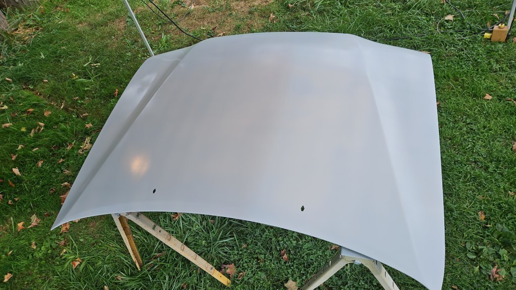

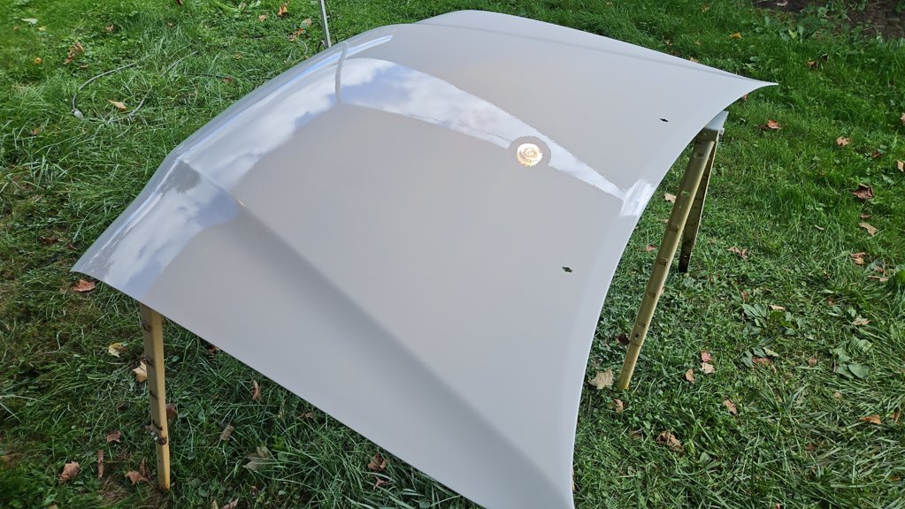

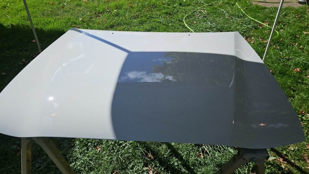

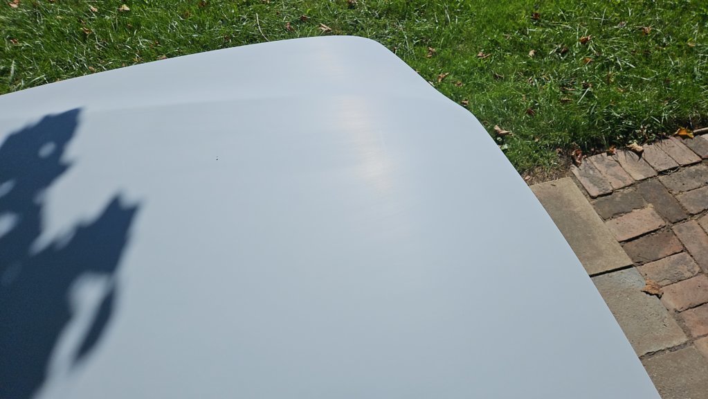

    Last fall was my very first attempt at shooting 2 part. Used a Hazard Fraught HVLP $30 el'cheep-o.
    Found a doner at pull-a-part and nabbed the hood, fenders, and pass door. Got supplies and paint from my local shop who supplies most of the body shops in the area.
    Did the initial stripping with a DA, but then only hand sanding.
    Rattle can etching primer, then 2 part polyester primer, 3 light coats. Hand sand 400 dry. 2 part Yoder white per code, 2 coats, 20 minutes between. Then 2 part clear, 2 coats. All shot outside, under a E-Z-Up fly. I was absoultely tickled with the results. 1 run in the clear and a few knats. (They love the clear.)
    IMG_20241006_140001_214.jpg IMG_20241007_142236_054.jpg IMG_20241007_152045_313.jpg IMG_20241007_153054_912.jpg IMG_20241008_154554_320.jpg

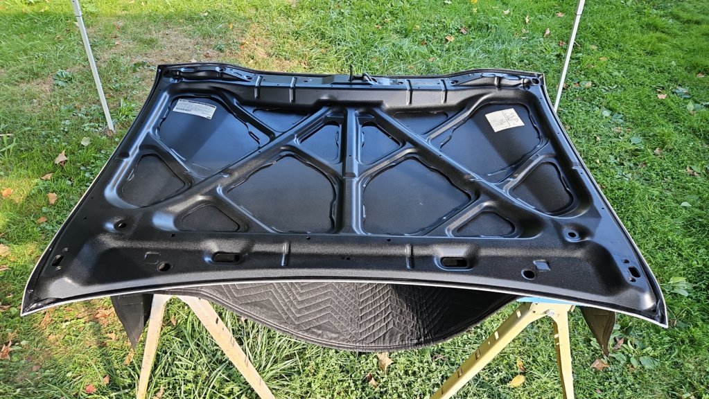

    The under side of the hood was done with Rustolum Pro Bed Liner rattle can. The Pro version can be painted over with color. Their other version can not.
