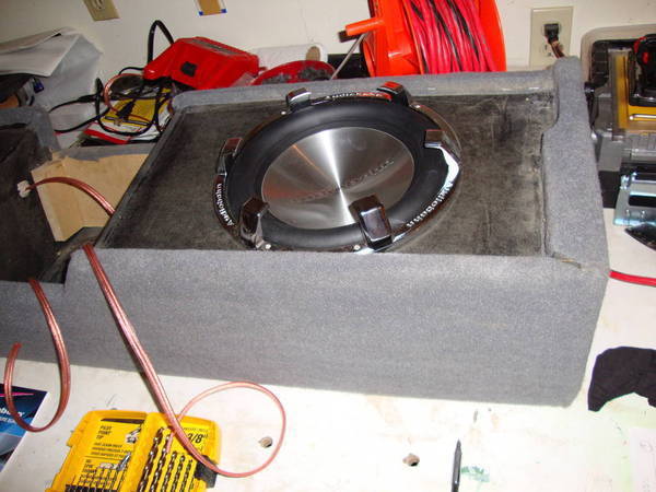

    Image Dynamics + Mr. Marv's craftsmanship = :cool:

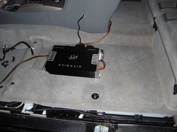

    I've got 2 downfiring Audiobahn ALUM10Q subs running at 800 watts RMS powered by a Hifonics HiFi1500 under the drivers seat. Pioneer 3-ways all the way around and a Pioneer DEH-P6000ub head unit.
    The box is .5 cu. ft. per sub which is perfect for the audiobahns. I still need to take the box out and get some more damplifier pro on the back wall to kill the rest of the rattle.

    Thats the cleanest set up ive seen for an access cab i think.

    I didn't want to have a box sitting on top of the seat, but I'm 6'-3" so I had to be able to get my seat all the way back. It took a few tries building cardboard mock ups, but the dogs love having a big platform to sit on back there. And, no one knows it's a sub box until they hear the system:cool:
