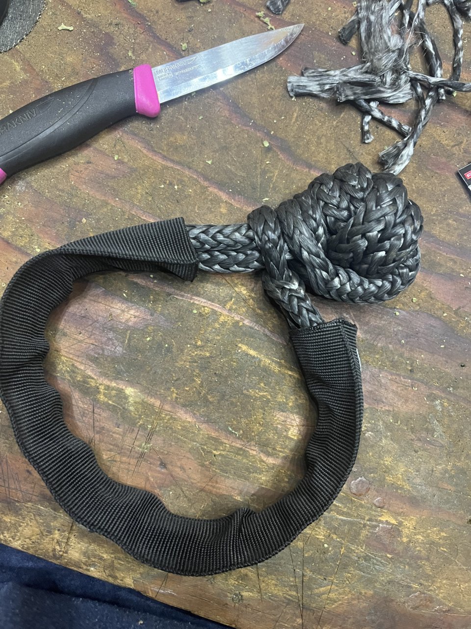

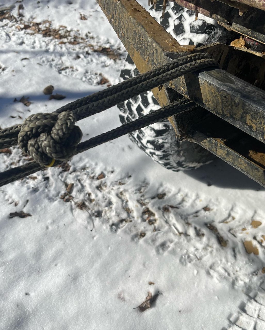

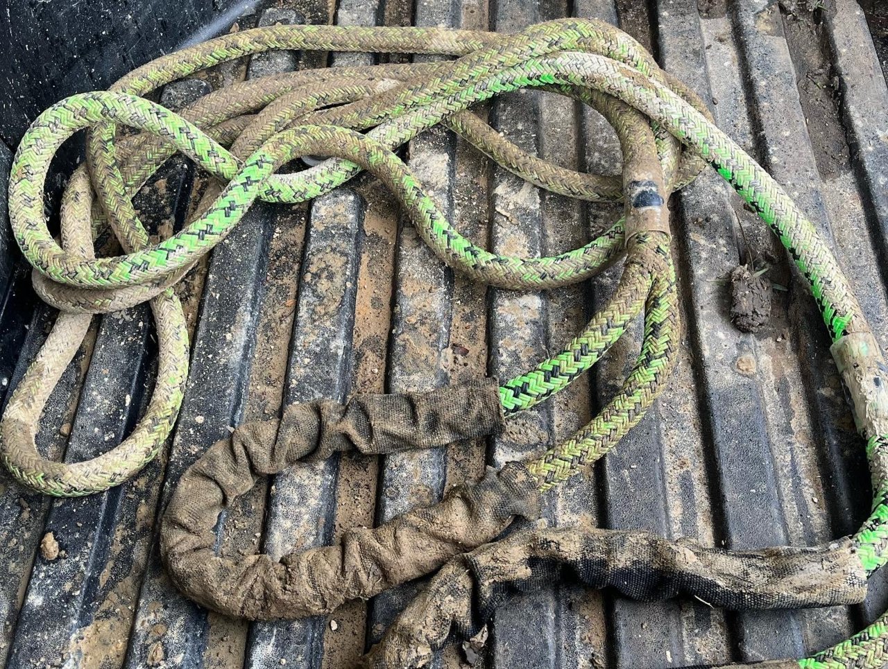

    I’m an arborist by trade and therefore pretty knowledgeable on rope and splicing and such.
    I’ve spliced up a couple kinetic recovery ropes and a bunch of soft shackles. Just wondering if anyone else has too?
    I’ve spliced myself 1”x20’ and a 5/8”x15’ kinetic recovery ropes with eyes in each end out of Atlantic braid double braid bull rope with two carriers per strand.
    I’ve also done a whole bunch of soft shackles out of 3/8” Samson Amsteel and I tie the stopper knot with an overhand as opposed to the button knot since it’s easier to tie, easier to check your work on and consistently tests 3% stronger.
    Anyone else splicing their own soft goods?

    Those look great! I was a deck hand for a while and I enjoyed splicing the ropes. I guess that’s why they always had me do all the repairs. We used Amsteel, I still use it for tons of stuff.
    I’ve set up quite a few camping hammocks with whoopie slings and shackles. The only large stuff I’ve made were a couple of shackles, same 3/8” Amsteel as you but I tend to favor a 2 or 3 bight Turks head stopper knot. I couldn’t tell you strength ratings on using that knot though, the guy I made them for still uses them, I think it’s been four or five years now.
