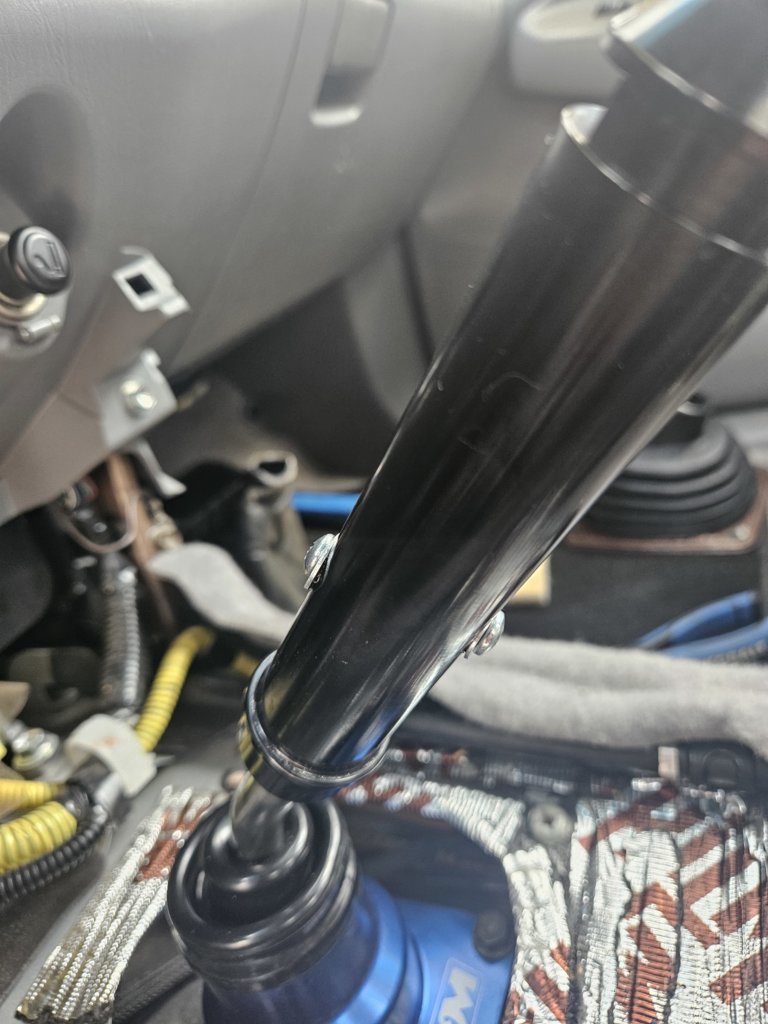

    I think I figured it out. There are 2 bolts with bushings inside, which bolts the upper shifter to the lower, and makes the 2-piece shifter design. One bolt backed completely out and is now missing. I'm going to attempt to repair it, ill let yall know if I'm successful.
    This photo is what it looks like. There should be a second bolt parallel with the single one.

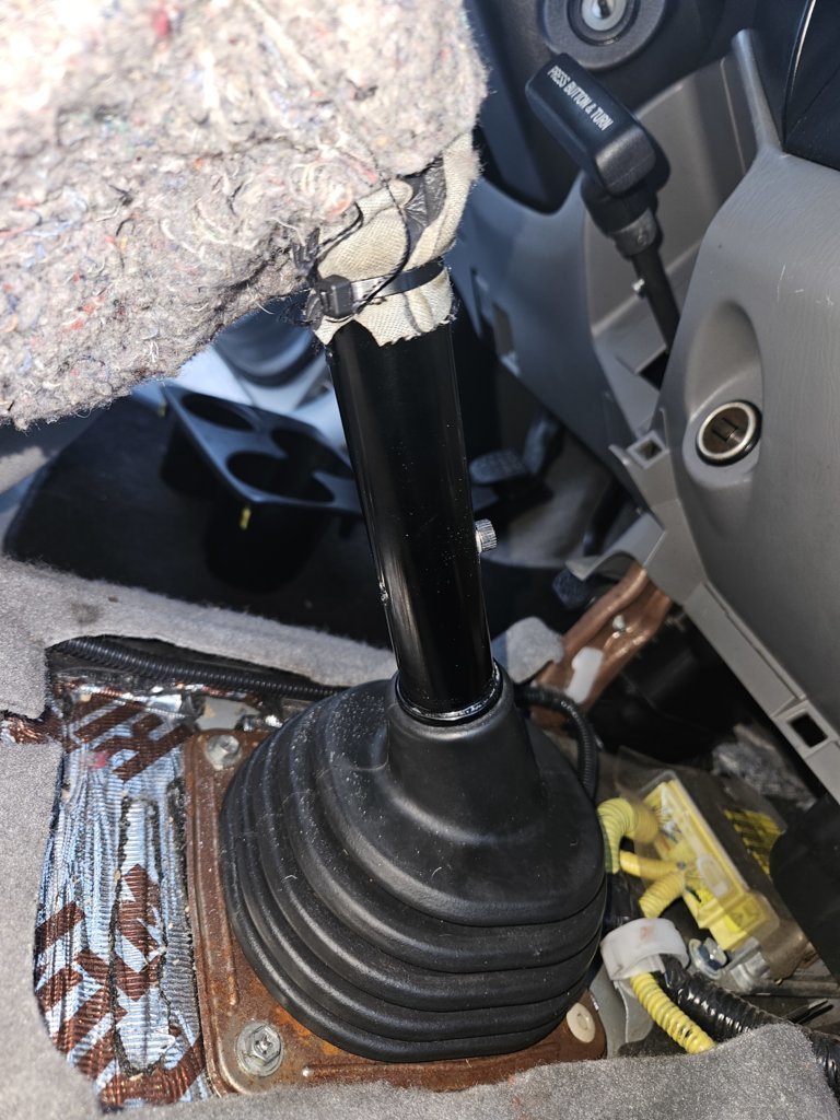

    I fixed it. I used 2 screws with washers and orange thread locker. Shifter feels as solid as a rock with short, crisp throws.20241216_132120.jpg
