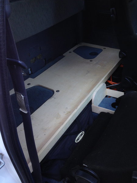

    IMG_2626.jpg My conversion: shelf with lip, cut-outs for access; 1/2" birch multi-ply, thru-bolted with stainless hardware. Cantilever design creates cubbies under front edge. I plan on painting it a dark color.

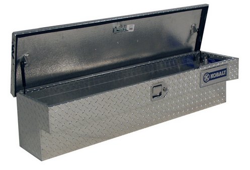

    I bought this:
    ...and put it behind my seats. It sits on the back bench. To keep it secured in place i have a ratchet strap wrapped around it that goes behind the fold down rear seats. It's honestly a perfect fit, it goes from wall to wall in the cab, it is a great height, and it's not so long that it gets in the way of the front seats.
