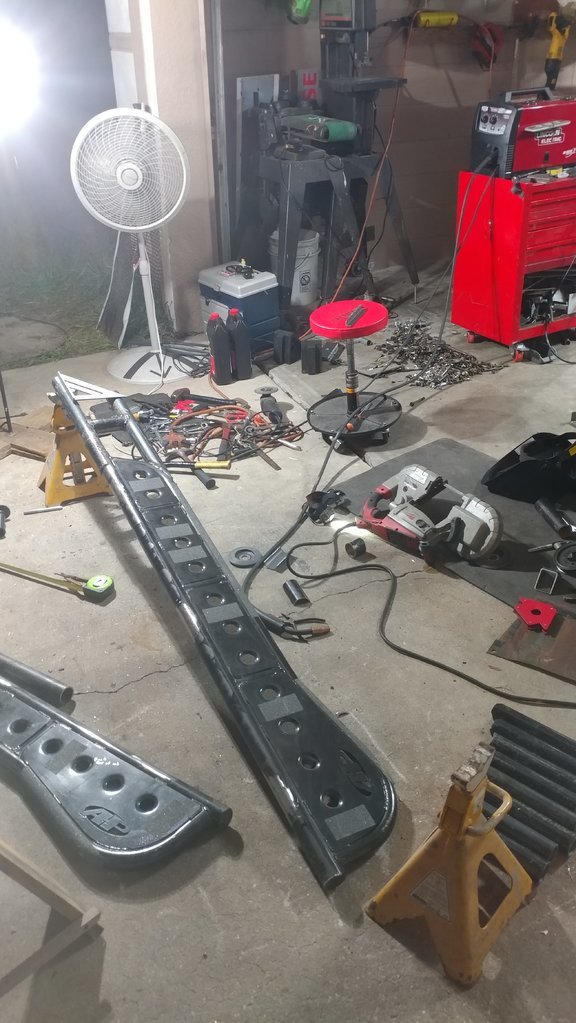

    Buy a squirter and go to town, you could teach a monkey to mig. I'm self taught, (with a union iron worker giving me tips on occasion) it's really easy, set up is a little more expensive but worth it for the convenience. Troll craigs or whatever for a used buzz box and a gas bottle, (just make sure it's still on date and not company owned) I have a Q bottle, it's big enough to last many jobs but small enough to transport solo unlike a K bottle. PPE you're best off getting from Amazon, I got some great gloves and a very decent hood for cheap on amazon. Wire rolls are cheaper there too.
    Just whatever you get make sure it's 240v (Dryer plug) otherwise you won't get much penetration and your duty cycle will be craptastic.
    Lincolon Pro Mig 180 from craigs $500
    Q-Bottle from craigs $200 (came full of 75/25)
    Ball bearing regulator amazon $40
    https://www.amazon.com/gp/aw/d/B00CS7OPM2/ref=oh_aui_i_d_old_o0_img?ie=UTF8&psc=1
    Hood from amazon $50
    https://www.amazon.com/gp/aw/d/B00BWAEYV8/ref=oh_aui_i_sh_in_o0_img?ie=UTF8&psc=1
    Being able to harness wall pixies to liquify steel: priceless.
