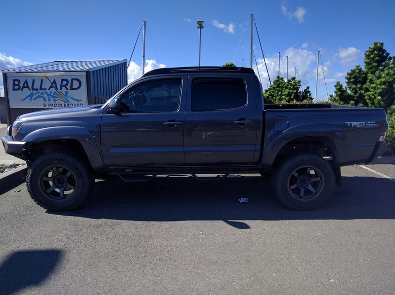

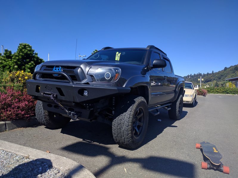

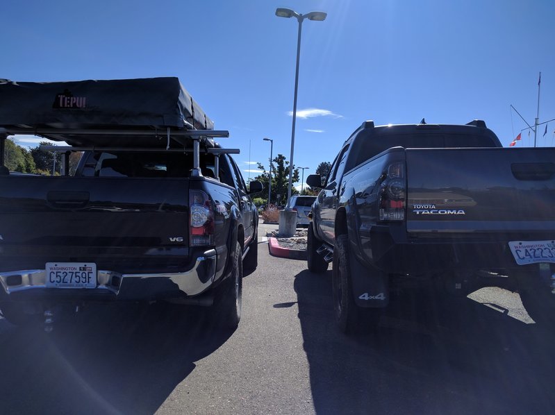

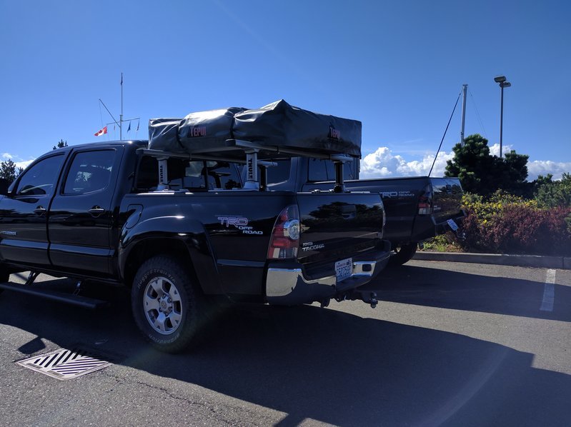

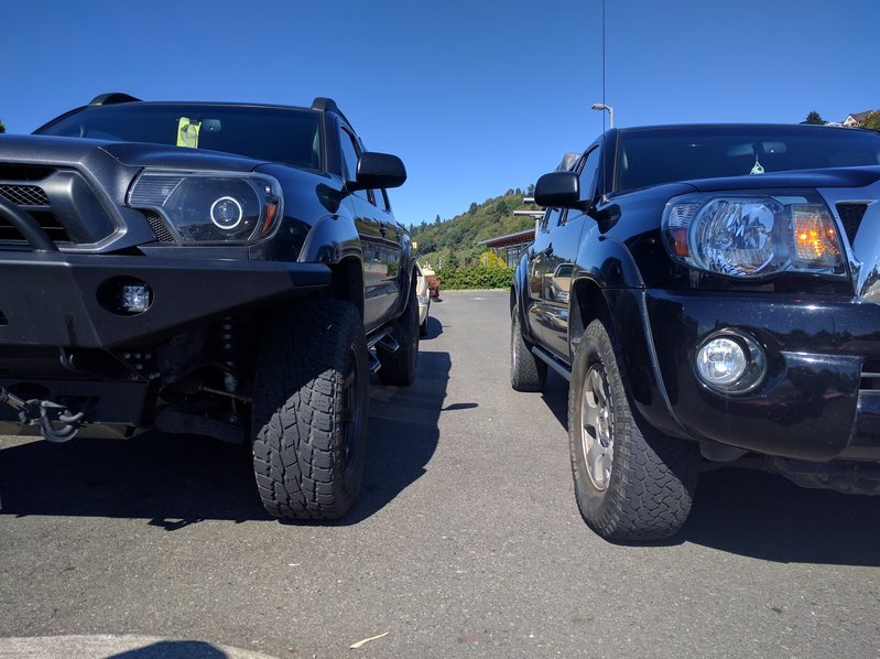

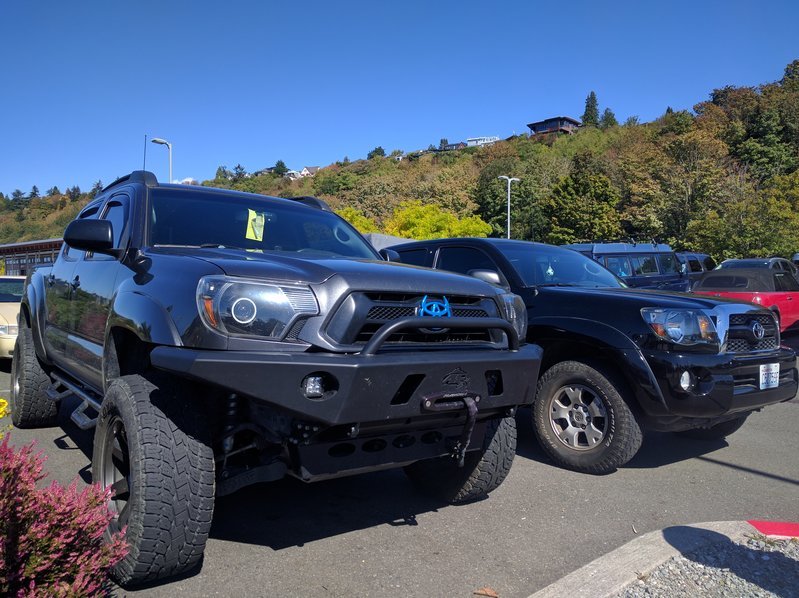

    I waited for him to show up but he never did.

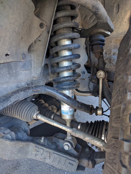

    I can't figure out his lift, I love the height and the whole truck, but his geometry seems pretty straight? But it's not a DB lift... and the back is almost 5" higher than my truck.
    Pics of said truck and comparison to mine (stock) below.
    Thanks.
    Truck1.jpg Truck2.jpg Truck3.jpg Truck4.jpg Truck5.jpg Truck6.jpg Truck7.jpg

    Looks like Bilstein 5100's up front and maybe a large leaf pack in the back, maybe OME Dakars or All Pro Expos

    Bilstein 5100 with an OME coil of some flavor. Light racing control arms.
    Can't say for the rear without pics, but you have to remember the height difference is coming from both the lift and tire size. So if he has 3" lift in the rear from dakars and those are 33's, he will be 4" taller than a stock Tacoma.

    Looks like a 3" lift to me, like @rngr said, you're getting lift both from suspension and also from the tires. From the side by side pic, it looks like his tires are a few sizes bigger than yours.

    Yeah I am on stock 265 or whatever, he is on 285/70/18.

    Those shocks look like the ones I'm running from the rcd 4.5 or 5 inch lift kit.

    It looks that high to me but it's pretty obviously not a drop bracket lift, right? I have more pictures that show it.

    Next to a stock truck a 3" lift with 33's looks huge. 4" makes a big difference like you saw.

    Also the shocks do indeed say RCD on them. First thing I noticed bc my original plan was to do the RCD 4.5 but I think I am slowly talking myself out of a DB lift.

    Those are definitely RCD 5100s, but I can't tell for sure if he's running the DB lift. Judging by the amount of lift he's getting and the angle of his axels, it's a good possibility that his skid plate is covering the RCD drop bracket.

    I think this pic proves otherwise doesn't it? This is where I'm getting confused. I should have included this pic in the first post.
