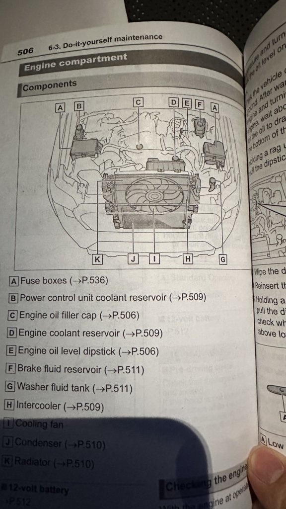

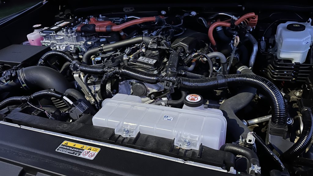

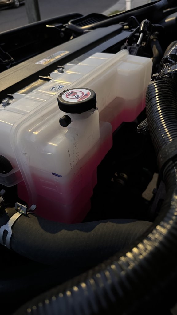

    So my hybrid truck is at 1260 miles on the odo and I’m full in the main coolant and also full in the reservoir with my trucks engine cold since 3 days ago.
