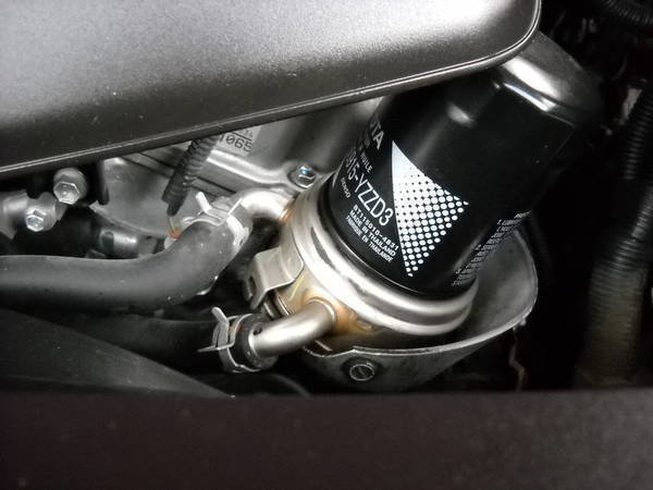

    If you have 1 of these, more than likely you have the factory tow package. Can with 2 hoses.
