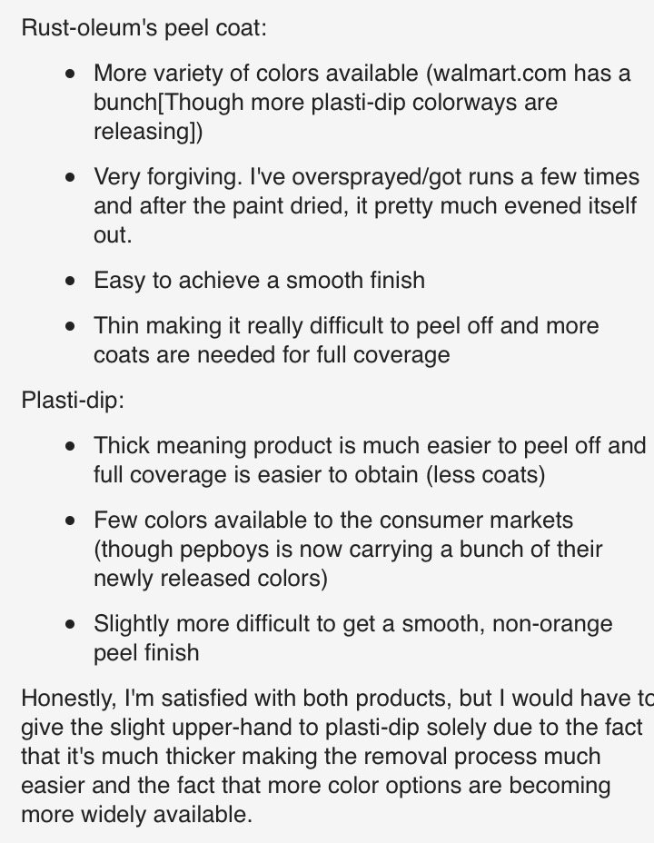

    Never used it, but I've used plastidip a quick google came up with this comparison

    I guess if you plan on peeling it off, you wouldn't go wrong with either plasti or this rust oleum peel. If you don't need to peel it up later but still like the texture, I just used both rust oleum standard under coating and rust oleum premium undercoating, I can 100% suggest the premium version, it drys nice and fast and does cut down on noise of things hitting the metal I sprayed it on. (aka noise deadening) I cannot suggest the standard version, it takes forever to dry and even "dry" it feels very sticky.

    Plastidip has 50 or so colors, I don't think rust has more than 5 or 6.

    plasti dip, because less material needed to give thick coats. Thick coats are needed to properly, and easily, remove. Trust me on that.
