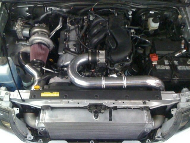

    GT3582R. TiAL SS Turbine housing. ~1.0X A/R. That sucker spooled ridiculously quickly. Around ~450 wtq at ~8psi. Auto with a valve body upgrade. Toon's old truck, and also the first truck to win a top 3 trophy at WEKFEST in California. Also had some pictures added to Garrett's web page.

    You may have the record for fastest spool ever, I mean holy shit 2-3rpms and your at full boost HOLY SHIT!!! In my wrx it was more like 3500rpms and I thought that was quick spooling.

    He knows something which we don't. :spy:

    4.0L is going to make a lot more exhaust to spin up that turbine than 2.2L. Throw in a ball bearing center section with a properly matched A/R on the hot side and you can build boost really quickly. Usually, you're going to sacrifice a bit of top end power to get that fast spool, but for a street application it's worth it.
